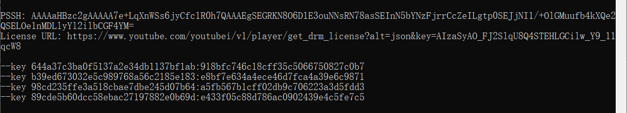

    As for an encrypted webm video, there are four keys:
    --key 644a37c3ba0f5137a2e34db1137bf1ab:918bfc746c18cff35c5066750827c0b7
    --key b39ed673032e5c989768a56c2185e183:e8bf7e634a4ece46d7fca4a39e6c9871
    --key 98cd235ffe3a518cbae7dbe245d07b64:a5fb567b1cff02db9c706223a3d5fdd3
    --key 89cde5b60dcc58ebac27197882e0b69d:e433f05c88d786ac0902439e4c5fe7c5
    The keys are right.

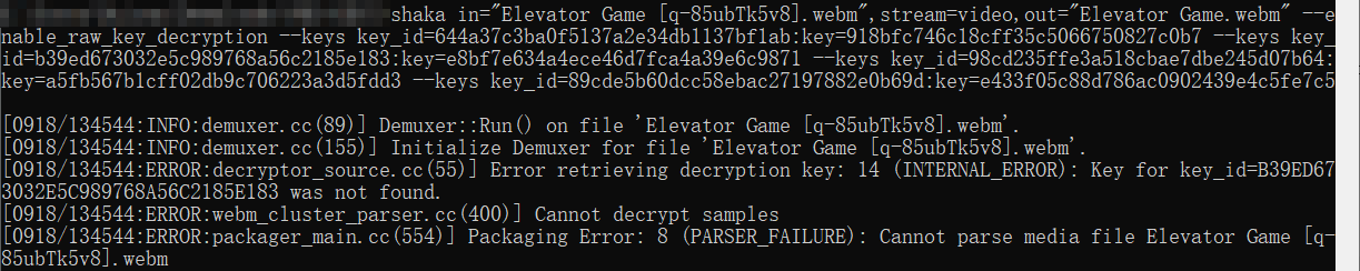

    But when I was using shaka-packager and trying to decrypt it, an error occurred:
    Key for key_id=B39ED673032E5C989768A56C2185E183 was not found.
    The command I used was as below:
    shaka in="Elevator Game [q-85ubTk5v8].webm",stream=video,out="Elevator Game.webm" --enable_raw_key_decryption --keys key_id=644a37c3ba0f5137a2e34db1137bf1ab:key=918bfc746c18cff35c5066750827c0b7 --keys key_id=b39ed673032e5c989768a56c2185e183:key=e8bf7e634a4ece46d7fca4a39e6c9871 --keys key_id=98cd235ffe3a518cbae7dbe245d07b64:key=a5fb567b1cff02db9c706223a3d5fdd3 --keys key_id=89cde5b60dcc58ebac27197882e0b69d:key=e433f05c88d786ac0902439e4c5fe7c5
    Explanation:
    • in="<video name>",stream=video,out="<output name>"
    to tell the program the information about the file I was inputting.
    • --enable_raw_key_decryption
    to enable decryption with raw key (keys provided in command line).
    • --keys key_id=<KEY_ID>:key=<KEY>
    to enter the keys to decrypt the viceo.
    So would anyone be willing to help me please?

  2. I don't use shaka, but you might try not using a special character in the filename? []
    ..[q-85ubTk5v8]..
    because I don't think it's the kid/key that gets confuse shaka
  3. --keys key_id=<KEY_ID>:key=<KEY>
    looks a bit strange to me, but I am quite sure you checked this already.
    Did you try to use only one of the keys (the first)?

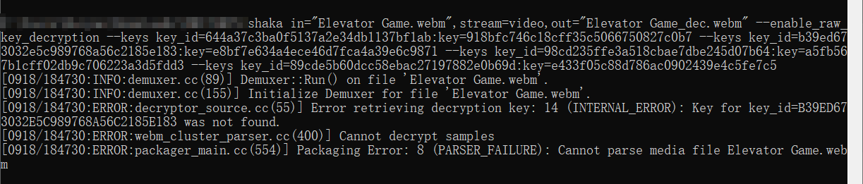

  4. Banned
    Apr 2022
    Hong Kong
    @sk8ordi3
    [Attachment 73884 - Click to enlarge]
    I have already renamed the video and deleted the special char:
    [Attachment 73885 - Click to enlarge]

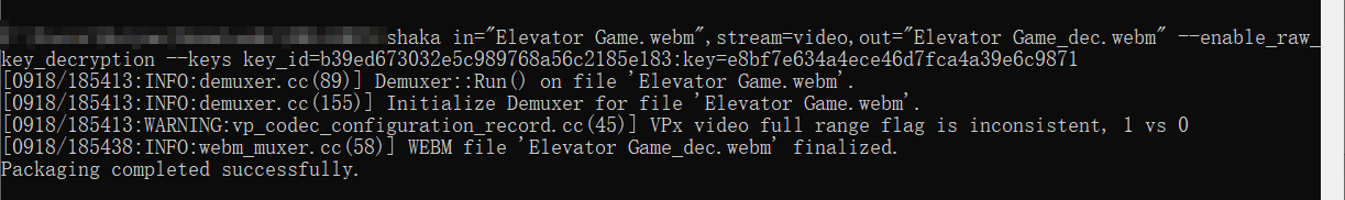

    Thanks for your reply! I may have found the solution although I still cannot explain it.
    Based on the license response, I found that the second set of keys controls the HD, while other three control "UHD1", "SD" and "AUDIO"
    So I just tried to input only the second key, and it worked.
    [Attachment 73886 - Click to enlarge]
    Appendix:
    	"id":"s57WcwMuXJiXaKVsIYXhgw==",
    	"iv":"ZoQIOP/zCOfhjcWz/vWJHA==",
    	"type":"CONTENT",
    	"level":"SW_SECURE_DECODE",
    	"requestedProtection":{
    		"hdcp":"HDCP_V1",
    		"cgmsFlags":"COPY_NEVER"
    	"keyControl":{
    		"keyControlBlock":"a2MxNgAnL3nUMsMPhAAACA=="
    	"trackLabel":"HD"

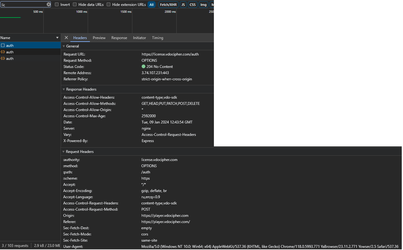

    Guys, I continued to figure it out further. What happened to find out:
    I got 1 key from the logger
    PHP Code:
    MediaKeySession keystatuseschange Event instance {}
    Associated value: {
    expirationnull,
    keyStatusesMediaKeyStatusMap instance {
    3003336c78e85a91ae49ee1b1db2cc0f"usable",
    5edb70aeed6b58b6956b753e6218aace"usable",
    84bc499ddb955566adf514df8ed36e61"usable",
    a0ad3b348873536c91d479a4cac050ca"usable",
    So the one that was given to me in the request of the drm site is correct in 1 line of the key
    but for some reason there are 4 keys here, but the site gives out 5 keys

    I get the answer: unable to parse license - check protobufs
    and if you take it from mpd PSSH
    PHP Code:
    AAAAUnBzc2gAAAAA7e+LqXnWSs6jyCfc1R0h7QAAADIiKnZkb2NpcGhlcjplMmQ3MjdkMmQ2Mzk0Njc1OTk5ODdkYjc0NDM4NTBkOUjj3JWbBg==
    I tried using this license page, but it didn't always work, I used python to request WKS-KEYS
    License URL: https://license.vdocipher.com/auth
    Only the next page worked
    https://cwip-shaka-proxy.appspot.com/no_auth
    I received the same key data from the request both on the DRM website and via WKS-KEYS

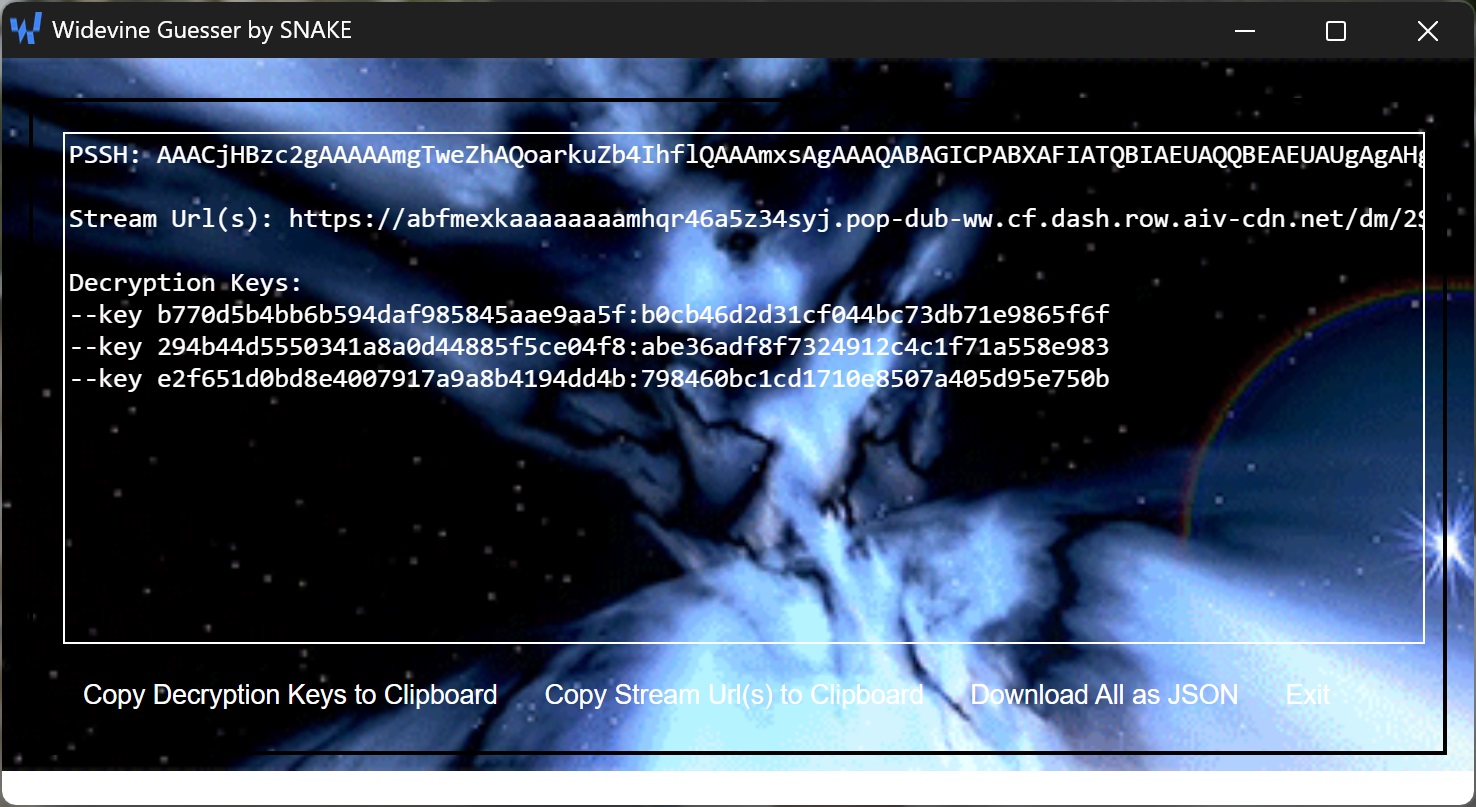

    Dec 2021
    england
    @L4D2
    well, you better find extension like this below
    [Attachment 76195 - Click to enlarge]
    it been leak somewhere on website
    hit play then it showing up like pic, without pssh, license URL and header or any script like l3.py
    i have got them 2 of them
  16. Originally Posted by iamghost View Post
    @L4D2
    Didn't know this was still working.
