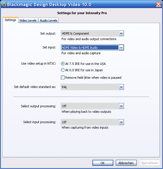

    So i bought that card and is there any way to check if that card is working properly without hdmi splitter that will remove HDCP? My laptop detects that after plugging hdmi the second screen has been connected but there's nothing in preview of input signal on intensity. Sony recorder is obviously not working as well.

    HDMI input format setting of Intensity Pro must match actual HDMI video format, otherwise there will be just a black screen. There is no auto detect.
