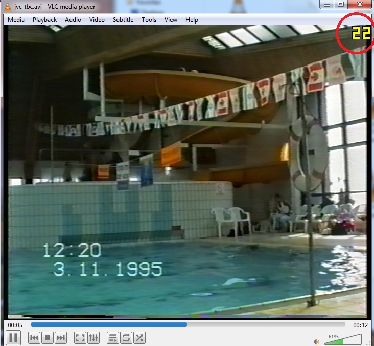

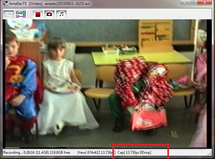

  6. Just to clarify the problem again.
    With TBC *OFF* - I still get continuous 25 fps 0 frame drops.
    With TBC *ON* - I get weird slow motion video. This is expressed in FPS drops (not frames) which you can see in this photo of Amarec (fps goes down to 13.73-24 for a second).
    Playing the file on VLC along with "FRAPS" - a program that shows the FPS on real time.
    I can see it goes down to 22fps on 00:05 seconds on the video - and go up again to 25fps on 00:08.
    With TBC off I don't experience those issues.
    Should I just not use the TBC if I don't see any major differences in quality?

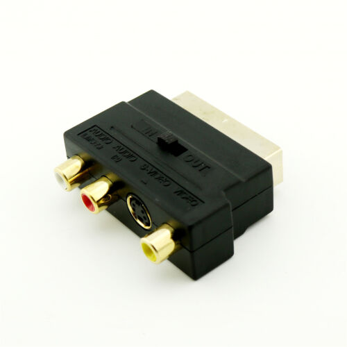

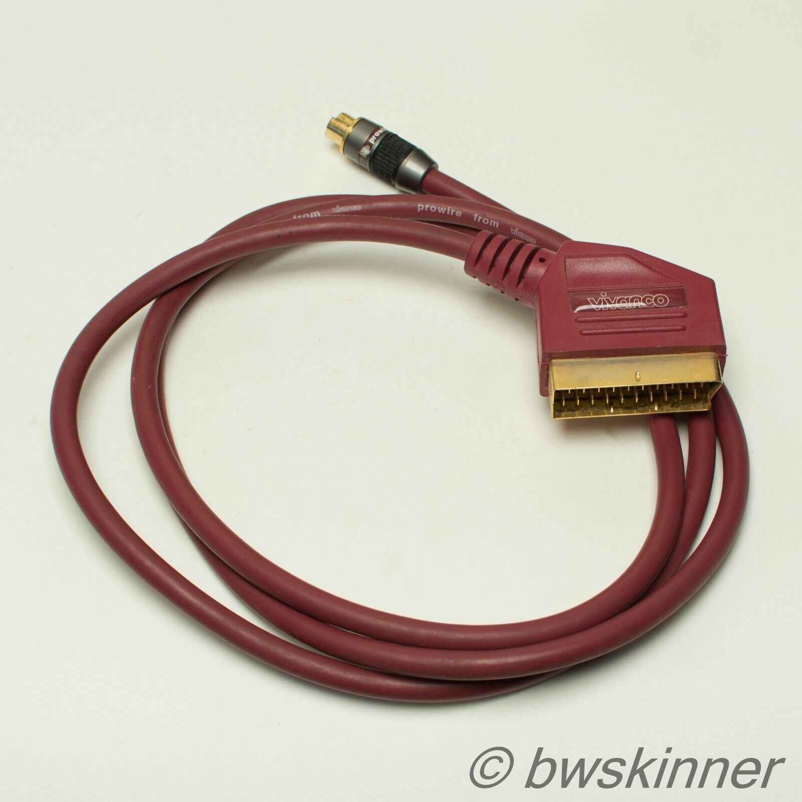

    By reading this thread:
    https://forum.videohelp.com/threads/403635-Panasonic-DVD-recorder-passthrough-settings...15-DMR-ES25%29
    Can I connect only the S-video to S-video as a passthru?
    or do I need to use S-video to scart adapter like this?
    Because the thread says to use scart output on the unit
    Or a cable like this should be also good

  9. Capturing Memories dellsam34's Avatar
    Jan 2016
    I don't think it matters if a good cable is used, just make sure the right port is selected in the menu. The trouble with SCART is that some cheap cables have unused pins and the device defaults back to composite automatically without indicating so, That's why it is suggested to use S-Video whenever possible.

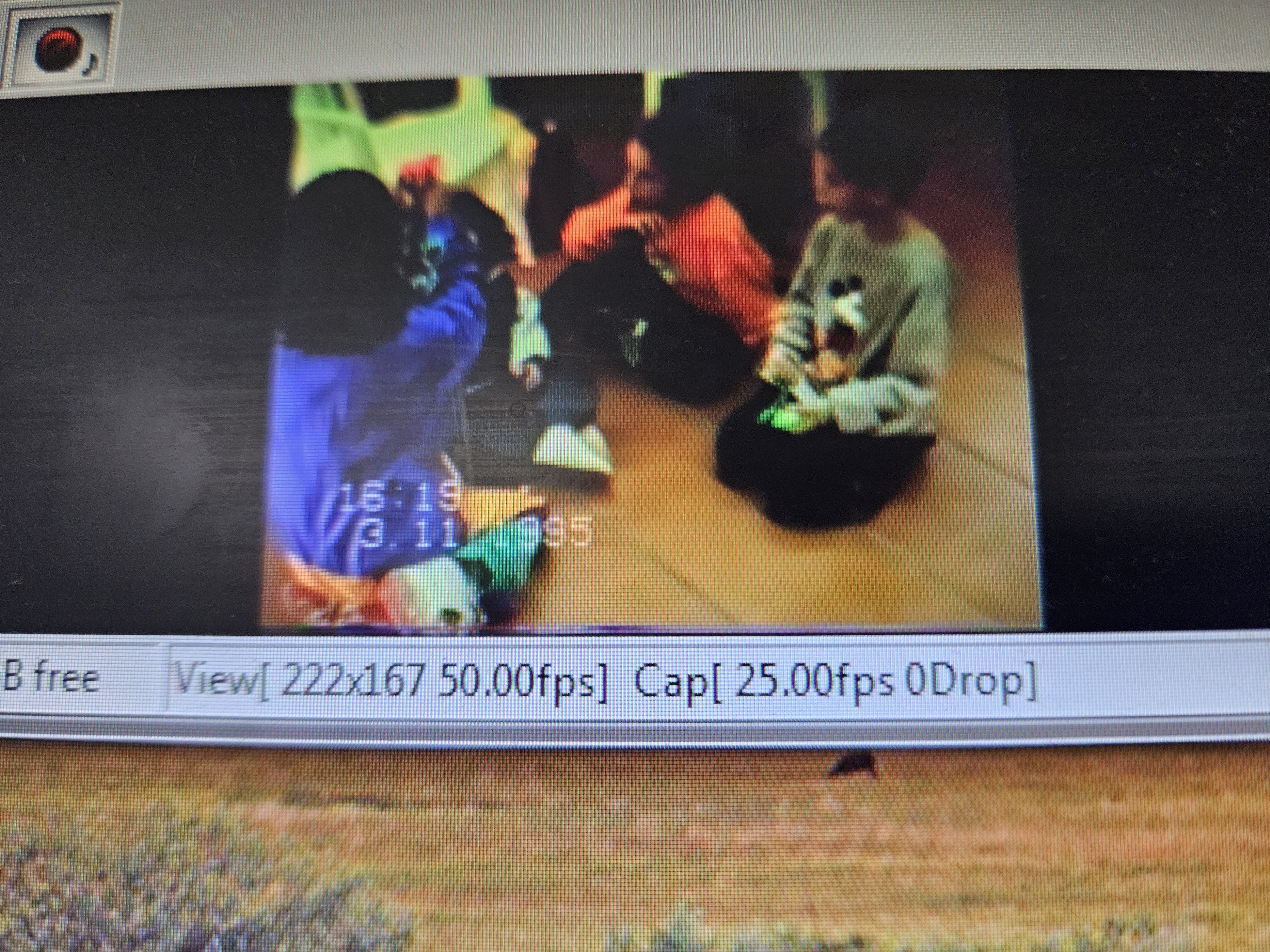

  10. I've got the Panasonic ES10 connected and JVC TBC off.
    Not a single drop right now and no freeze anymore!
