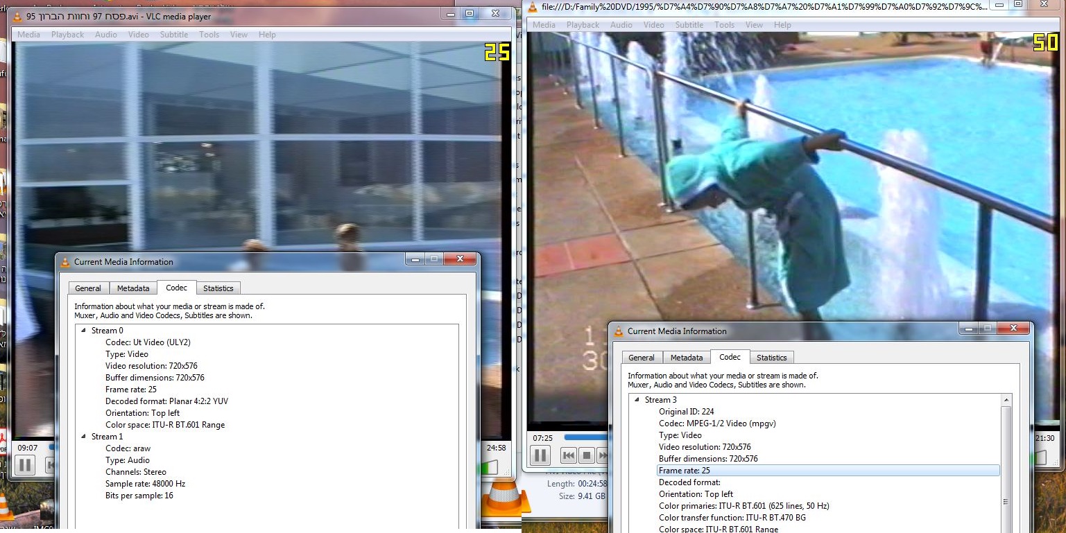

  10. I have found out that my main problem is that the video is not smooth enough like my previous capturing 10 years ago.
    I downloaded FPS counter and played both of the files
    The old capture is giving me 50FPS (right) and the new one (left) gives me 25FPS.
    Both of the files are at 25FPS in the codec info.
    Why does the MPEG2 is looking quicker to my eyes and plays like on TV while the lossless is looking some kind of slower?

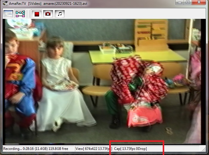

  22. Originally Posted by dellsam34 View Post
    It's a combination of VCR's TBC and capture software, I've had that happens to me with one JVC VCR and not with other VCR's with vdub, this is one of the reasons I don't use vdub for capturing and use a light weight app like MediaExpress. OP you can try AmarecTV, Also check your frame drop count. This couldn't have been a computer issue otherwise it will happen with every VCR.
    I have tried AmarecTV now and I get the same results but on different parts on the tape-it's random.
    In Vdub I doubled checked, and there were no frame drops.
    I see no frame drops on Amarec either but I do see that when it happens, the Cap (25FPS) goes down to 13-16 like in this picture.

  23. Capturing Memories dellsam34's Avatar
    Jan 2016
    That's your problem right there, Frame rate should be constant 25fps for PAL, Find out why your capture card driver is lowering it, In a sense that's frame dropping, that's like dropping 21 frames a second.
