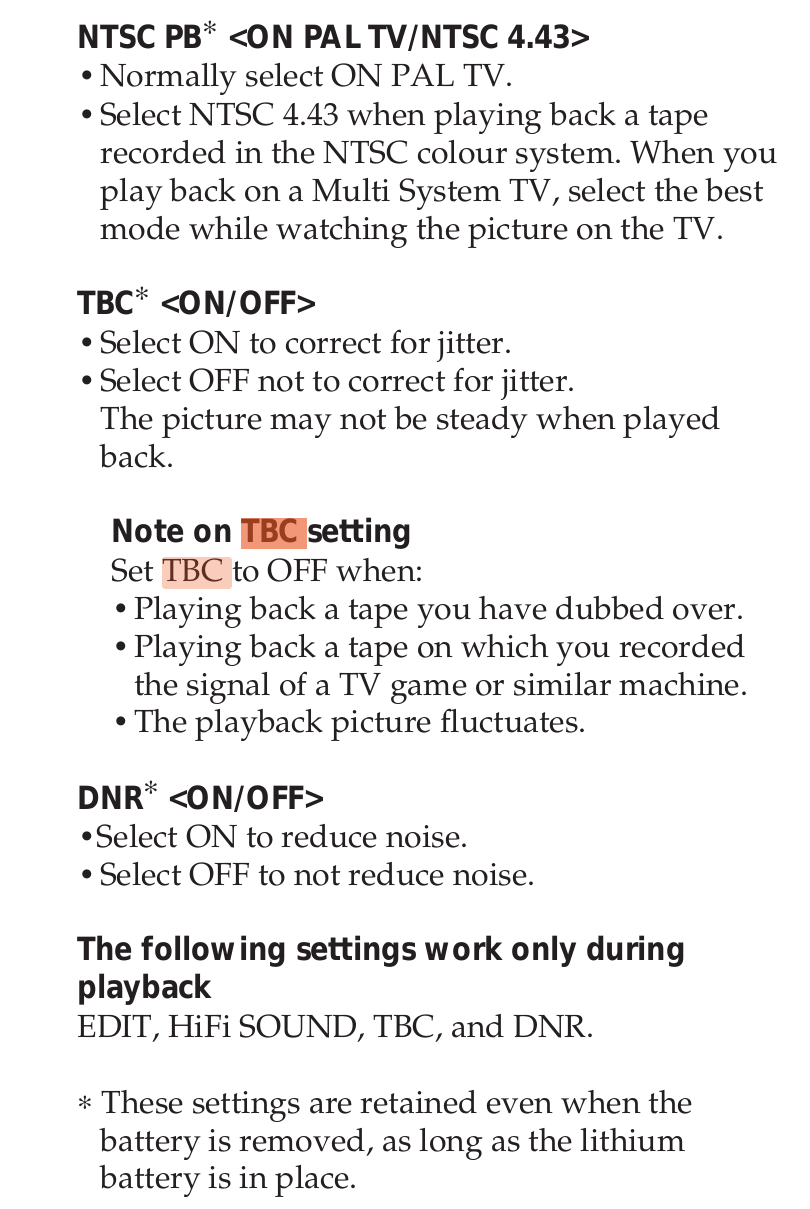

    Now I attached its manual and the screenshot of TBC (p-35) here
    Would this Camcorder be suitable for me?
    Please advise before I contact the seller to clarify other details. Thank.

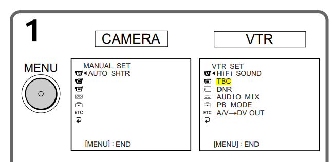

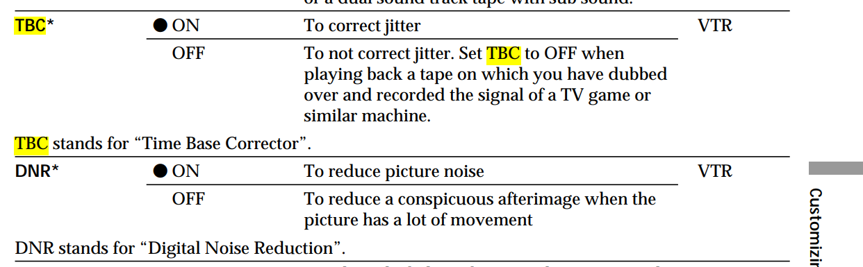

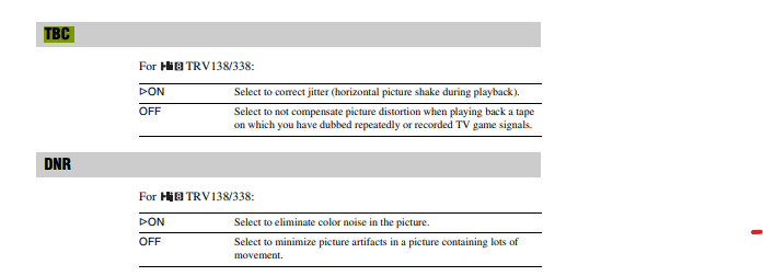

  6. Originally Posted by satimis View Post
    Please advise how to check TBC/DNR and S-Video out on its manual?
    How about a simple text search in the manuals for "TBC", "DNR" .... etc. ??

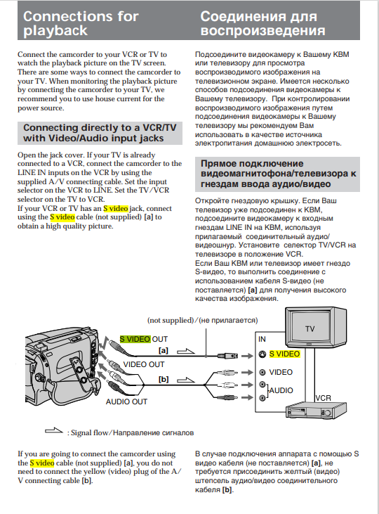

  8. Originally Posted by satimis View Post
    I already did. Please see my posting #35, made by searching on the manual. But I couldn't find S-Video
    Page 22 and page 98:

    Image Attached Images
    Last edited by Sharc; 18th Sep 2023 at 03:25. Reason: figure from the manual of post #35
