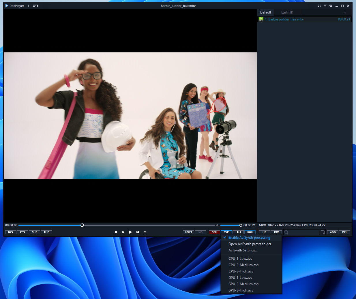

  2. Here is the video fragment where Judder effect shows up. Figures (and especially the hair) twitch very much when camera moving.
    https://files.videohelp.com/u/307528/Barbie_judder_hair.mkv
    I'v tried SVP technology build in PotPlayer, but it doesent help.

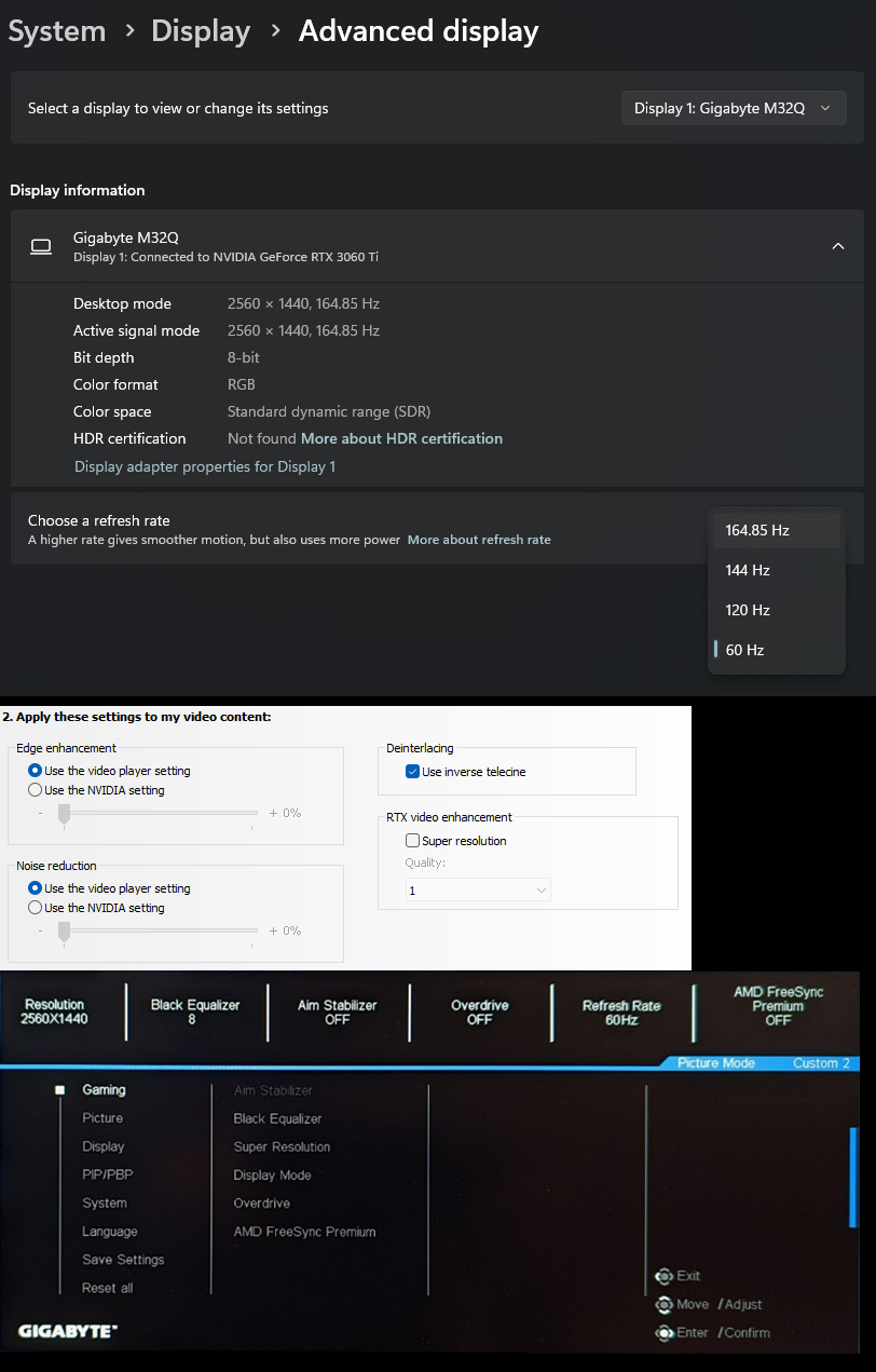

  3. I'm not all that familiar with the latest display technology, but until someone else comes along....
    What refresh rate is the computer connected to the monitor? Is it 165Hz? Ideally the refresh rate should be an exact multiple of the frame rate.
    165 / 24 = 6.875
    If the refresh rate was 120Hz:
    120 / 24 = 5
    So each frame would display for 5 refreshes.
    Have a look in the nvidia control panel, or whatever they call their control panel these days. I'd start by disabling everything in there that can mess with video specifically (not games), and see how it looks then. Except maybe any option for removing pulldown or telecine. It's probably a good idea to leave that enabled.
    Have you tried adjusting the monitor's settings? There's possibly a preset for video, or even better, a preset that doesn't mess with the video. If you're using a gaming preset that could be part of the problem.
    If it's nvidia settings, or monitor settings, or even the player's settings.... anything that can mess with the video.... disable everything you can disable and start from there.
  4. Yes, run your monitor at an integer multiple of 24 (or 23.976) fps (ie, 24, 48, 72, 96, 120...). You'll still get the inherent flicker of 24p but not the judder.

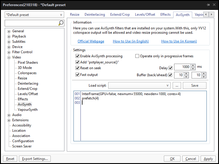

  11. If you have a fast CPU/GPU you could try using PotPlayer's ability to use AviSynth:
    [Attachment 73856 - Click to enlarge]
    I set the frame rate there to 55 fps since that's 1/3 of your refresh rate. That should give you smooth motion if your computer is fast enough. You'll need to install AviSynth+, the Interframe filter for AviSynth, and any other filters Interframe requires. That type of frame rate interpolation often doesn't work well (it may generate gross distortions). And it may not be fast enough for your 4K video.
  12. Here's what that filter delivers at 55 fps. Does it play any smoother for you? Notice all the distortions?
  13. Hi, jagabo. First of all, thanks you!
    I've tried your 55 fps Barbie_55.mkv fragment. This file playing very smoothly, if not reduction in quality — it would be perfect
    But AviSynth says that this script setting (on screenshot) have error: "Script error: There is no function named 'InterFrame'-. (potplayer_avisynth_script, line 2)"
    also, is there any option to install AviSynth+ (plus) to PotPlayer?
  14. InterFrame is a third party AviSynth filter (ie, it doesn't come with AviSynth). You need to download and install Interframe and SVPFlow.
    https://www.spirton.com/uploads/InterFrame/InterFrame2.html
    https://www.spirton.com/uploads/InterFrame/InterFrame-2.8.2.zip
    The zip file contains the SVPFlow dll's.
    Potplayer will use Avisynth+ if that's the only version of Avisynth installed.
