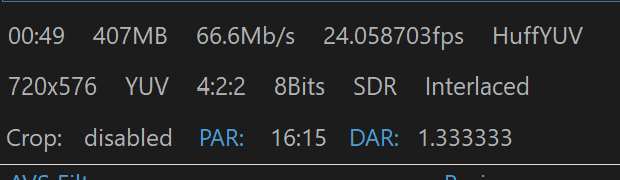

    Things become strange when I import into Staxrip to deinterlace. The fps value is 25fps for previous captures, but in my Amarec test the fps is 24.887384. The target file fps is 49.7747. Media Info shows the frame rate as 25 so I'm not sure what is causing this. Strangely in my deinterlaced file the audio is out of sync, while it is fine in the original avi.

    Screenshot shows Staxrip view when setting up a deinterlacing job for this segment - somewhat off a 25fps input.
Name:	Screenshot 2023-09-12 174359.png

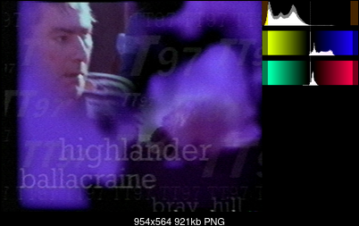

    Histogram and Levels:

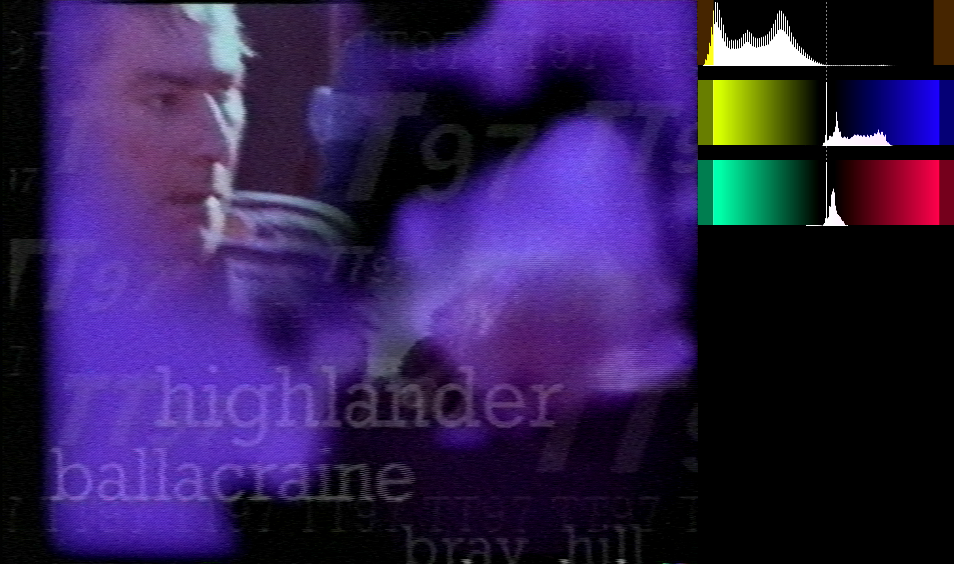

    A simple AviSynth resotration with QTGMC, TemporalDegrain2 and LSFmod improves a little bit the video (I did not adjust levels out of 16-235 range):
    comp.mp4
    The frame rate looks ok at 25 frames per second to me. I do not use any GUI, so I cannot comment on Staxrip handling of interlaced material.
    edit: added img comparison https://imgsli.com/MjA1NTMw
