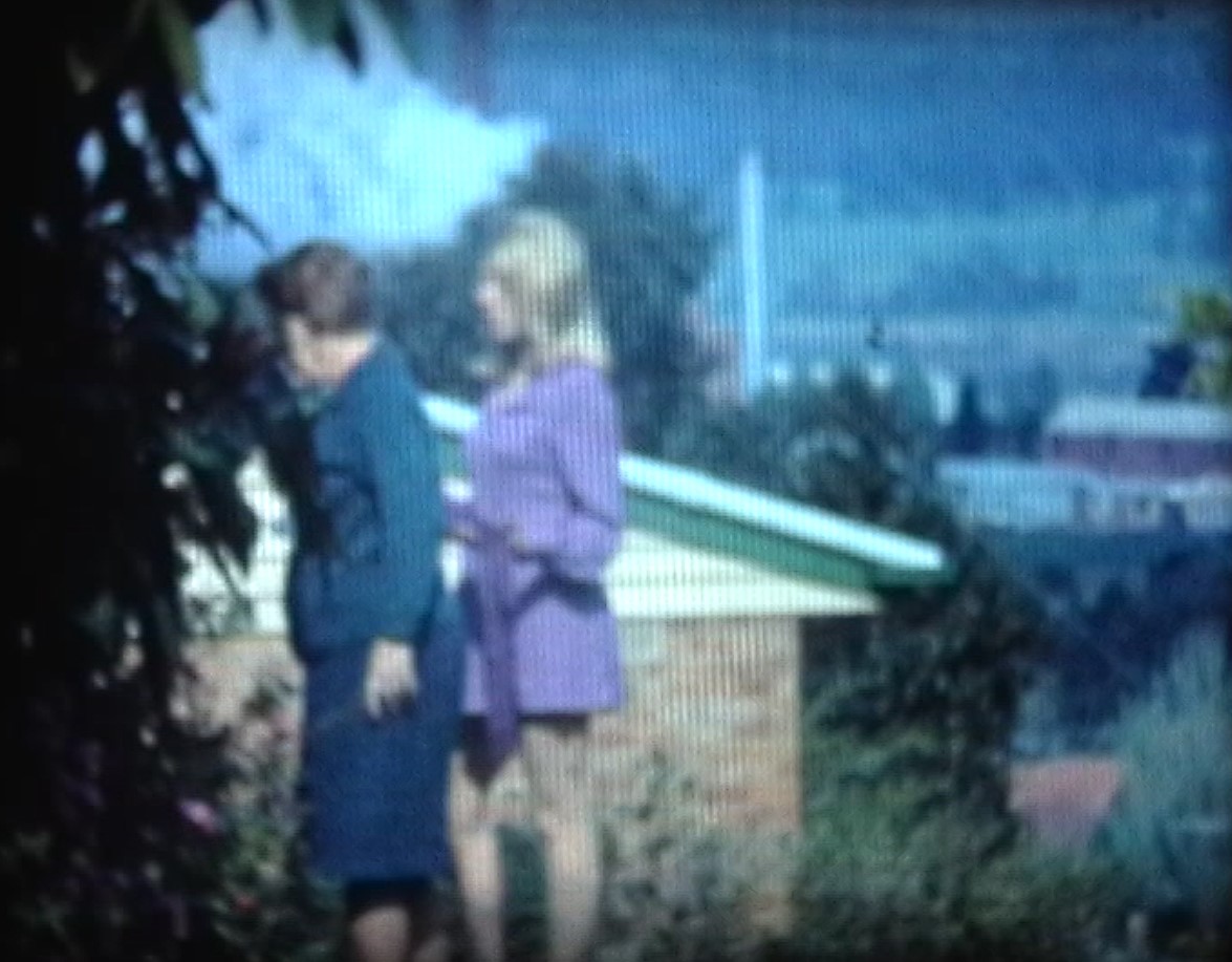

    The older stuff (which is obviously the 8mm stuff) is probably the videos I would like to restore the most.
    As an example of the worst quality I have, the attached is a still from a very old standard 8mm video.
    The format, in this case, is .avi.
    [Attachment 73735 - Click to enlarge]

    Nordo22, it would be best if you posted a short clip of one of your videos for us to assess. There are options, free and paid, command-line type coded or GUI based, that you can use to improve just about any video. Blacks/Whites and colours can be easily adjusted, sharpness added, noise reduction applied.
    To make a short sample, use AVIDemux (you can run the portable version so it doesn't install on your system), open your file, leave all the settings as-is except for the Output Format dropdown-make that the same as your file (eg AVI file? Select AVI Muxer from the dropdown)-then, on the timeline, set an "in" point then hit the A, then set the "Out" point and hit B, then save the video.
    10 seconds or so of AVI won't exceed the forum upload limit of 500MB (the time-length of the selection is over on the right of the timeline). Try to include some movement so the Interlacing can be assessed.

    Re that image in post 3, I reckon most of the cross-hatching noise could be removed. Could you also post a small sample of that video?
