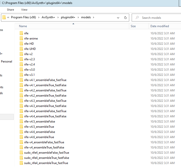

  4. In my plugins64+ folder I have RIFE.dll and a folder called models. Inside the models folder are folders for all the different models.
    [Attachment 74186 - Click to enlarge]
    Each of those has bin and param file(s).

    They're the folders I'm trying to find/get but can't. There are no downloadable folders on Github, apart from each individual BIN and PARAM file for each model, which I can't drag and drop into my plugins folder anyway; Windows won't let me, even as an Admin.

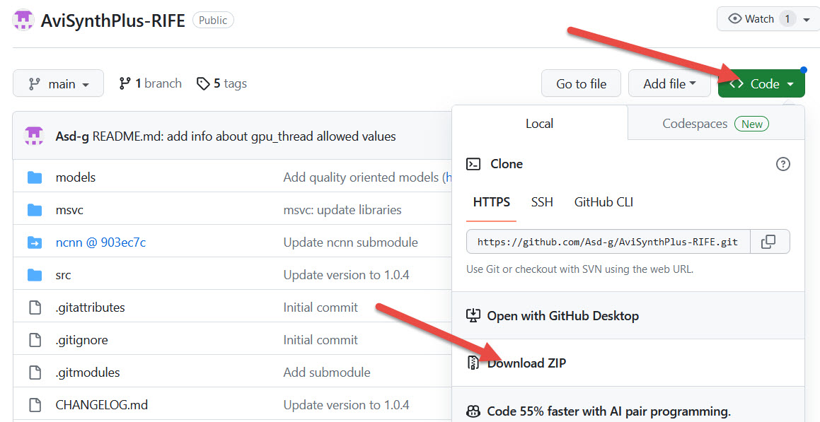

  6. Originally Posted by Alwyn View Post
    You can download the whole project and models by left clicking the green code button => download zip. You might have to be signed into github for that option. Download to a non C: drive
    Then use z-zip/winrar some archive extractor on the zip file. Copy/paste the models folder that jagabo mentioned above
    [Attachment 74207 - Click to enlarge]

    Thanks PDR! Much appreciated.
    Edit: all downloaded and working well, thanks both.
