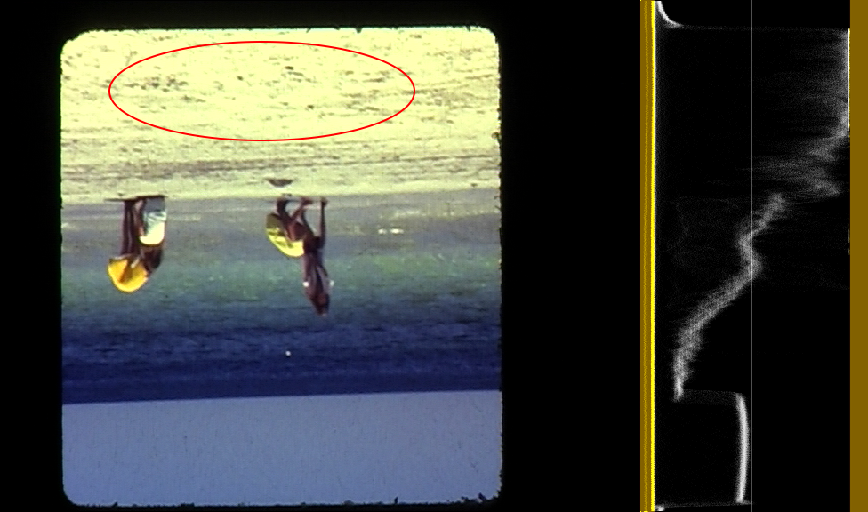

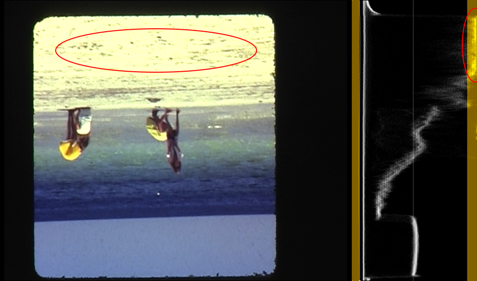

  18. @Alwyn: It is generally a challenge to accommodate the contrast of super 8 with SD video. You may however want to take care of the levels. Your capture has clipped superwhites. By tweaking the levels you can try to recover some of the lost details in the overexposed brights (235....255 luma). Example attached (top=original, bottom=tweaked). If your TV plays superbrights it's less critical. Nothing you can do with the clipped luma though.
    smoothlevels(26,1.0,255,16,235)
