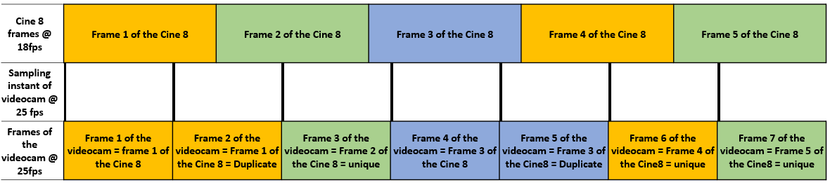

    Added:
    Due to the aperture (exposure) duration of his video camera he might also see occasional blends of 2 adjacent frames of the original 18fps pictures, because a film frame may change during the time the videocam's shutter is open. Plus other issues .....
    Added2:
    Explaining where the duplicates come from (simplified)
