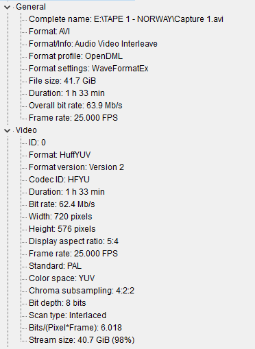

    VirtualDub projects the file to be 111.5 GB, the original file size is 41.6 GB, here is the MediaInfo for the original
    [Attachment 73706 - Click to enlarge]
    What am I missing?

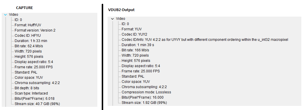

    Just did a check of the codec for a small sample of the Trim'd clip, it is a different codec. It appears the Huffuv that I have on my old Windows 7 laptop is different to the Windows 10 PC I am doing my work on.
    Virtual Dub 2 - Huffyuv v2.1.1
    Capture - Virtual Dub 1.9.x - Huffyuv V2.1.1 - CCESP Patch V0.2.2
    [Attachment 73707 - Click to enlarge]
    Is this my problem? How do I get VirtualDub 2 to work with the correct Codec, I want to avoid re-doing my captures.
