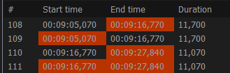

    Because I have many subtitles like this: Image
    [Attachment 73692 - Click to enlarge]
    Where there are two subtitles at the same time, notice that it is the same start time and end time, which almost doubles the subtitle time of my video, but the problem is that I need the subtitles that way and also keep the original duration of the video, in the preview player inside the SE it is perfect, the problem is when I generate the video.
