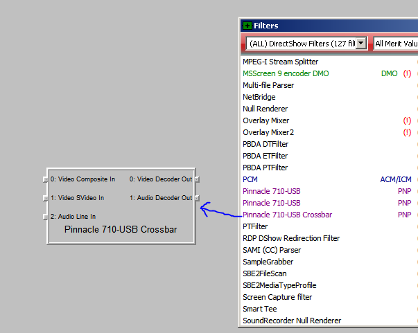

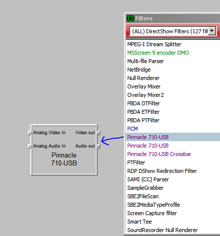

    In GraphStudio there are three Pinnacle 710-USB filters that show up, I have tried all three.
    Pinnacle 710-USB
    [Attachment 73681 - Click to enlarge]
    Pinnacle 710-USB CrossBar
    [Attachment 73682 - Click to enlarge]

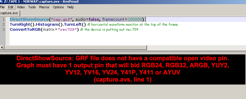

    Selecting only one of the filters, I save the graph file as cap.grf.

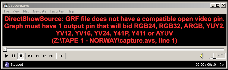

    When I go to open the avs file in AvsPmod it gives me the error:
    DirectShowSource: GRF file does not have a compatible open video pin. Graph must have 1 output pin that will bid RGB24, RGB32, ARGB, YUY2, YV12, YV16, YV24, Y41P, Y411 or AYUV
    [Attachment 73683 - Click to enlarge]

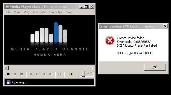

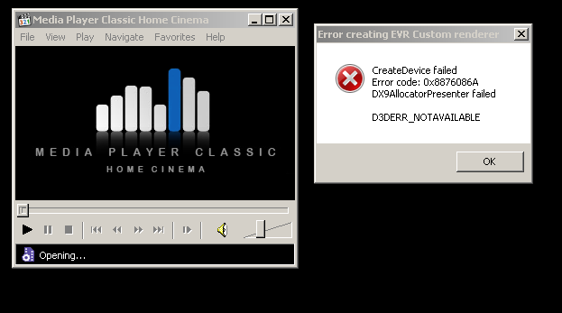

    When I try open in MPHC, I get two errors and then the same error as AvsPmod.
    [Attachment 73684 - Click to enlarge]
    [Attachment 73685 - Click to enlarge]
    [Attachment 73686 - Click to enlarge]
    Please help, what am I doing wrong?

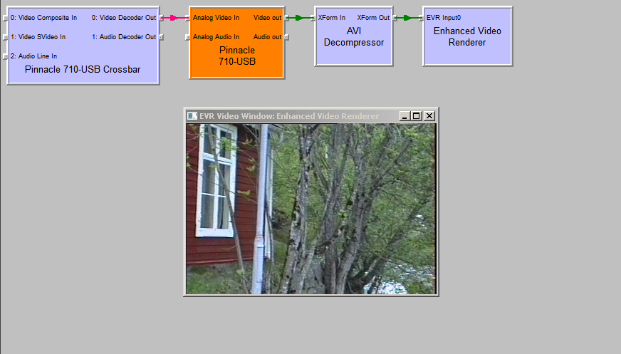

  2. UPDATE
    I played around and got Graph Studio working
    [Attachment 73696 - Click to enlarge]
    But I still get the error below when I try to open my Avisynth code in MPHC, VirtualDub or AvsPmod
    If I drop off the Video Renderer at the end, MPHC, VirtualDub just freeze when I open the avs file.
    What am I missing?

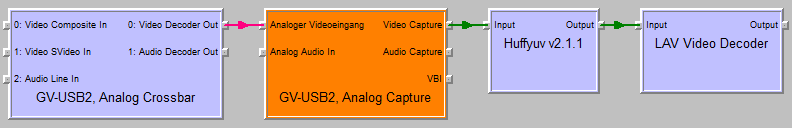

    Below works here for the GV-USB2. Try similar for your Pinnacle:

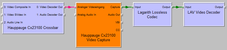

  6. Alwyn:
    This filter graph works perfectly here for the USB-live2. I think you prefer lagarith as the compressor, so I inserted it instead of Huffyuv (which works as well btw.)
    Maybe you have to install the LAV filters.
    Added:
    This is the script which plays fine with MPC-HC, Vdub .....
    DirectShowSource("USB-Live2.grf",audio=false,framecount=10000)
    TurnRight().Histogram().TurnLeft() # horizontal waveform monitor at the top of the frame
    ConvertToRGB32(matrix="rec601")
