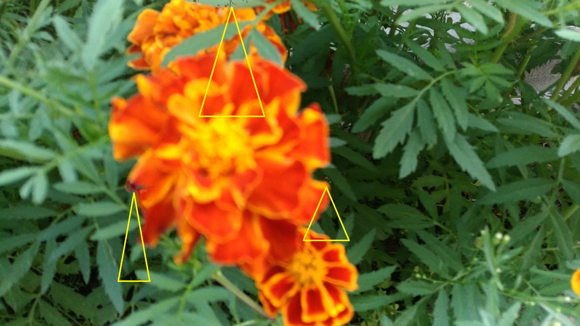

Hello, I encoded 4k video with ffmpeg like this:
but when I trying play this video I see random artifacts.Code:ffmpeg -i orig.mp4 -preset placebo -c:a copy -c:v libx264 -crf 30 final.mkv
[Attachment 73653 - Click to enlarge]
Also I noticed this problem appears only on 4k videos (FullHD is okay) AND if playing with hardware acceleration (when stream decoding by Video Decode gpu block) AND only with placebo preset (veryslow and any another preset doesn't "produce" this artifacts), but if I play with software decoding, everything plays ok without any artifacts.
Thanks!

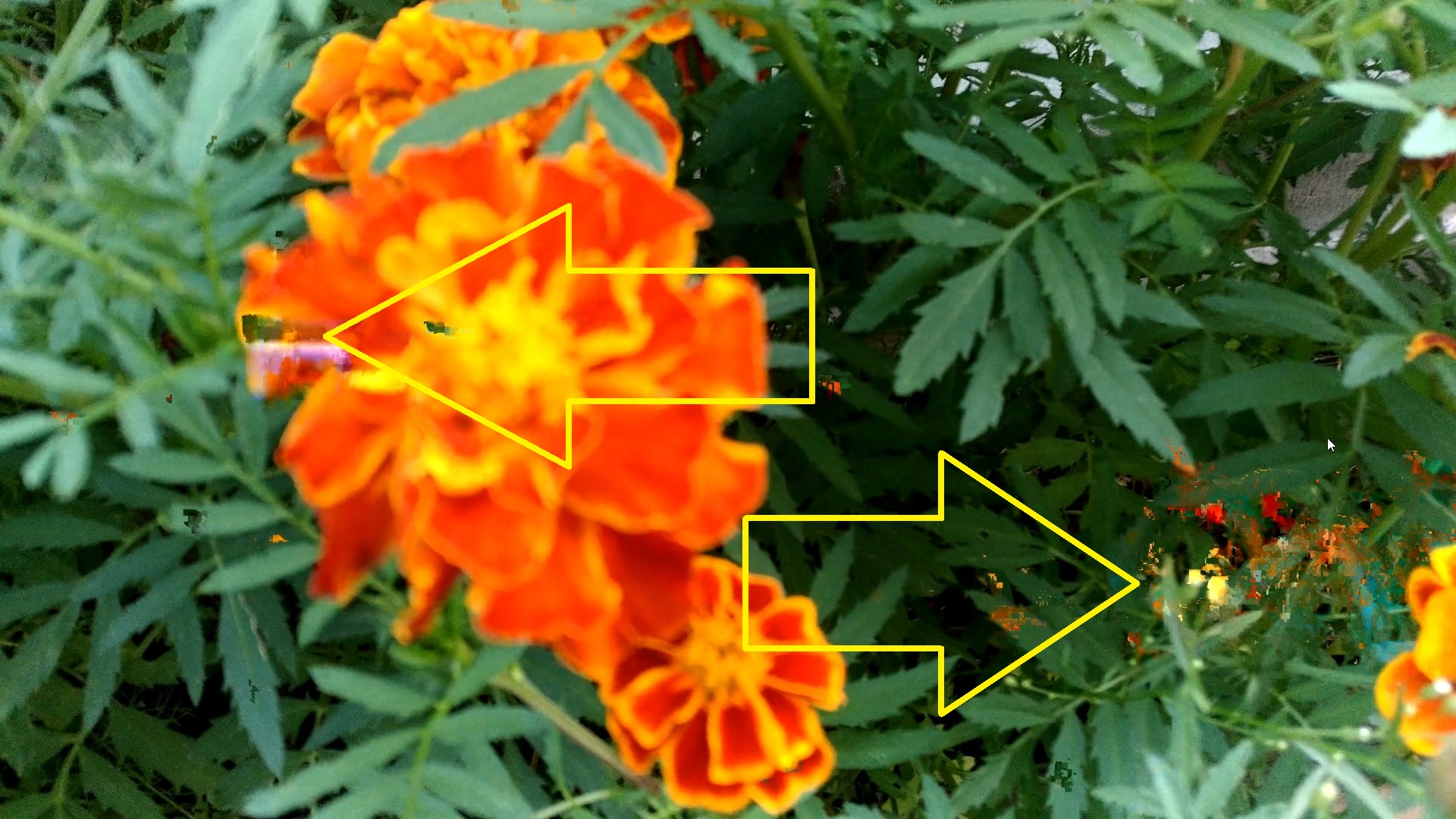

Thanks for your answer! Unfortunately it's not help:
[Attachment 73664 - Click to enlarge] -

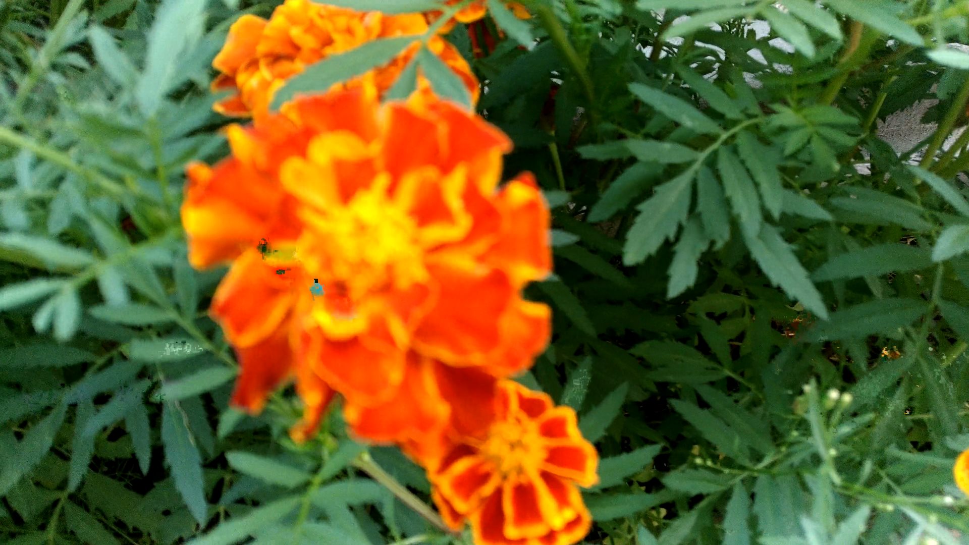

Yes, I tried to play with those parameters, didn't found what exactly affects.
[Attachment 79535 - Click to enlarge]
Yes, for some reason hardware decoders produces artifacts, while software decoders plays well. -
Hardware decoders don't support all possible h.264 parameters.
So far I've found that ffmpeg x264lib with preset=placebo, ref=5, trellis=1, and subme=8 plays properly with the SGCAM source in post #14 on my Nvidia RTX 4060 with VLC and hardware decoding.
Leaving any one of those modifiers out leads to playback errors, especially trellis. By the way the default values when using preset placebo are ref=16, trellis=2, and subme=11.Code:ffmpeg -i SGCAM_20230827_035840892.mp4 -c:a copy -c:v libx264 -preset placebo -x264opts ref=5:trellis=1:subme=8 x264.placebo+ref=5+trellis=1+subme=8.mp4
