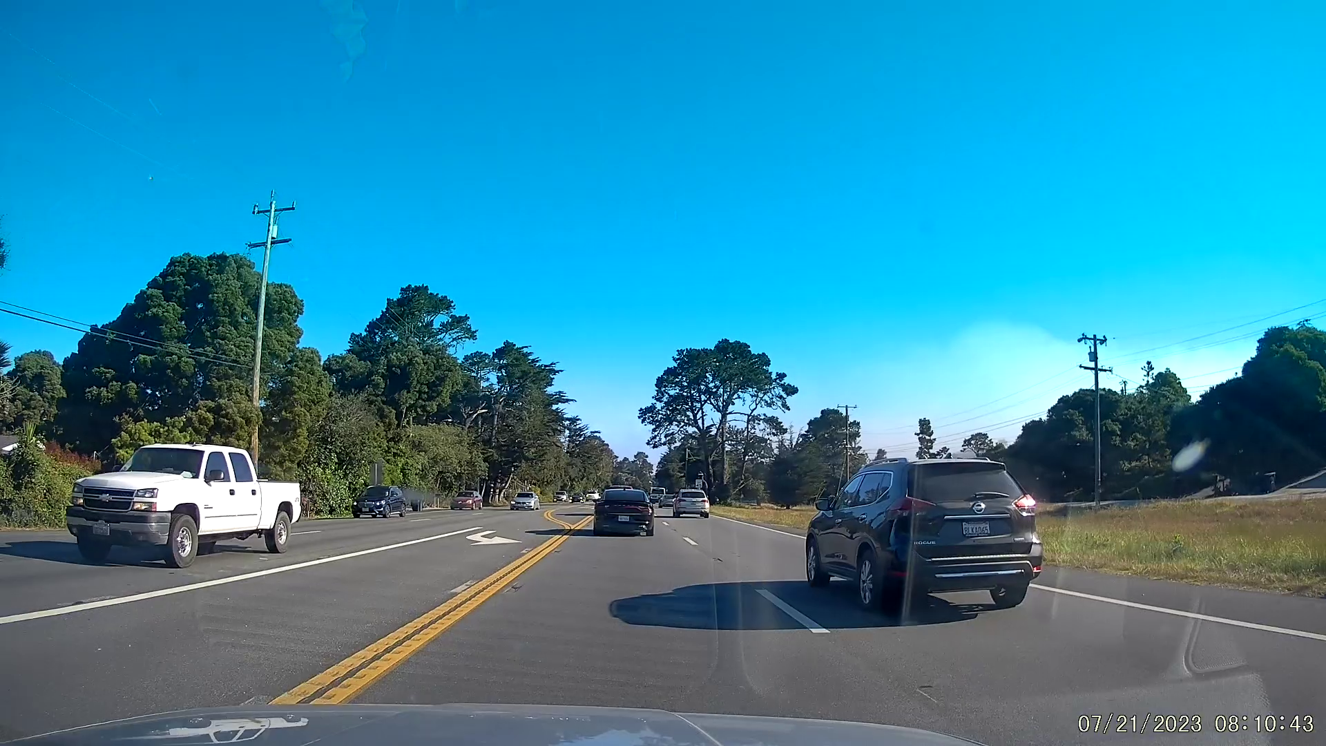

  8. Here is a still shot from my own dashcam. As you can see, it too is pretty awful, even though it is one which gets good reviews. (Someone gave this to me as a Christmas present -- I wouldn't have spent my own money to buy something like this). However, bad as it is, you will find that you can pretty easily read the license plate on the car to the right, which is about where the car on the right was in your video at the moment of impact. However, the car directly in front, which is actually a little closer than the perp's orange car was in your video, has a license that is impossible to read, although at least there is a little something there. Your video has no pixels at all that can be used.

  10. If you zoom in on the perp's license plate and count the number of pixels, the image is 3 pixels high by 8 pixels wide. Since there is no information inside of a pixel, there is no way you could make out even one letter with 3 x 8 pixels, much less a license plate. This video is 1280 x 720 (and actual sensor may be less than that). To resolve a license at that distance with the lens used would require even more than 4K (3840 x 2160).
