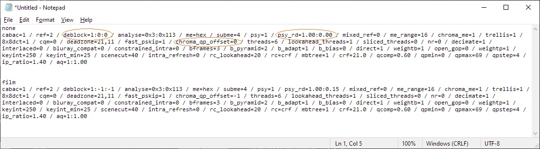

  6. For example "tune". It is not clear what the codec is using. Profile, one is specified when encoding, and another in media info.
    Mar 2008
    It's not mentioned directly, but it's inferred by other values

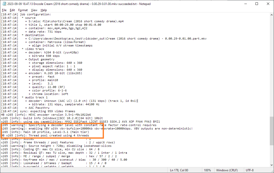

    The results from an encode in VidCoder looks OK:
