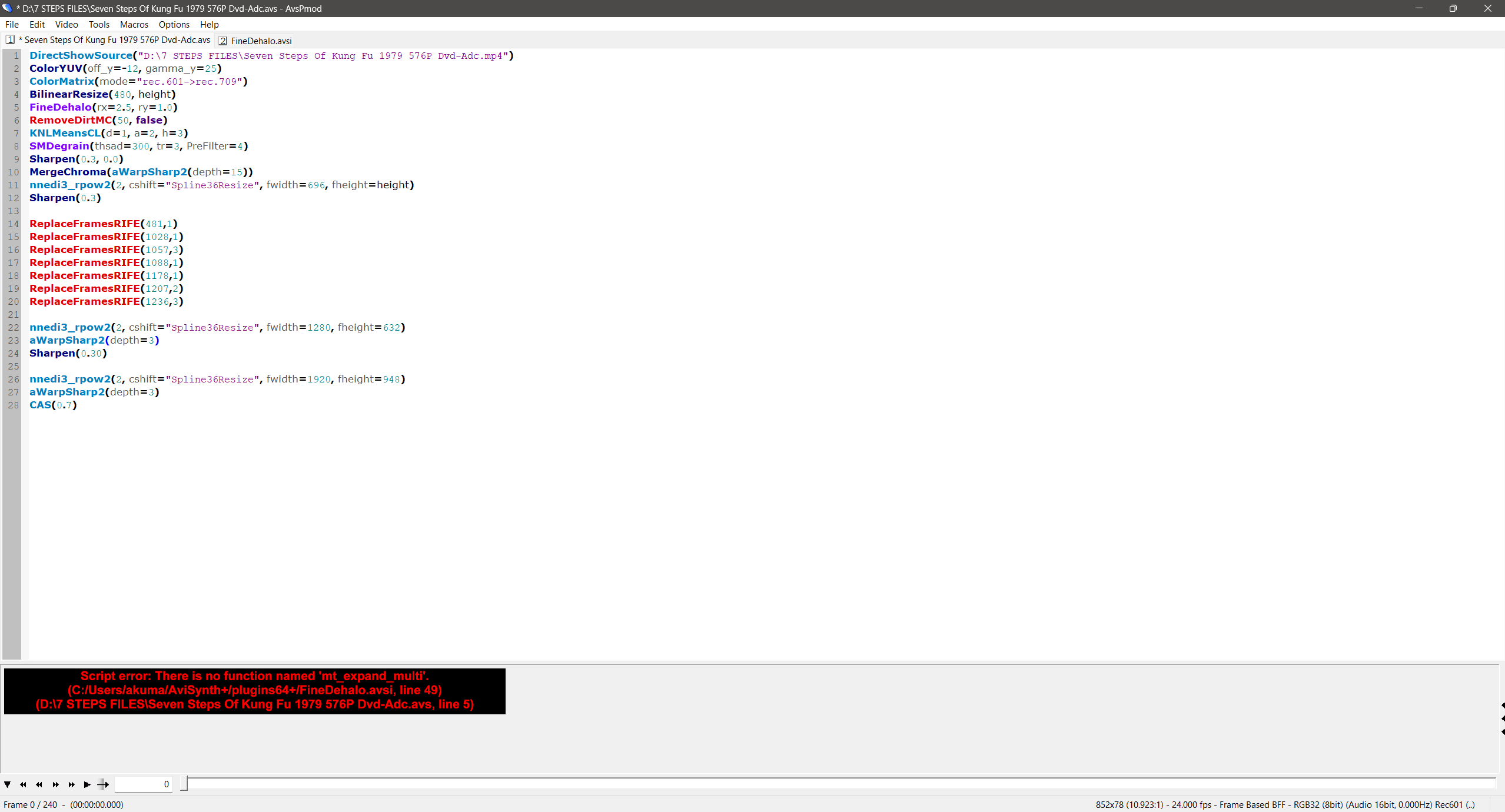

  8. Here's the script I used with the addition of halo reduction, more noise reduction, and upscaling.
    I've installed avisynth and when i open your script i get following error:
    [Attachment 73659 - Click to enlarge]
    I'm new to avisynth. what am i doing wrong would you know
  9. I believe mt_expand_multi is included in Dither Tools:
    http://avisynth.nl/index.php/Dither_tools
    Yes, there are hundreds of third part support filters. It can be hard to find everything you need.
  10. Yes, there are hundreds of third part support filters. It can be hard to find everything you need.

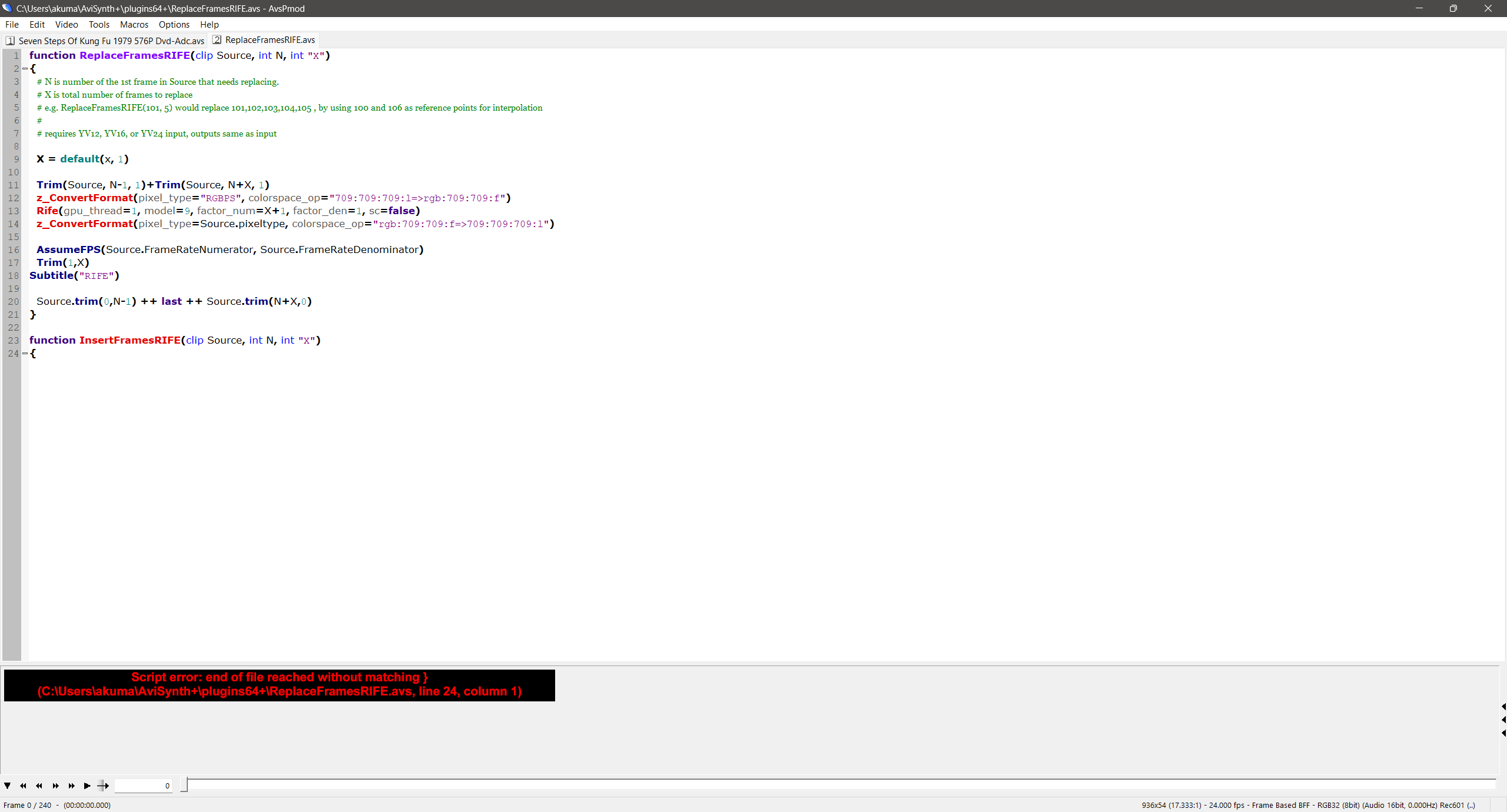

    here is the replaceFramesRife script i have saved:
    [Attachment 73663 - Click to enlarge]
  11. Yes, copy/paste the code from that post and put it in an AVS script. Or paste it into your main script. But your ReplaceFramesRIFE.avs should contain only the two functions, ReplaceFramesRIFE and InsertFramesRIFE. Don't include the code after that.

  12. Originally Posted by Akuma786 View Post
    Also can the fps be changed from 25 to 24fps
    You can change to 24.0 fps with AssumeFPS(24.0). Or 23.976 fps with AssumeFPS(24000,1001). Those will also increase the running time by about 4 percent as they keep every frame and the frames are unchanged. If you're handling audio within the script add sync_audio=true to those commands.
    I highly recommend against using DirectShowSource() as it's not frame accurate. It should be used a last resort when ffmpegSource and LSMASHSource filters have failed.

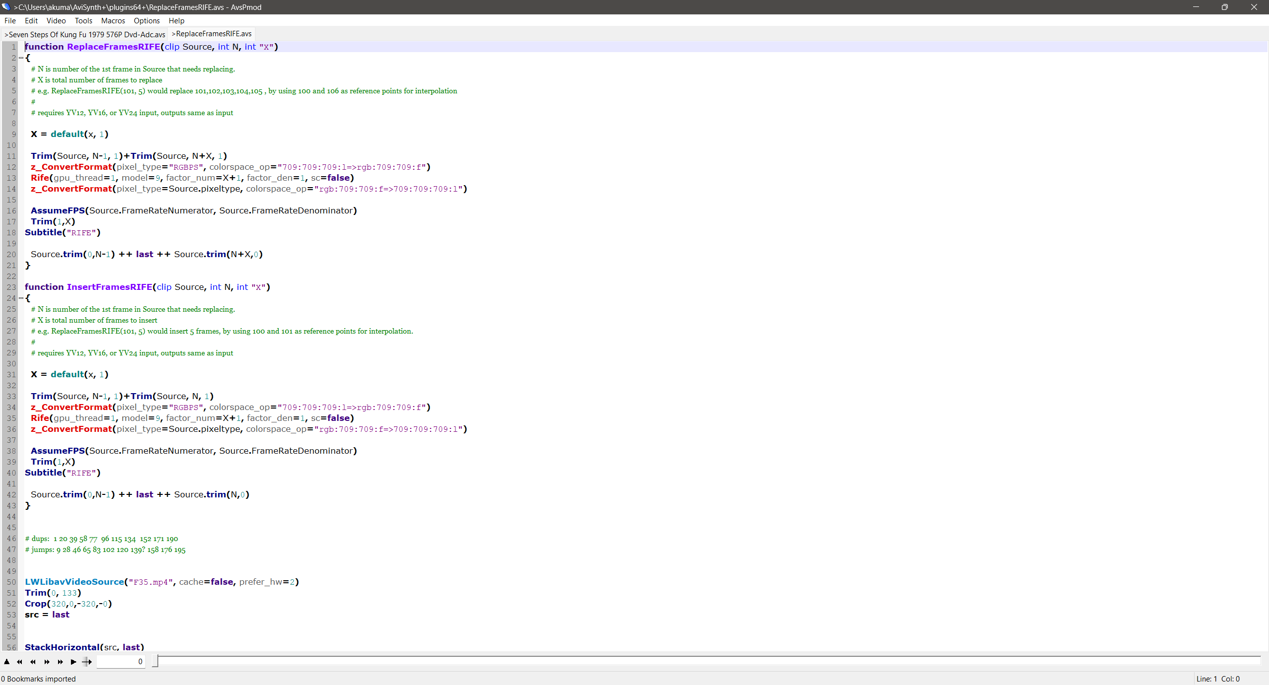

  13. Yes, copy/paste the code from that post and put it in an AVS script. Or paste it into your main script. But your ReplaceFramesRIFE.avs should contain only the two functions, ReplaceFramesRIFE and InsertFramesRIFE. Don't include the code after that.

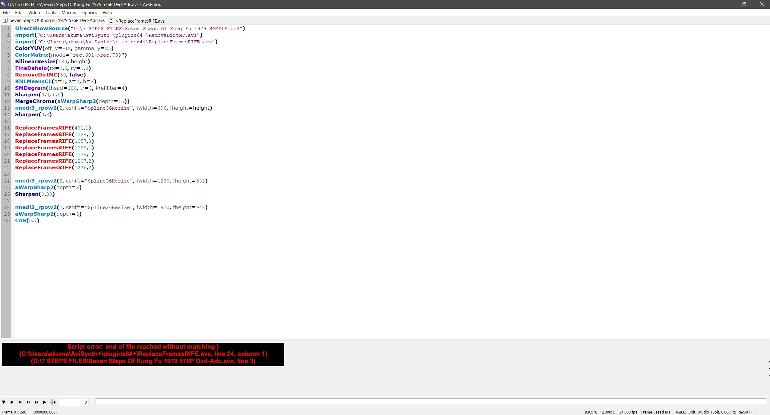

    still getting error :
    [Attachment 73667 - Click to enlarge]
    this is the ReplaceFramesRIFE.avs which i have saved in the plugin64 folder of avisynth+ :
    [Attachment 73668 - Click to enlarge]
    Sorry to be a pain.
  14. You need to remove the bottom two lines of ReplaceFramesRIFE. Or include the entirety of InsertFramesRIFE. You might need it later anyway.

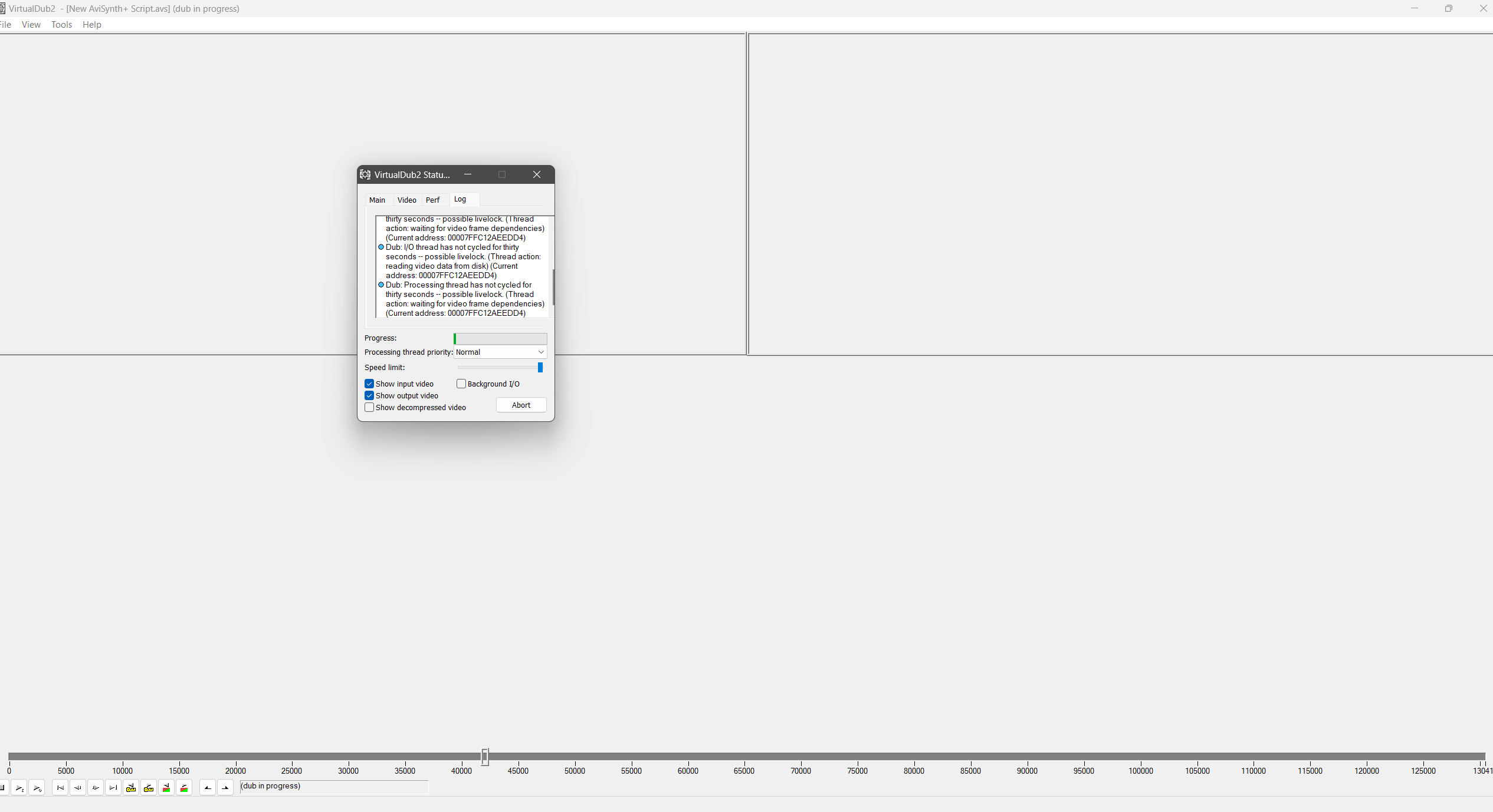

  15. Originally Posted by jagabo View Post
    Thank you Jagabo. I have finally managed to get the script to run on AvsPmod without any errors now!
    so i opened the script on Virtualdub2 64bit and tried to save the file as mp4 and it crashes after a few minutes into rendering it.
    [Attachment 73675 - Click to enlarge]
  16. Try disabling putting return(last) just before the first call to ReplaceFramesRIFE:

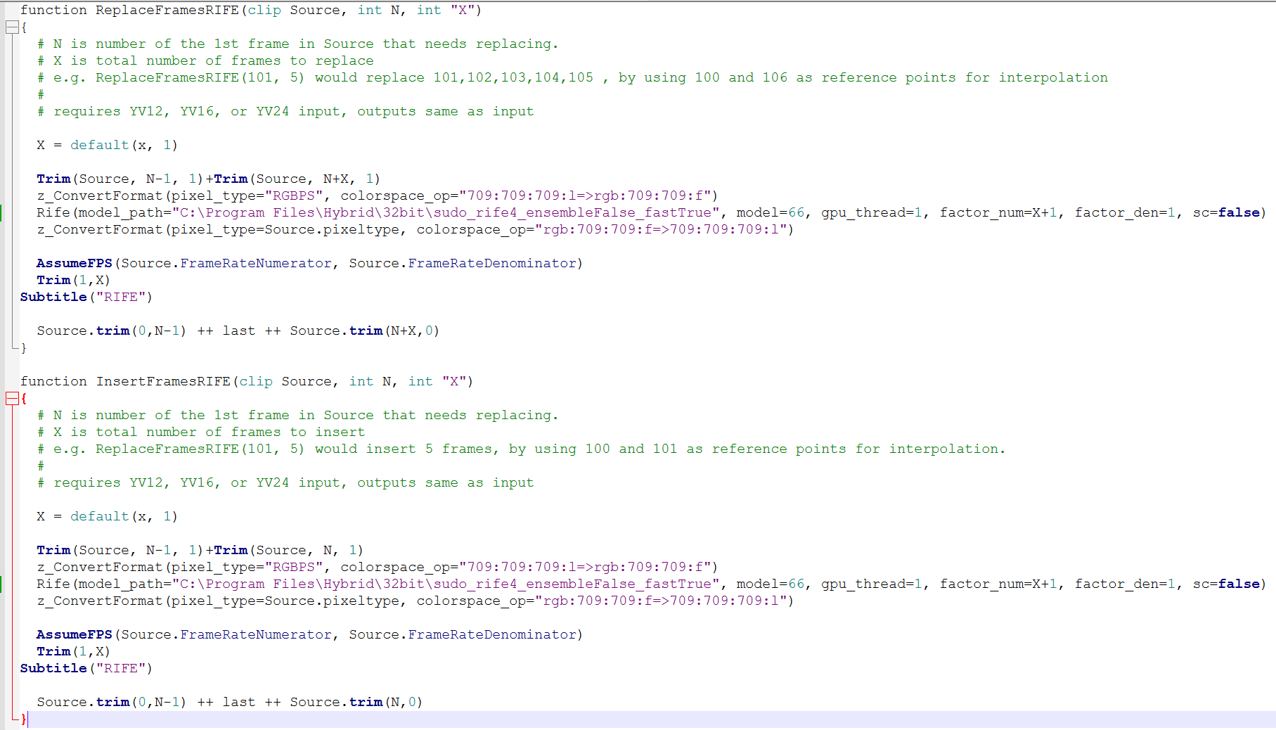

  26. Hello, and sorry for trying to revive an old thread. I would appreciate some help if possible. I'm trying to clean up some old files with visible static/noise at just about every scene change. I've checked other copies of the file and it's the same problem. So it looks like an issue during production.
    I am attempting to use your script to replace those bad frames in one file. Your script mentions "ReplaceFramesRIFE(101, 5) would replace 101,102,103,104,105 , by using 100 and 106 as reference points for interpolation". However, my application of it only seems to replace the N variable of "101". The X variable doesn't appear to do anything with the other 4 frames I would like to remove. Could you please take a look at my scripts and see if there is something wrong within?
    Here is my script, had to modify it because Hybrid AviSynth couldn't find the models:

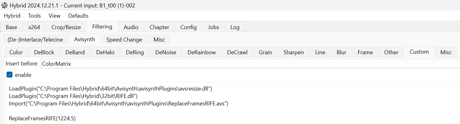

    And here is the custom script I'm using within Hybrid:
    [Attachment 84569 - Click to enlarge]
    Any help would be much appreciated!
    Thanks!
  27. RIFE won't work across scene changes. It won't find any motion vectors for interpolation.
  28. Well that makes sense then. Thanks for the quick reply!
