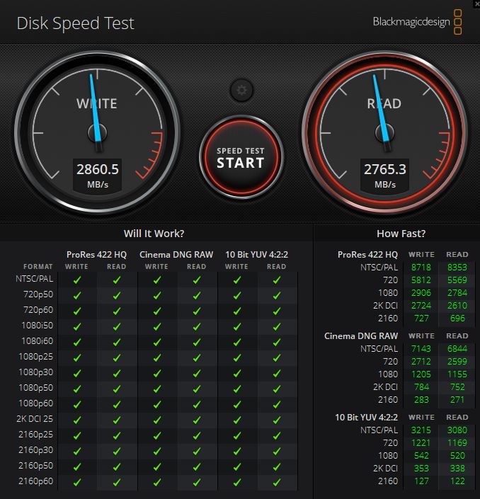

  7. I use a NVM.e drive (dedicated, non-system) and it sure is nice to have a 3000MB/s transfer rate, mainly, I find there is little need to worry about imparting any sort of jitter anymore when doing any other work while capturing, processing, or encoding. When using HDD and SDD, it always seemed to be the drive speed that was the bottleneck.

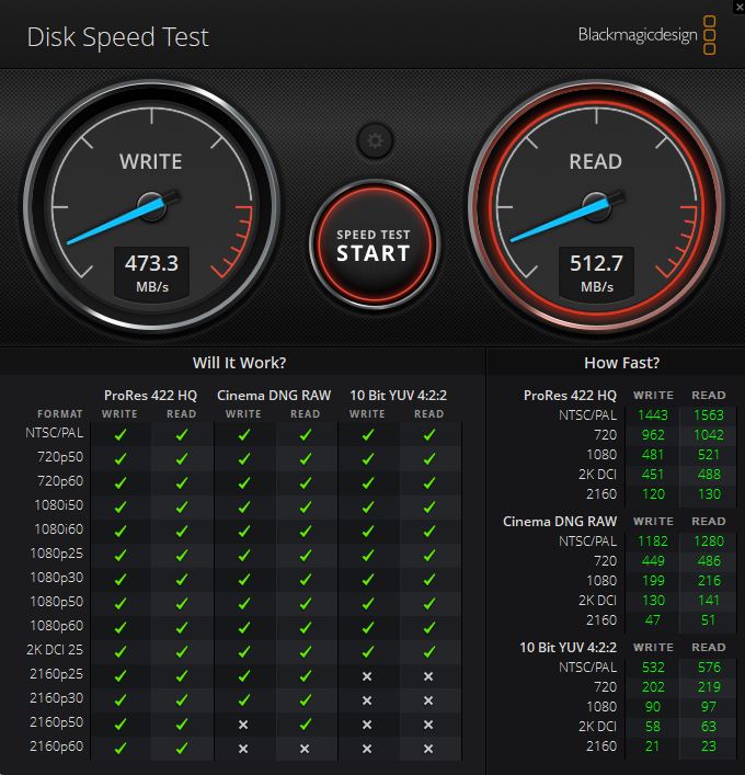

  10. Whatever drive you get, I highly recommend Blackmagic Design Disk Speed Test to actually test bulk data transfer speed, CrystalDiskInfo to monitor drive temps and health, and of course if you're using Windows, additionally task manager to monitor disk response time and see what is hitting the drives. Even at many SSD speeds, a simple automated virus scan can randomly cause issues on a non-system drive. It is the disk response times that seem to really cause issues. It was horrible when I used HDD's, then almost always fine when I used SSD's, and that wasn't even high def video rates. If you're considering working with high def or above, I probably would use the NVM.e's; heck they're actually cheaper than many SSD's now. Crucial is a good SSD and NVM.e producer.
    FWIW, on my NVM.e, I can capture a stream and run a deinterlacing/processing script in Avisynth+ on another file simultaneously. I have done this on hundreds of videos without any dropped frames or hardware related issues.
