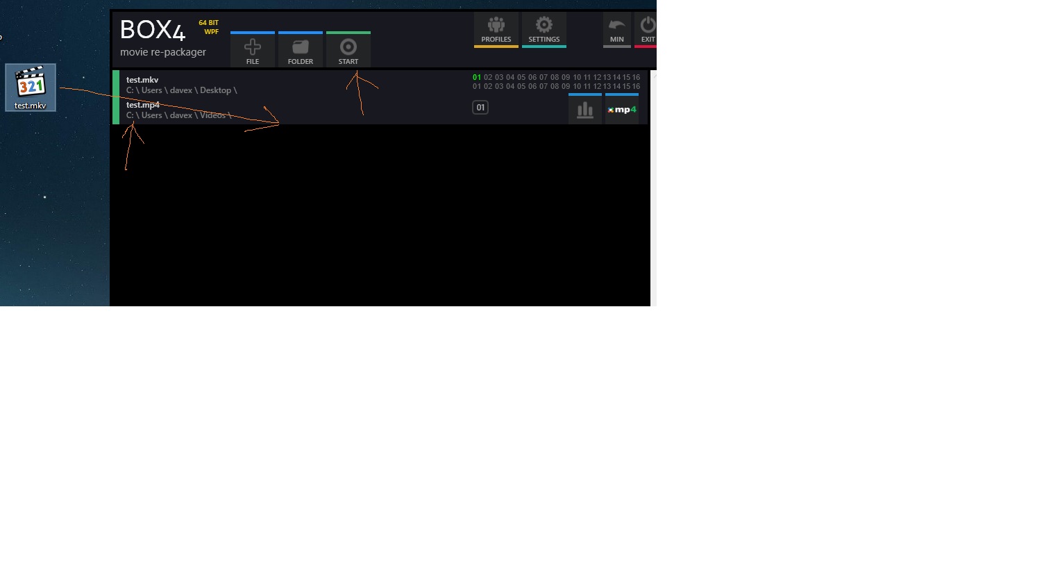

    Have you tried Box4 to remux your MKV instead?
    It's quicker, and keeps original quality
    https://www.videohelp.com/software/BOX4
  13. ok so this is just to normalize the framerate?
    Windows 10, MPC-BE
    Mar 2008
    No. It's doesn't re-encode, it just puts the existing video and audio into an mp4
  15. hmm i couldn't figure out how to change the output to MP4.
    Windows 10, MPC-BE
    Mar 2008
    Drag the file into the Window
    Make note/change the output path
    hit start

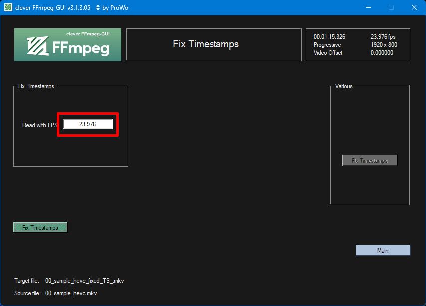

  21. Originally Posted by Kracov View Post
    so what does it mean? what is the solution? i didn't get this kind of error with other video converters. i wish i could use them but i have to find the right version
    You could try clever FFmpeg-GUI.
    Load your movie, click main, click various, click fix timestamps, insert 23.976, click fix timestamps.
    The file is read by the given fps and streamcopied only, no reencode occours.
    [Attachment 73549 - Click to enlarge]

  24. Originally Posted by Kracov View Post
    I can't use clever ffmpeg, because I pointed it to the ffmpeg.exe, and yet it gave me a bunch of errors and told me to reinstall. But that doesn't make sense, it's a portable program.
    You should point it to the bin folder, like in the picture.
  25. what bin folder? I only see the mkv filenames.
    Windows 10, MPC-BE
  26. Originally Posted by Kracov View Post
    Instead of pointing to ffmpeg.exe, point to the bin folder, that contains ffmpeg.exe, ffplay.exe and ffprobe.exe.
  27. Can you be more specific please? I assume you mean the ffmpeg that's in some other folder that's not included within my Any Video Converter folder.
    Windows 10, MPC-BE
  28. Have you read the readme.txt?
    Download
    https://www.videohelp.com/download/ffmpeg-6.0-full_build.7z
    and extract it to any location you want, then point clever Ffmpeg-GUI to the bin folder.
  29. Okay I was confused because my video converter has its own ffmpeg files in the converter folder. The ffmpeg readme doesn't have specific instructions, it seems to be a function list. I've made a custom folder to store everything in and now it works. However I was wondering if you meant that the ffmpeg file is stored in the Windows folder somewhere? It would explain my problems with various converters, perhaps they are using that version rather than the program folder's ffmpeg.
