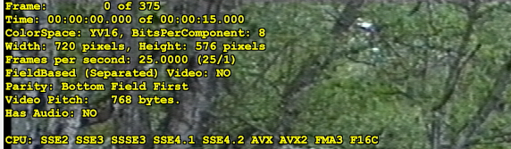

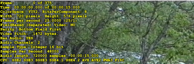

  5. Originally Posted by Skiller View Post
    Put these two lines right after AviSource and post the screenshot:
    Info()
    Return(last) #yes it skips all the filtering on purpose
    Do the same with LWLibavVideoSource and post the screenshot.
    Hi Skiller
    avisource
    [Attachment 73802 - Click to enlarge]
    LWLibavVideoSource
    [Attachment 73803 - Click to enlarge]

    So AviSource decodes as YUY2 and LWLibavVideoSource decodes as YV16!
    Since the latter seems to work for you, maybe a simple ConvertToYV16() right before QTGMC when using AviSource is all what's needed to fix it. It's a lossless operation.
