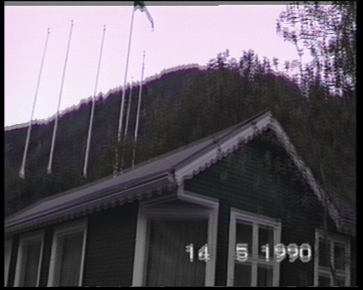

  1. Hi all,

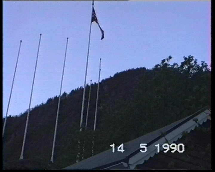

    New to all this, done my first capture of a Video8 Tape. Workflow was Video8 Tape -> PAL Handycam -> S-Video out -> TBC-1000 -> USB-710 -> VirtualDub Huffyuv
    My first step has been to de-interlace and I am only a few days into learning avisynth. I have played around with manual scriptingand Hybrid and arrived at this configuration
    AVISource("VIDEO.avi")
    SetFilterMTMode("DEFAULT_MT_MODE", 2)
    ConvertToYV12(interlaced=true)
    AssumeTFF()
    QTGMC(TR0=2, TR1=2, TR2=1, Rep0=1, Rep1=0, Rep2=4,
    \ DCT=5, ThSCD1=300, ThSCD2=110,
    \ SourceMatch=3, Lossless=2, Sharpness=1.2, SLMode=1, Sbb=0, MatchPreset="slow",
    \ NoiseProcess=2, GrainRestore=0.0, NoiseRestore=0.4, NoisePreset="slow",
    \ StabilizeNoise=false, NoiseTR=0, NoiseDeint="bob")
    ConvertToYUY2()
    Excuse the terrible explanation - but if you look at the attached images, there is is bluryness (dont know how to describe it) to the window frames and some jagged lines on the flag poles. Seems to impact a lot of things that are white in the video. Any guidance on how to fix or improve that?
    Any other general comments or feedback is much appreciated.
    [Attachment 73536 - Click to enlarge]
    [Attachment 73538 - Click to enlarge]
    EDIT - I should add some more context, I am digitising around 30 Video8 tapes. The bulk of it will be uploaded to Youtube to share with family who will view it on their smart TVs. A select few scenes will be compiled together and played on an outdoor projector for a movie night.
    EDIT 2 - I have uploaded a couple more videos
    Clip 1.avi, Clip 2.avi are deinterlaced
    Norway Raw Short.avi is the interlaced capture without any filters, processing...

    Jagged lines – a line TBC during capture would fix this. There is no way of fixing this properly after capture.
    Blurryness on the horizontal axis – is normal. This is what Video8 and all similar tape formats look like because of their limited bandwidth.
    I noticed you are using my QTGMC settings, but changed the sharpness.
    In the QTGMC documentation it says:
    Since source-matching recovers sharpness, the Sharpness default is reduced to 0.2. Source-matching may initially appear less sharp than standard processing because it will not oversharpen. However, be careful if raising the sharpness, because sharpness limiting is switched off by default. This is because sharpness limiting reduces the the accuracy of these modes. Use the MatchEnhance setting to exaggerate additional detail found by modes 2 & 3. This gives a sharpening / detail enhancing effect and works well at sensible levels - but it's a slight cheat that should be used with care as it can easily enhance noise.
    In other words, SLMode=1 is not recommended to be used in conjuction with SourceMatch.
    Better use SLMode=0 (default when SourceMatch is used) and adjust sharpness setting. A good range is 0.1 (neutral) to 0.4 (sharp). You can also try if you like a higher MatchEnhance setting (default is 0.5, recommended max is 1.0).

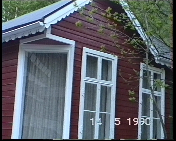

  4. Do you see this as better?
  5. Originally Posted by jagabo View Post
    Yes, a lot better than what I have produced so far - I am still playing around with QTGMC settings. Could I please trouble you for your process/code/workflow?
  6. Here's the script I used:
    LWLibavVideoSource("NORWAY RAW SHORT.avi")
    AssumeTFF()
    ColorYUV(off_y=-23, gamma_y=50) # small black level and gamma adjustment
    # the top field is slightly brighter than the bottom field, so make it darker
    SeparateFields()
    top = SelectEven().ColorYUV(gain_y=-1)
    bot = SelectOdd()
    Interleave(top,bot)
    Weave()
    BilinearResize(480, 576) # smaller frame reduces noise and some of the horizontal time base errors
    QTGMC() # deinterlace
    FineDehalo(rx=2.5, ry=1.0) # reduce the worst VHS oversharpening halos
    SMDegrain(thsad=100, tr=2, PreFilter=4) # motion compensated temporal noise reduction
    Sharpen(0.5, 0.0) # sharpen  horizontally a bit
    nnedi3_rpow2(2, cshift="Spline36Resize", fwidth=720, fheight=576) # restore the frame size
    Crop(8,0,-8,-0) # get rid if ITU borders
    prefetch(8)
  7. Thanks Jagabo! Really appreciate you sharing that. A lot for to learn and this really helps.

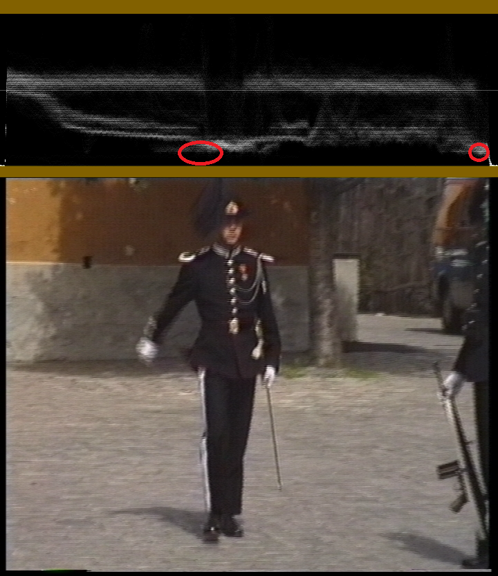

  9. I have played around with the waveform monitor, and think I understand.
    Please correct me if I am wrong on the two points below:
    POINT 1 if something should be black in the scene then it should be as close to the bottom yellow line as possible.
    E.g. in this screen grab below, some parts of the regions circled in black should closer to the bottom yellow bar as the soldier has black clothes on.
    POINT 2 As long as I have not gone beyond those yellow bars, then I have not crushed any colors during capture.
    [Attachment 73642 - Click to enlarge]
  10. Right corner circle indicates that maybe clamp is used or I am wrong?
  11. Originally Posted by mammo1789 View Post
    What you see at the very right is just the narrow black border which is at Y=16 (or RGB (0,0,0). Same for the head switching crud. I don't see clamping for the active picture.
  12. Originally Posted by VideoYak View Post
    Point 1: Yes. Check for various scenes.
    Point2: Yes, for capturing. Still, you may see crushed or clipped darks and/or whites which are baked into the source.
    (The waveform of the active picture should eventually stay in between the top and bottom yellow bar (luma range Y 16....235 aka TV range aka limited range) to be on the safe side for subsequent decoding to RGB, IMO.)

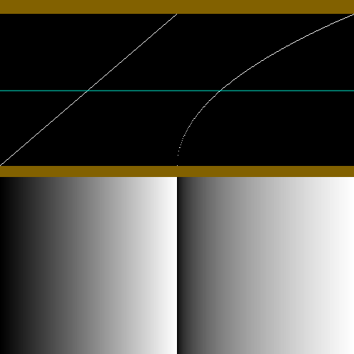

  16. Yes, Levels() can be used for gamma, with the advantage that you can be applied to a limited range of levels.
    By the way, here are some possible Levels() values for the OP's sample:
    Levels(36, 1.2, 235, 16, 235, coring=false, dither=false)
  17. Originally Posted by jagabo View Post
    I have read the levels() page on Avisynth, but don't fully understand.
    Any recommended posts on the forums that might guide a newbie?
  18. It's actually pretty simple: Levels linearly interpolates the specified input range (input_low to input_high) to the specified output range (output_low to output_high). Ie, Y values that start as input_low become output_low. Values that start at input_high become output_high. Everything in between is linearly interpolated between those ends -- unless you specify a gamma value. If you do then that gamma curve is applied to the input curve as it's being interpolated.
    So for limited range YUV you examine your video to see where the current blacks are (I decided the blacks were at 36). That becomes input_low. Then you see where current whites are. That becomes input_high (they were already about 235 so I used that for input_hing). Then you set output_low to 16 and output_high to 235 (the defined black and white levels for limited range 8 bit YUV video). If after doing that you find there's not enough detail in the darks you can add a gamma value (I used 1.2 to bring out some dark detail).
    When coring is true (the default) any pixels below input_low are set to input_low, all values above input_high are set to input_high, before they are scaled. This prevents any pixels falling outside the specified output range.

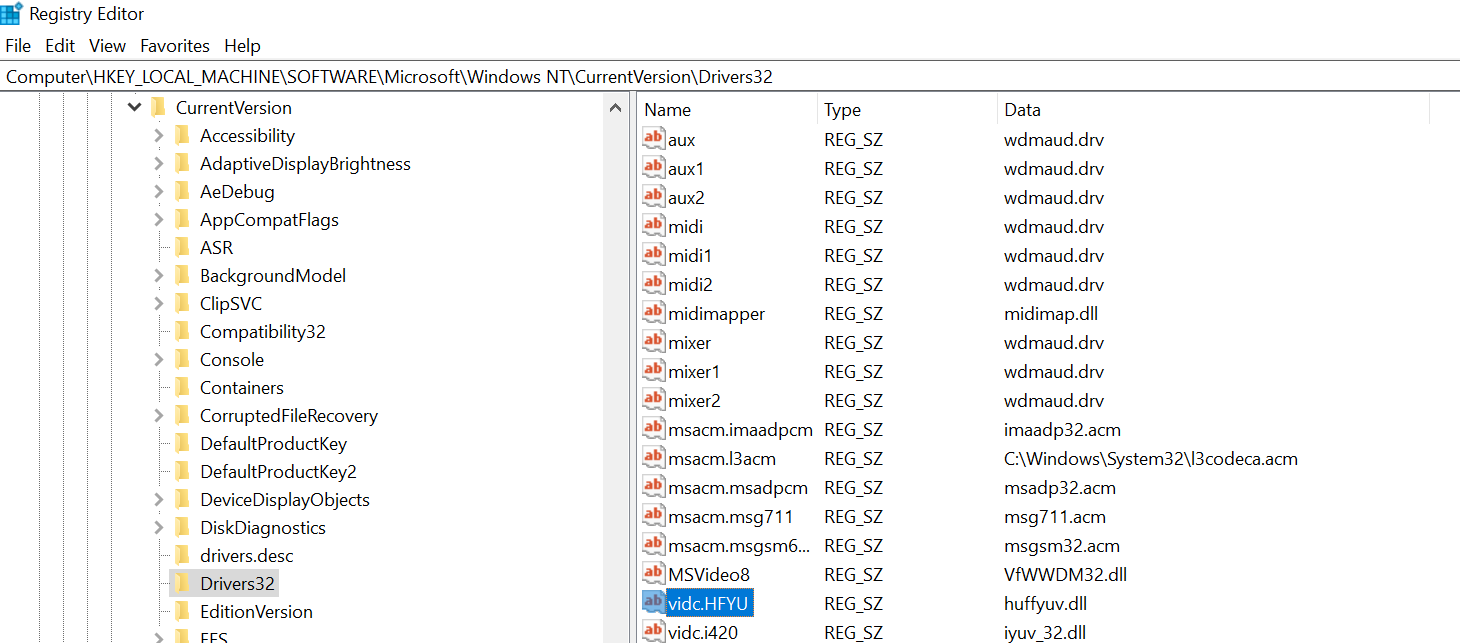

  20. Jagabo, I have been trying to run your script on my old laptop and have 2 questions to trouble you (or others with). I am playing around with the level() thanks to you and Sharc's advice and also removing horizontal sharpen to see what the impacts are and get a better understanding. I am running into trouble running the script.
    VirtualDub
    Video -> Fast Recompress
    Video -> Compression -> Huffyuv 2.1.1
    Audio -> Direct Stream Copy
    I get the error: Video format negotiation failed: use normal-recompress or full mode.
    If I do normal recompress or full mode, Virtual-Dub doesnt do the audio.

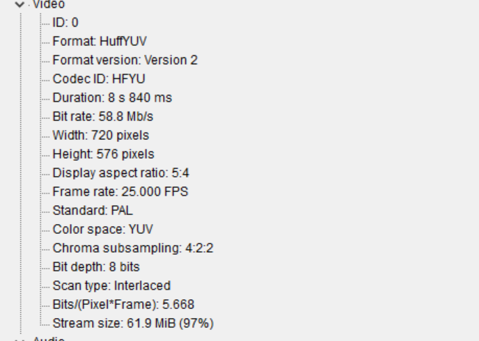

    It works when I use this instead of avisource()
    a = LWlibavAudioSource("Median.avi") # get the audio as the named stream "a"
    v = LWlibavVideoSource("Median.avi") # get the video as the named stream "v"
    AudioDub(v, a) # join video and audio streams together into a stream called "last
    I believe I have the Huffyuv VFW installed.
    [Attachment 73783 - Click to enlarge]
    Here is the media info for the file I ran the script on
    [Attachment 73784 - Click to enlarge]
    I have also re-attached the raw clip for reference.
    I am concerned that something is broken and I have no idea what it is.
  29. I can't reproduce your AviSource() issue. Works fine here. I suspect there must be something wrong with your installation.
    I see however a glitch at frame 6, (7) in your capture (which is independent of the source filter).
    Edit:
    And double-check your script: ConvertToYV12() should be on a new line IMO. It is not part of the QTGMC settings.
    (Maybe it's cosmetics only as Avisynth does not complain ....)

  30. Originally Posted by Sharc View Post
    Edit:
    Ok thanks Sharc, I think I might do a complete re-install of avisynth+ and see what happens.
    Maybe I need to remove and re-install Huffyuv as well.
    Anything else you'd recommend?
