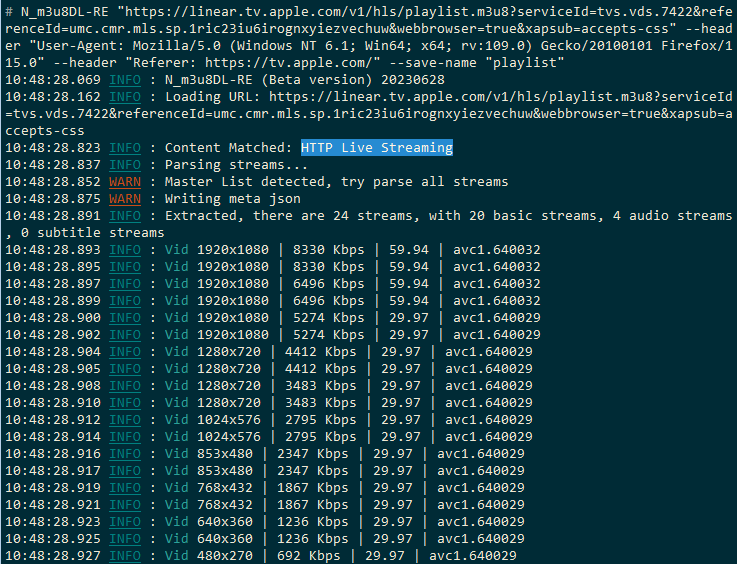

I'm using N_m3u8DL-RE.exe, I've tried with mp4decrypt (default) and with the --use-shaka-packager option too, without success
Also tried mp4box but getting:
[iso file] Error: moov not received before merging fragment
Error opening file playlist_es.ts: Invalid IsoMedia File
So for sure, the file is still encrypted but also without the proper header to try to decode it.

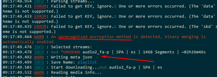

I know the script and I have used it for the non-live content and it works
But for this "live" the script doesn't even recognize the stream to try to decrypt it.
[Attachment 73490 - Click to enlarge]
So that's why I came here to ask if someone has a clue about this issue.

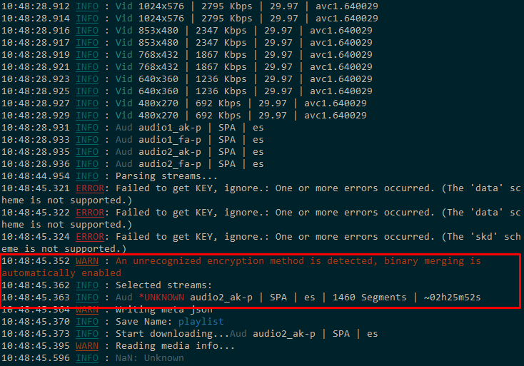

but if the stream is "unknown" and the encryption is "unknown" then the binary stream can't be properly handled to be identified (as video or audio) and later to be decrypted.
That's why I shared the screenshots for N_m3u8DL-RE without reaching the decrypt stage. My meaning was just to show the warning immediately detected about the unknown encryption method.

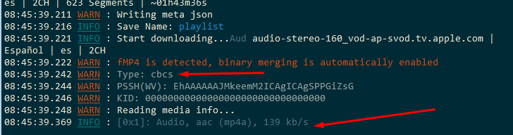

Now the link provided in the beginning jumps to a VOD server, for that reason now everything can be decrypted properly with the new KEYS under the VOD license server (that is different to the LIVE content license server)
And when it jumps to VOD, the encryption is clearly declared as CBCS, and the AUDIO/VIDEO Streams are also properly detected as it should be

Now the audio streams is properly detected as audio, and decrypted by the new KEY (l3)

And you can see, the Audio stream isn't properly detected as audio, and the encryption is "unknown"

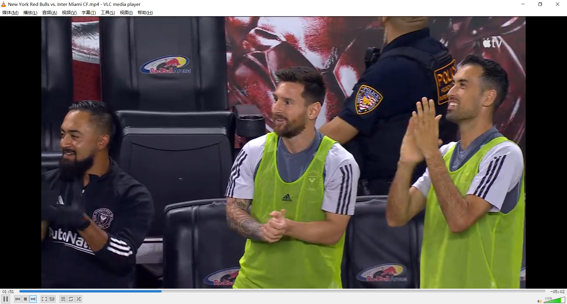

I used this key to decrypt the video I posted above.

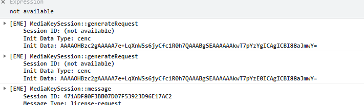

1) For the summary you also got 2 PSSH, right? (did you check the CONSOLE with EME logger, right? they are there)
[Attachment 73584 - Click to enlarge]
2) Which process you made to use the Video Key to decrypt the Summary Video stream? Did you decrypt with your key the video stream only? or with the same Key did you decrypted video+audio streams at the same time?
Thanks for your feedback and support.

Just because you can't make sense of what other people post, that doesn't invalidate their contributions when you're the one at fault. The key he posted is only for video track. So of course audio remains encrypted. The key he posted is also limited due to his L3 so of course video remains encrypted for 1080p. 720p works fine. For audio, the key posted by @bellower in post #14 works fine.
The only issue is that for some reason N_m3u8DL-RE can't decrypt both tracks at once. Just download separately and mux manually later.
You also should be careful when copying keys that aren't placed in code blocks. There are random spaces added in them.Code:N_m3u8DL-RE "https://play-edge.itunes.apple.com/WebObjects/MZPlayLocal.woa/hls/subscription/playlist.m3u8?cc=US&svcId=tvs.vds.7305&a=1704514688&isExternal=true&brandId=tvs.sbd.7000&id=616644329&l=en-US&aec=HD&webbrowser=true&xapsub=accepts-css" --key 0000000024c13ee96331342020202020:5cc7c369adfe64416b0f9d7f6a5c60c5 -sv res="720*":for=best -M format=mkv N_m3u8DL-RE "https://play-edge.itunes.apple.com/WebObjects/MZPlayLocal.woa/hls/subscription/playlist.m3u8?cc=US&svcId=tvs.vds.7305&a=1704514688&isExternal=true&brandId=tvs.sbd.7000&id=616644329&l=en-US&aec=HD&webbrowser=true&xapsub=accepts-css" --key 0000000024c13ee96336202020202020:275af31b2e1edba917431881645947e7 -sa best -M format=mkv
