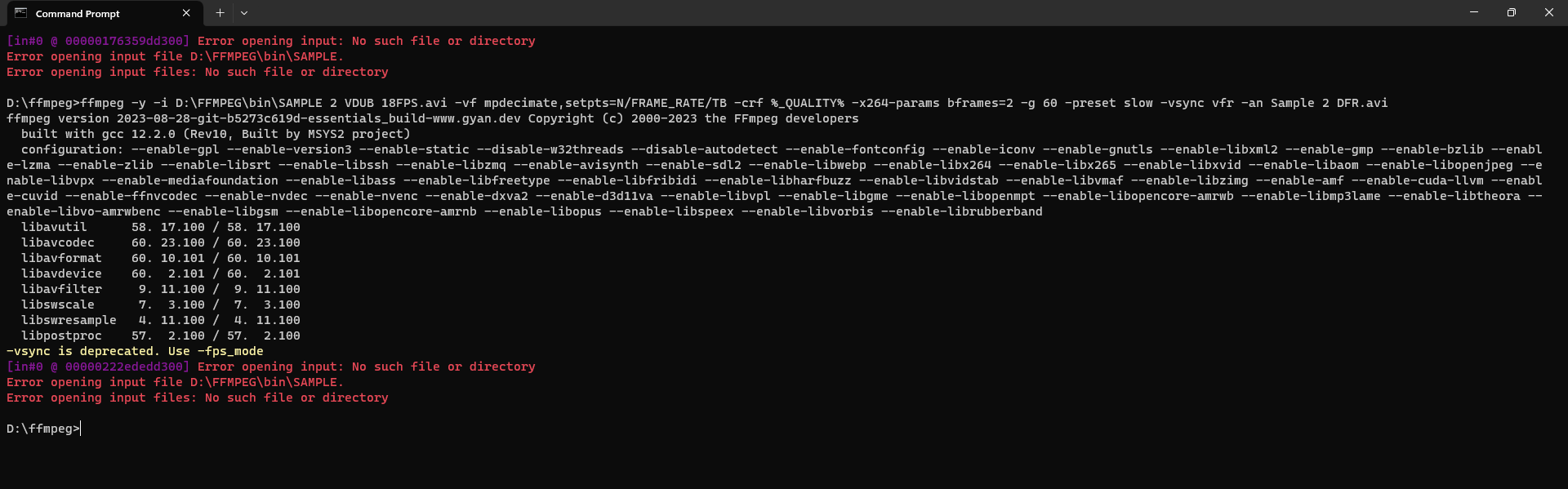

  13. I have tried to run ffmepg following instruction. I am getting error message. Please see screenshot.
    [Attachment 73506 - Click to enlarge]
  14. Since your path/file name has spaces it it you need to put it in quotes: "C:\FFMPEG\bin\SAMPLE 2 VDUB 18FPS.AVI".

    I was just about to say that! Anyway, since you appear to have ffmpeg working and added to the Windows PATH ? Here's a dropbox link to DFR.
