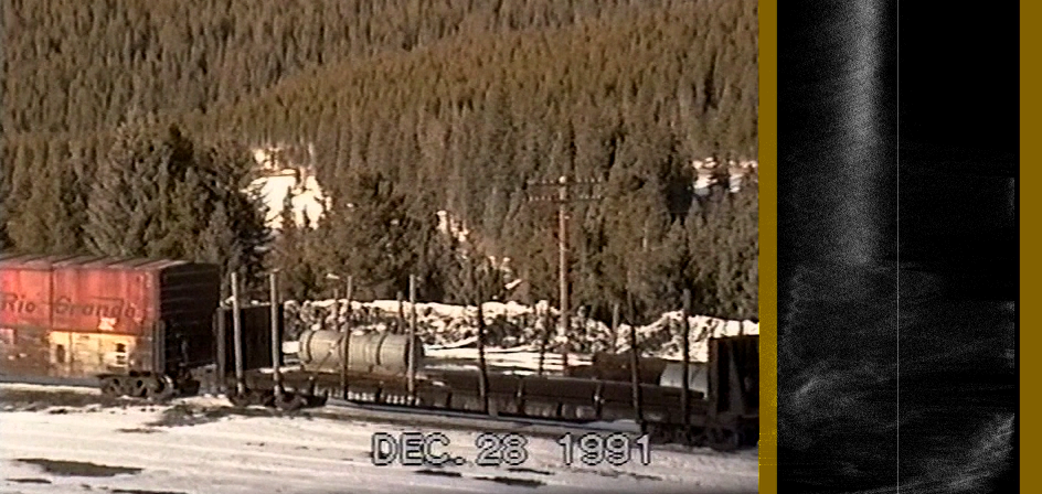

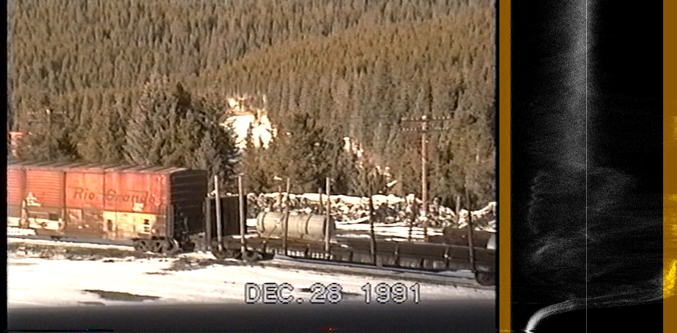

  17. Just try and see it:
    Waveform monitor:
    histogram("classic")
    Statistical historgram:
    histogram("levels")
    Also see the description in the avisynth wiki.
    http://avisynth.nl/index.php/Histogram
    General info about histogram, see:
    https://en.wikipedia.org/wiki/Histogram
    Bias of the histogram("levels"):
    Usually one is interested in the distribution of the luma values (means frequency of occurrence (=histogram) of the luma values) of the active picture.
    Black borders have nothing to do with the active picture, but unless they are cropped they will appear in the histogram as a peak at the corresponding luma level. In a normalized view this dominant peak will "push" the rest of the histogram down, hence biasing the histogram. Due to the "black" borders which are represented by a single luma value, this luma value of the borders appears statistically frequently, means more frequent than the remaining luma values of the "natural" active picture).
    Maybe a confusing and oversimplified explanation, so better just try it and see yourself, and remember basic statistics from college. Or perhaps a better teacher than me may chime in ......
    It is generally good and recommended practice to keep the luma values of 8bit YCbCr (YUV) video in the Y (=luma) range 16 ...... 235 for final distribution in order to avoid unnecessary surprises and trouble regarding color distortions and loss of details/gradients. Fine tuning is usually done in post processing.
    Added:
    Calibrating the "black level" of a video encode using your TV monitor's background as a reference can be misleading as the result depends on the TV settings (brightness, contrast, gamma).
    Added2:
    Now coming back to your captures:
    - The first picture is the S-video capture with the luma in the range (16<Y<235) which is perfect.
    - The second picture is the DV capture with elevated darks and brights. The brights go up to 255, and some structure in the bright ground below the red wagon is lost. The loss happens when the YUV of the DV's superwhites (even slightly clipped) is converted to RGB for viewing. As the clipping is very minor, the 'losses' can mostly be recovered with a levels adjustment (3rd picture).
