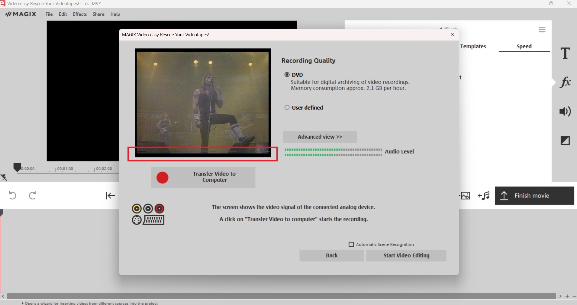

    *) How can I get rid of the noisy bottom of videos? Have tested many VHS with Magix Video Saver, all the same noisy thing.
    [Attachment 73380 - Click to enlarge]

    You just have to mask the frame or crop it and resize to a higher resolution, say 1440x1080. But you should be concerned about the jagged edges in the picture, looks really bad from that snapshot, I hope the actual video is not like that.
  3. Banned
    Nov 2022
    The noise on the bottom is head switching noise. You can crop the frame or mask it. But it is not your biggest problem - there are large blocks shifted horizontally. No idea what software are you using. Feel free to post a sample.
  4. The software that I use is Magix Video Saver and QWinFF.

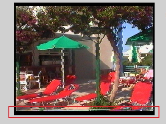

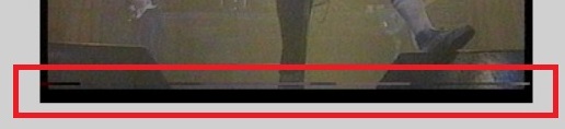

    Original VHS. PAL, 4+2 Heads: https://www.radiomuseum.org/r/panasonic_nv_hs950.html
    I can crop it, but I can't see the at the very bottom of the video if I could crop it.
    The VHS was only playinged from Magix, before converter, exposure and deinterlace.

  5. Member DB83's Avatar
    Jul 2007
    Well if you are cropping the area as indicated above, you will lose much more picture than you need to do. But head-switching noise is not typically shown how it appears in your sample. Normally a greyish bar with no active picture below it.
    Would also like to see a de-interlaced sample since, if your first picture is representative the de-interlacing selected the wrong field first. Mpeg2 can be both top-field first and bottom-field first although typically it is top-field first. Your sample is bottom-field first.
    The ultimate choice is yours. Either crop or mask the 'noise' or simply live with it.

  10. The head switching noise at the bottom of the frame is typical of VHS. You never saw it when watching on a CRT TV because TV's normally overcan -- you never say the outer ~5 percent of the frame. Even modern digital TVs often overscan to hide this sort of problem.
    https://www.videohelp.com/glossary?O#Overscan
    With a normal VHS deck it's usually much worse. The line TBC in your S-VHS deck (and maybe your DVD recorder too) is partially fixing it. But you never get a perfect result.
    You can "fix" it with an advanced editor that will replace that part of the picture with data interpolated from the lines above and below. That will look a little better. But why bother. It's not like there's anything important down there.

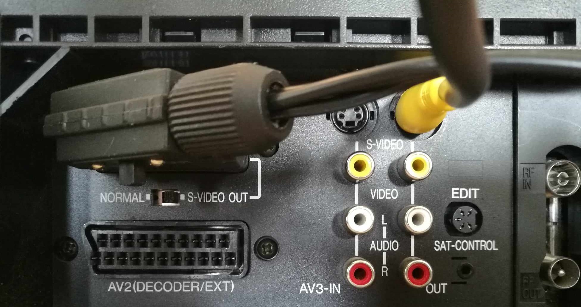

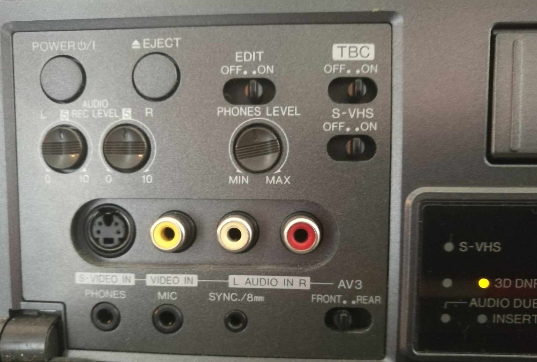

  27. Image
    [Attachment 73591 - Click to enlarge]
    Edit=ON, TBC=ON, S-VHS=ON and 3D DNR=ON on the right side
    [Attachment 73594 - Click to enlarge]
    S-Video Out (not Normal), and plugged on the S-Video

  29. Okay.
    I have TBC=On and Edit=On.
    Can I have S-VHS=ON and 3D DNR=ON on frontside, and S-Video Out (right below SCART) on backside, and possibly other settings on standard VHS? or it doesn't matter?
  30. Capturing Memories dellsam34's Avatar
    Jan 2016
    S-VHS ON/OFF selection is for recording only, If I remember correctly, S-VHS VCRs can record based on the selection of the switch and the type of tape being inserted, If S-VHS ON they record in S-VHS on a S-VHS cassette and in S-VHS ET on a VHS cassette, If the S-VHS is OFF they record in VHS on any cassette type.
