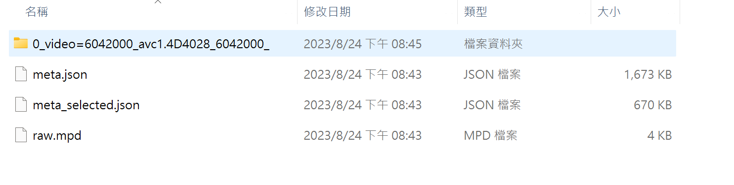

    Thank you for your quick replies. I tried the --skip-merge parameter, but it's still the same, can you tell me which parameter it is, I'm a rookie
    [Attachment 73378 - Click to enlarge]
    I only get these

    Can't remember I would have to look it up.
    N_m3u8DL-RE --help | grep segment

    okay I found it
    --check-segments-count false
