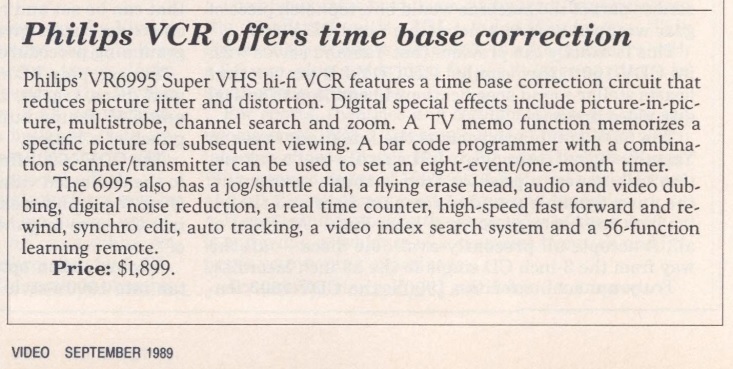

  2. Banned
    Nov 2022
    Here is one from 1989 for $1900, ouch.
Name:	philips vr6995.jpg

    Well, the Philips machine advertised it as the means to reduce jitter and distortion.

    From Video magazine, April 1990:
    Philips’ top VCR is a Super VHS model, the VR6995ATO1. ... The VCR has a large number of helpful and unusual features. Foremost is a time base corrector (TBC), which straightens out vertical lines made ragged by slight speed instabilities in the mechanical tape transport. TBCs are still extremely rare among consumer VCRs.
    Suggested price: $1,899
    I am posting these just to keep track of some VCR models with TBC, no need to respond.
