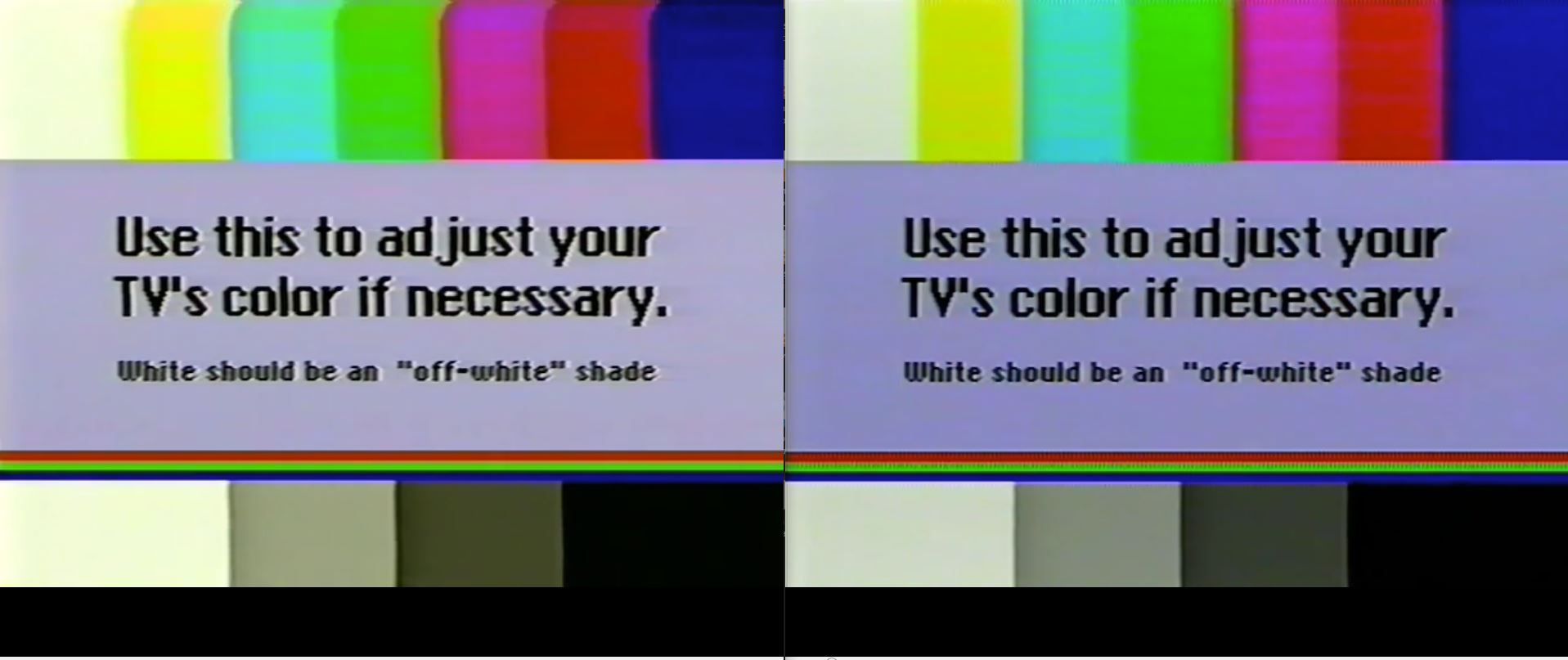

    I cant speak to the ES-15 specifically but the TBC's really do make a noticeable difference.
Name:	No TBC vs TBC.JPG
  14. The flagging is gone, but the dotcrawl (or hangning dots) of the composite video is even stronger (or perhaps just sharper). If there is a setting like "Comb filter ON/OFF" or similar, enable it.
    Generated test patterns have dot crawl embedded in some TBCs. The pattern was made badly. So always verify pattern vs. output. --- And this is a reason I don't overly rely or trust test patterns. Variables.

    Totally. And I find freeze frame comparisons are sometimes misleading insomuch that a steady stabilized image with some dot crawl may look better than an un-stabilized image that is moving all around.
