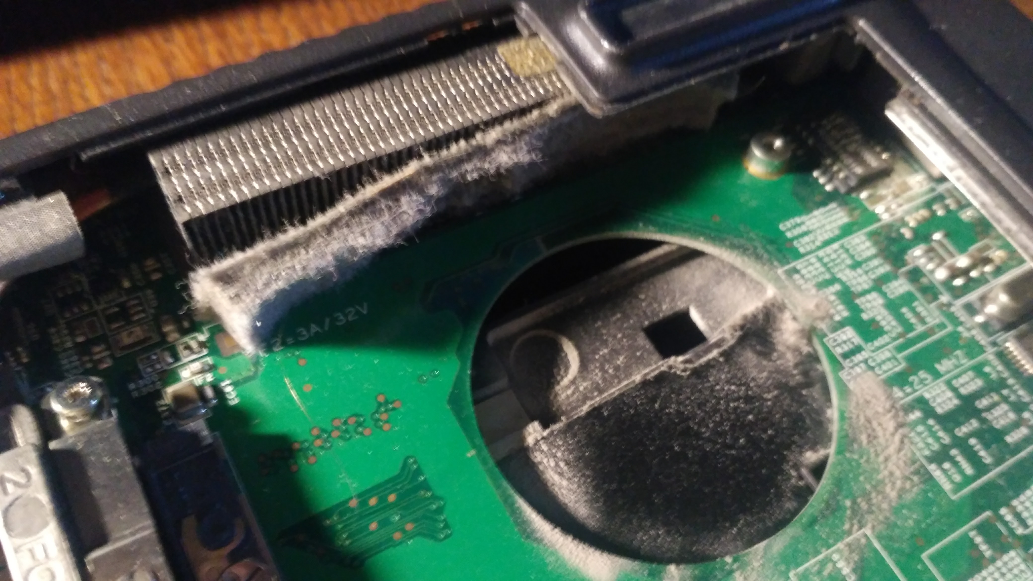

    I think when you open it, there will be a whole layer of dust like a fur coat. Plus, given the age, all thermal interfaces have long since dried out.
    Here is an example of a laptop that has not been cleaned for 5 years.
    [Attachment 73887 - Click to enlarge]
