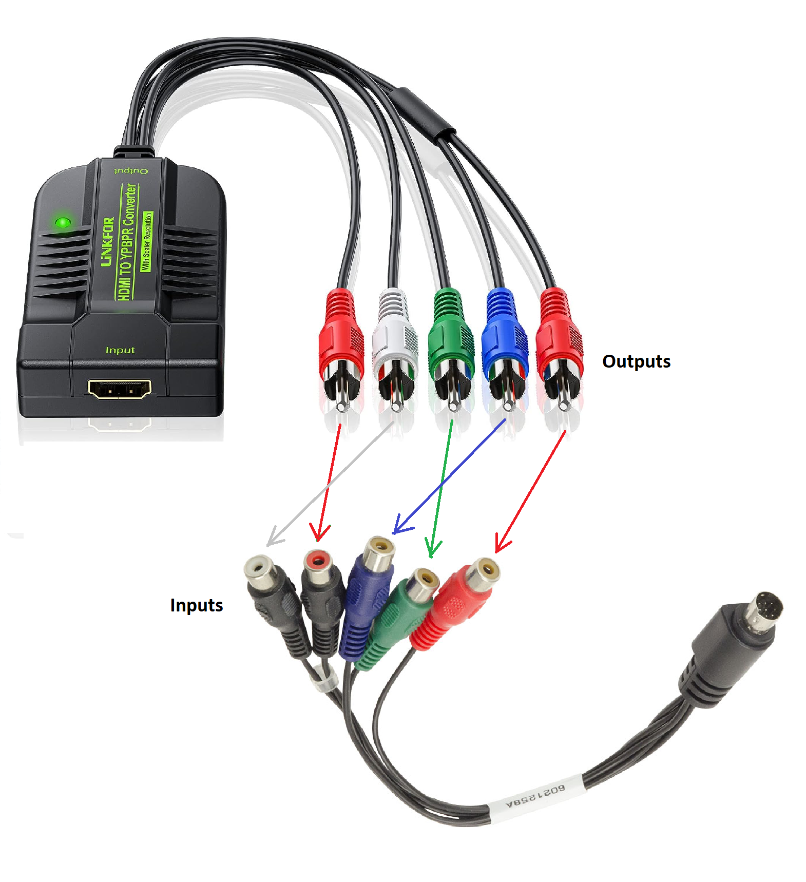

    I ordered this from Amazon. It’ll be here tomorrow. Planning to hook the HDMI cable from my Roku and put it in this device and then take the component ends and plug them into my Hauppauge HD PVR 2 Gaming Edition. Thing is I’m not sure how the audio is supposed to travel. My Capture device does have a digital audio input and so does my PC but my Roku I don’t think has one.
    LiNKFOR 1080P HDMI to Component Converter Scaler, HDMI Input to YPbPr Convert HDMI to Component, Only HDMI to YPbPr Adapter for HDTV Box PC PS3 Roku Blu-Ray DVD (NOT Component to HDMI) https://a.co/d/6BTcEBI
  2. The HDMI cable carries audio as well as video. The converter outputs stereo audio (two cables, red, white) as well as component video (three cables, red, green, blue). Your PVR2 has inputs (via a pigtail adapter) for all five of those.
    Here is what my Hauppauge looks like that I put into my Hauppauge.
    https://www.hauppauge.com/pages/webstore2/webstore_avcable-din_style.html
    Here’s the adapter I ordered to convert HDMI to component.
    LiNKFOR 1080P HDMI to Component Converter Scaler, HDMI Input to YPbPr Convert HDMI to Component, Only HDMI to YPbPr Adapter for HDTV Box PC PS3 Roku Blu-Ray DVD (NOT Component to HDMI) https://a.co/d/b6wNkw1
    I’m just confused when it comes to this stuff. I’m wanting to pull the audio and video from my source into these devices and have them show up on my capture program so that I can record both audio and video. I am just very confused.
  4. Connect the outputs of one device to the corresponding input of the next. Outputs are where signals come out of a device. Inputs are where signals go into a device. It's a simple as that.

    It's as easy as shown below, What problems are you having with the setup? any more details? I would suggest get a HDMI capture device and forget about analog component and audio, You will have to get one of those HDMI strippers to bypass HDCP protection, and it could be your problem too with your actual setup.
    [Attachment 73224 - Click to enlarge]
