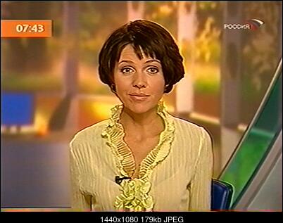

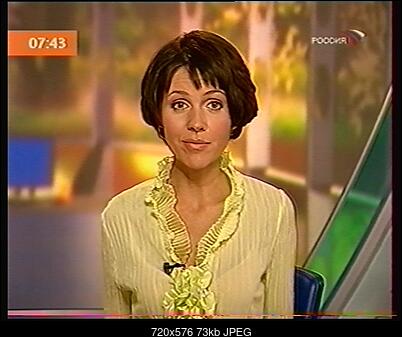

  1. I've noticed that my picture becomes slightly stretched once I resize it to 1440x1080. My primary goal is to upload captures to YouTube, so I've deinterlaced it, cropped it and then resized it. I used Sharc's post as a reference for cropping and dellsam34's post as a reference for the AviSynth script and rendering with ffmpeg (I wasn't aware of jagabo's corrections until after I've rendered the final MP4). My final script was as follows:
    AVISource("J:\Videos\VHS\BIGBOXTDK\985\985.avi")
    AssumeTFF()
    QTGMC(Preset="Fast")
    crop(12,2,-18,-10)
    LanczosResize(1440, 1080)
    Once the video was done rendering, I compared the two and noticed that the news anchor lady's face looks stretched compared to the original 720x576 capture.
ID:	73211 Click image for larger version
    Did I mess up the aspect ratio while cropping?
    Attached is the sample from the capture.
  2. Note that the display aspect (DAR) of your source wrong, it shouldn't be 5:4 DAR. The upscaled output output video has the correct DAR, 4:3.

  4. Originally Posted by jagabo View Post
    Yeah, I checked it in MPC and VLC. But why is that? Is it the player that's assuming it wrong or is it wrong in itself?
    What was your resolution before resizing?
    720x576 (690x564 after cropping before resizing), 25 fps PAL capture.
    Jan 2016
    Because a computer player display it as if it was square pixel, You can force MPC and VLC to display it in 4:3 it you want to, just change the frame aspect ratio setting.
    690/564 = 1.223, 704/576 = 1.222, All look good to me, Although you can crop more to get rid of the head switch if you want, the resizing to HD will smooth it out.
  6. Originally Posted by Sunk View Post
    PAL video capture uses a 720x576 frame to hold the 4:3 DAR video (actually the 4:3 DAR video is in a ~702x576 portion of that frame). Huffyuv AVI doesn't have a way of signaling the DAR or SAR of the video it contains. So you get a DAR that matches the frame dimensions (5:4). It's up to you to keep track of the SAR/DAR and encode properly.
    Last edited by jagabo; 16th Aug 2023 at 13:46. Reason: Corrected 702x567 to 702x576
