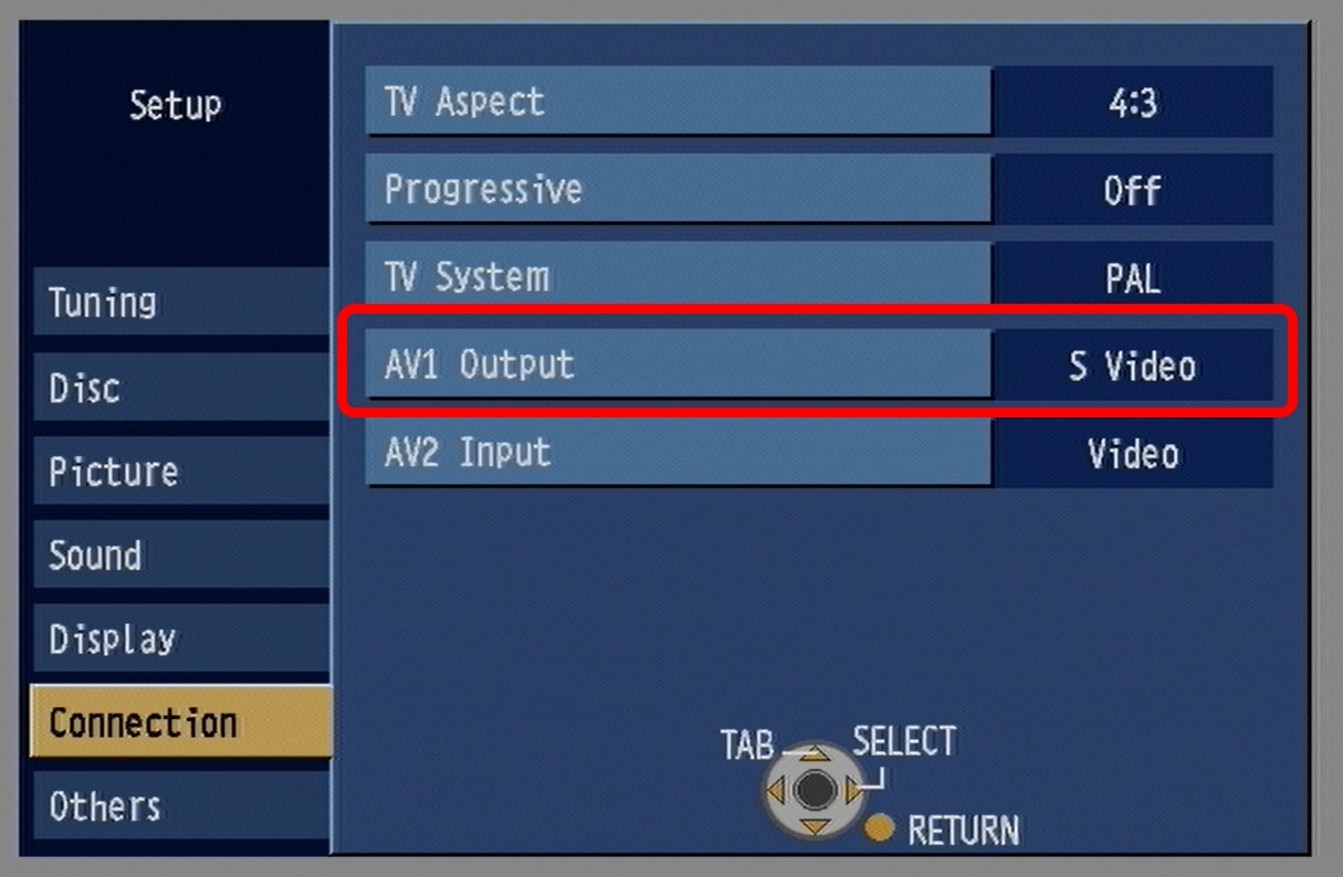

    i have an S10 s15 and S20 and they are changing the brightness of orginal signal from VCR (very white on white sposts)
    i stopped using them..
    but... WHAT MEAN by: AV1 Output > S-Video (for use with a Scart adapter)
    take the S-Video output and "convert" to a scart?
    or use a SCART to S-VIDEO on AV1?
    very thank you for any explanation.
  7. Member The_Doman's Avatar
    Feb 2004
    Netherlands
    It means configuring the AV1 SCART output of the recorders for S-Video output and using a SCART to S-Video cable or SCART adapter.
    SCART to S-Video adapters/cables only route the signal pins to the different connectors/pins, they do not convert the video signal.
    The European recorders can bet set to input/output RGB, Composite or S-Video over the SCART connectors.
    But not all at the same time.
    Google: SCART pinout S-Video
    May 2005
    Australia-PAL Land
    Yes. Functions button>To Others>Setup>"Connection", select AV1 Output to S-Video.
    [Attachment 86937 - Click to enlarge]
    Then, use a SCART plug on AV1 and take the S-Video from the SCART plug.
