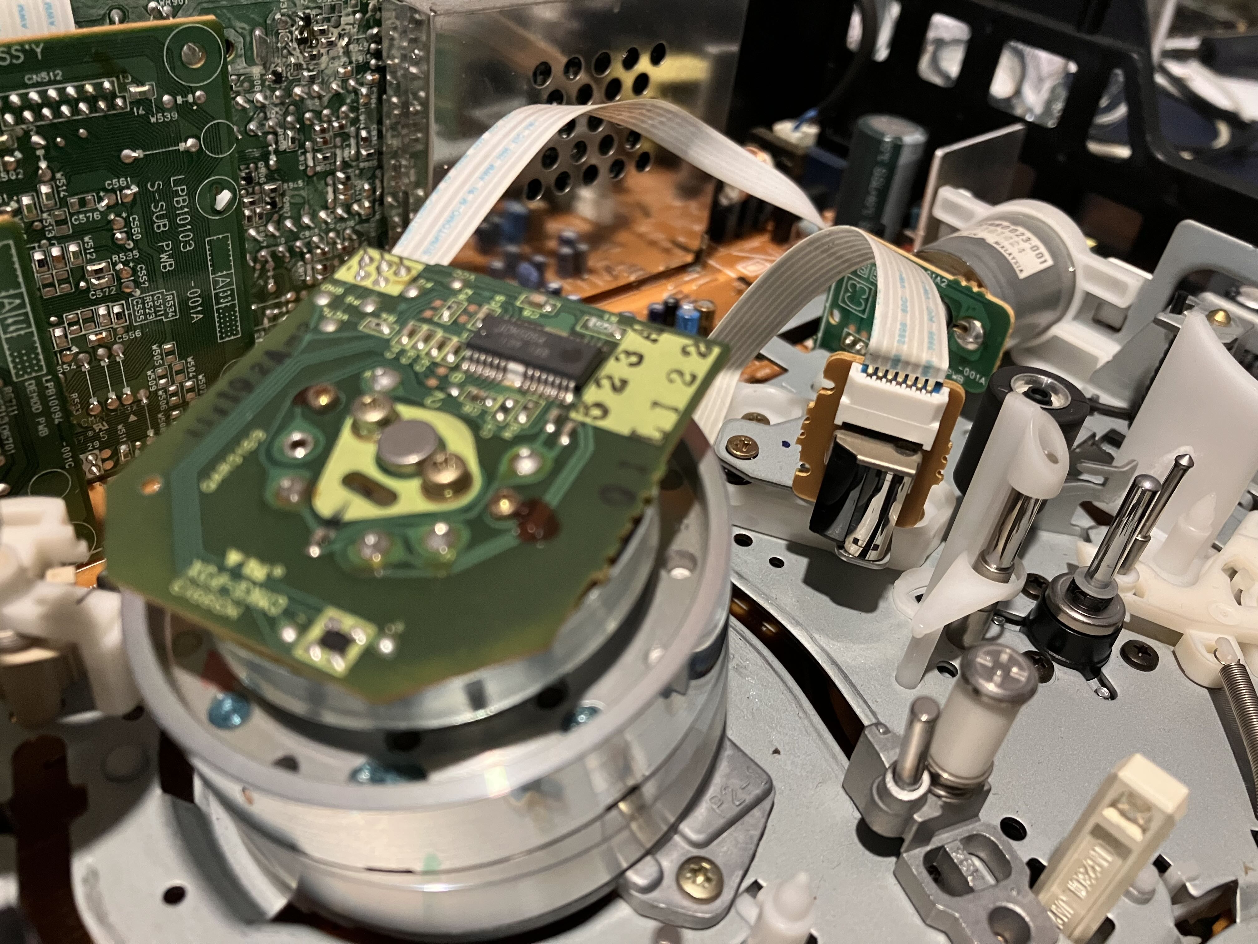

That does sound like the machine is struggling to read the tracking signal properly, that will cause the head drum to not be in sync with the video on tape properly and drift in and out. It's possible the alignment of the audio/control head in the Sony just matches the tape better than the JVC or worse it's actually misaligned in the JVC which ends up being enough to throw it off on some tapes.

Yes about the sync issue. I forgot to mention the time code on the JVC player completely stops too while playing.

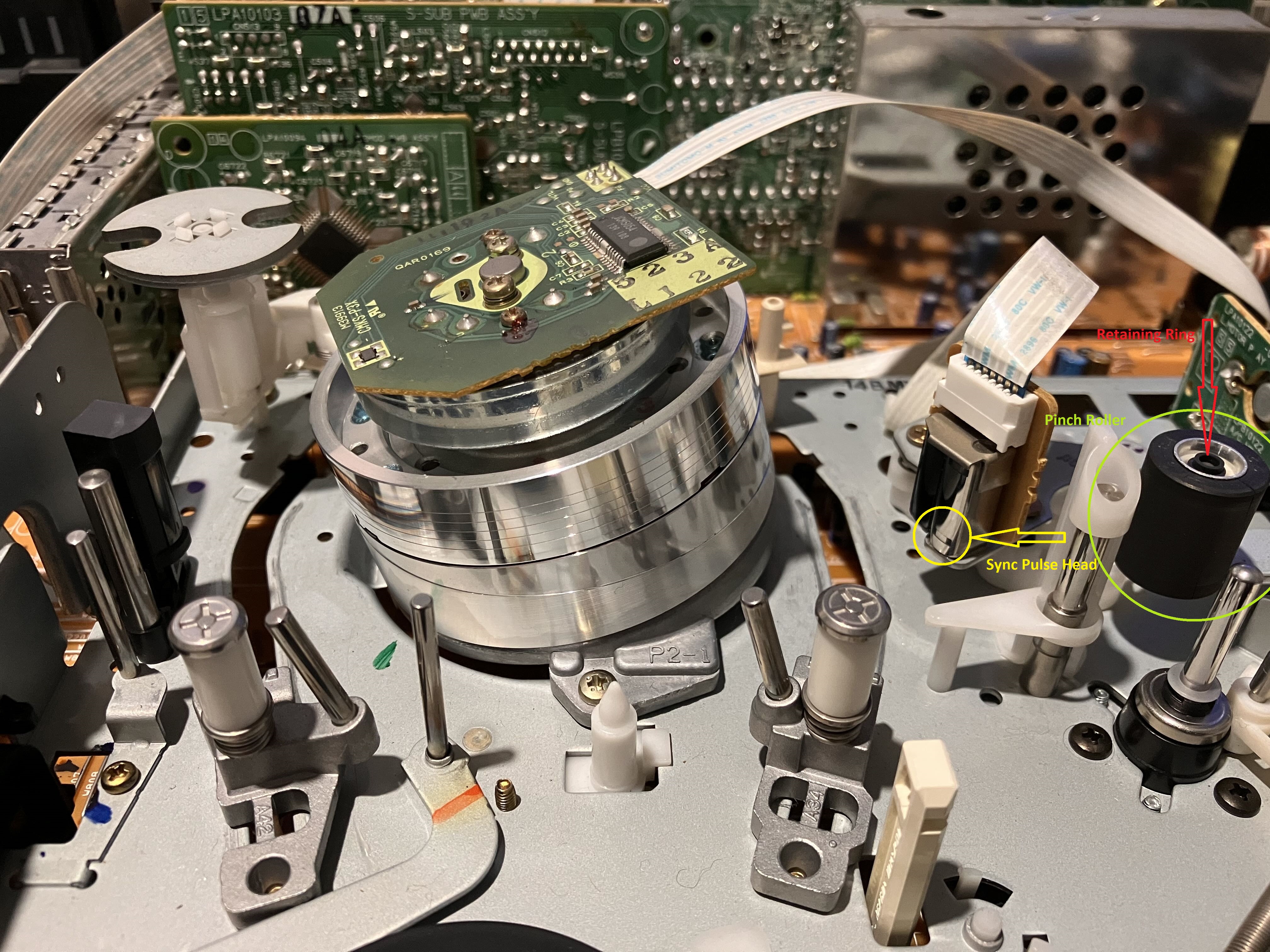

If the time code stops that means the sync pulse head is either dirty, has a loose connection or miss aligned, You should check it, It's on the right side of the drum close to the pinch roller, There is stationary head that has audio on top and synch pulse head at the bottom.
Thankyou, I'll see if I can have a look at that. I think I've seen the audio head - looks much like a cassette player head only bigger. So shouldn't be hard to find.

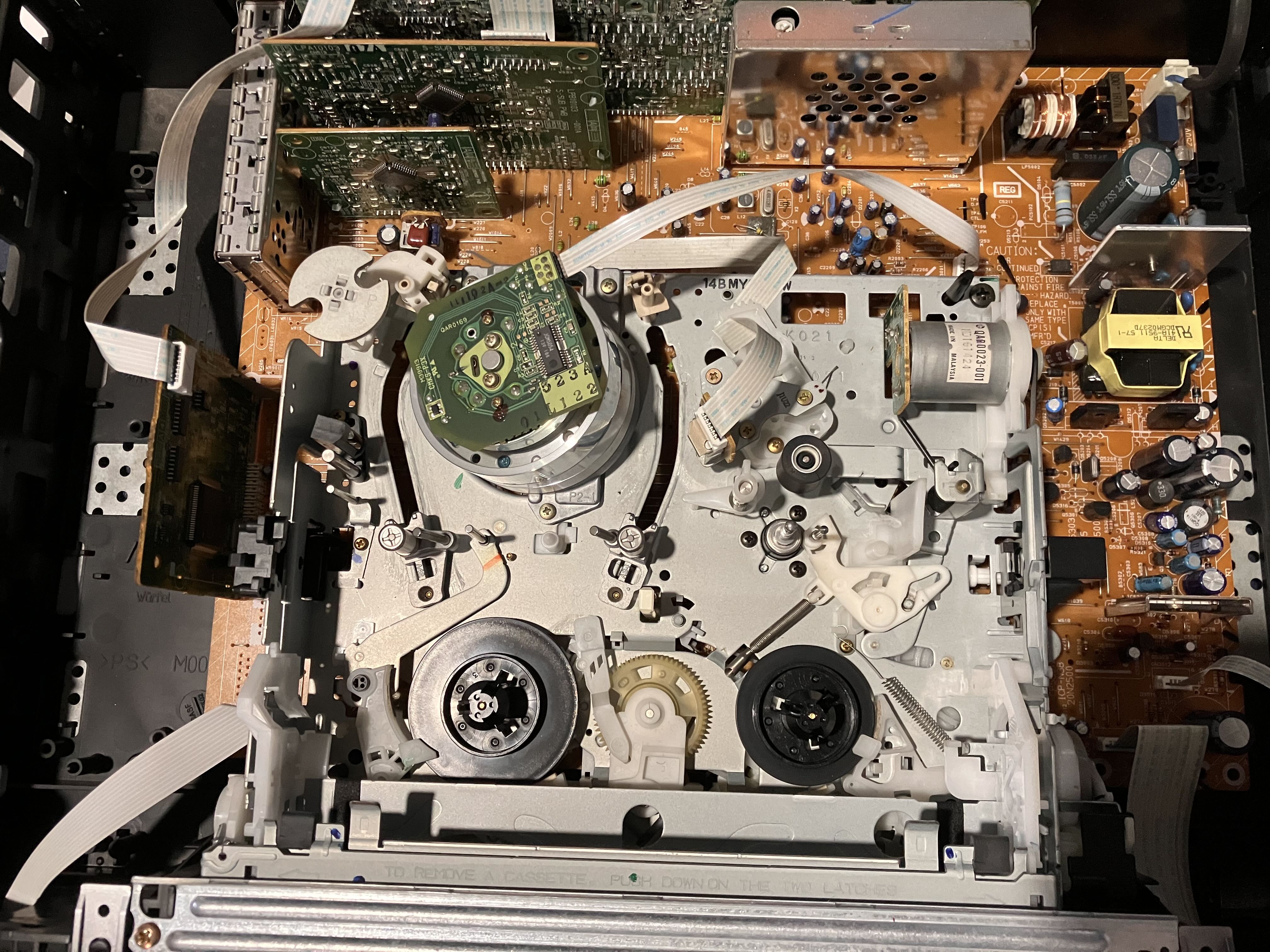

So I had a look inside. But I'm just going to add, that so far it seems it's all the older tapes that it's having the issue with. The newer ones all play fine. The older ones are not recorded on any single recorder, some of them home movies even some pre-recorded / purchased tapes that are doing it - all older. It isn't a mould problem which would be less cyclic anyway - and those tapes I am cleaning first before playing.
So on my deck - I don't think it has what you're describing, not under the audio head anyway.

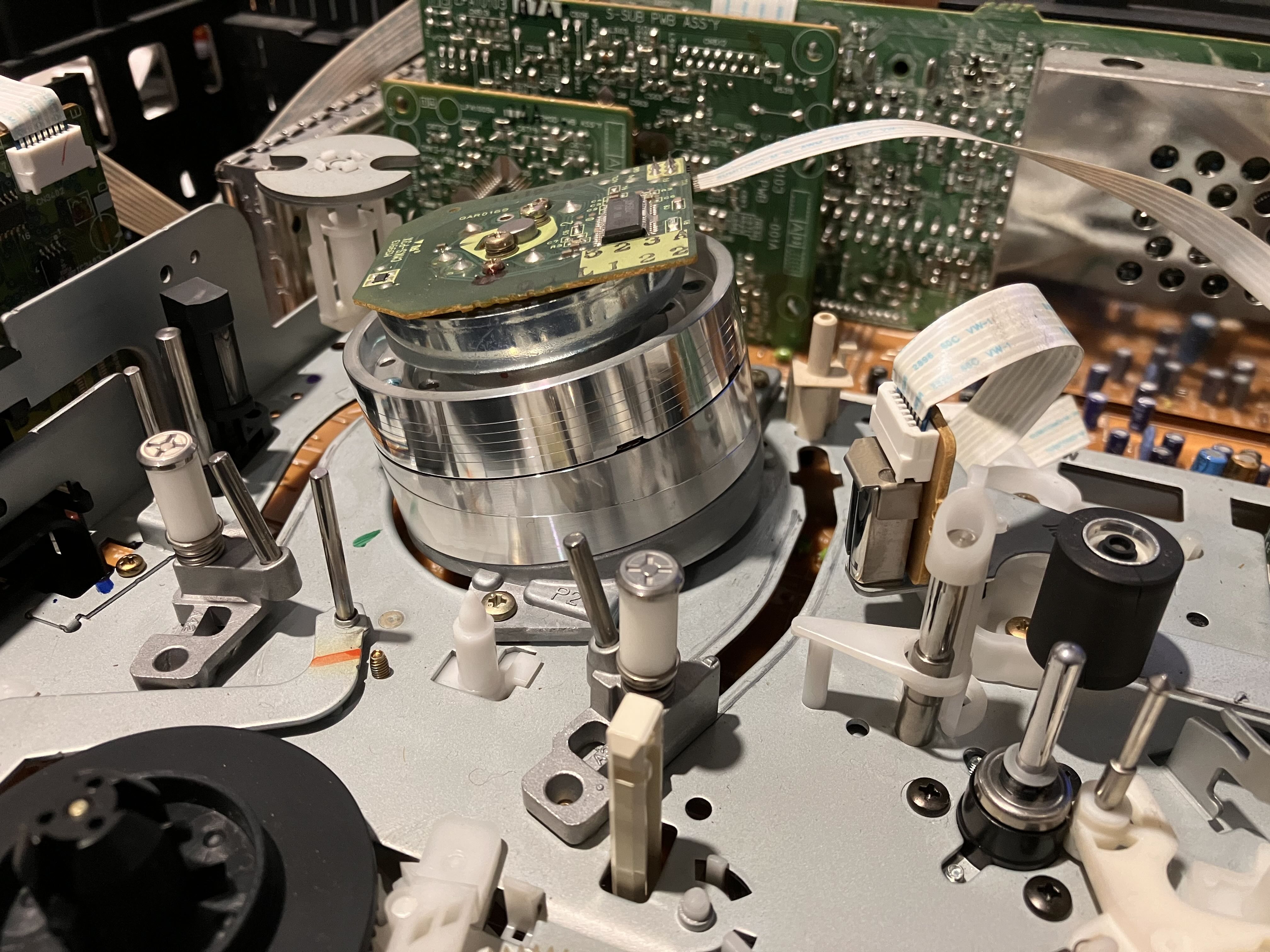

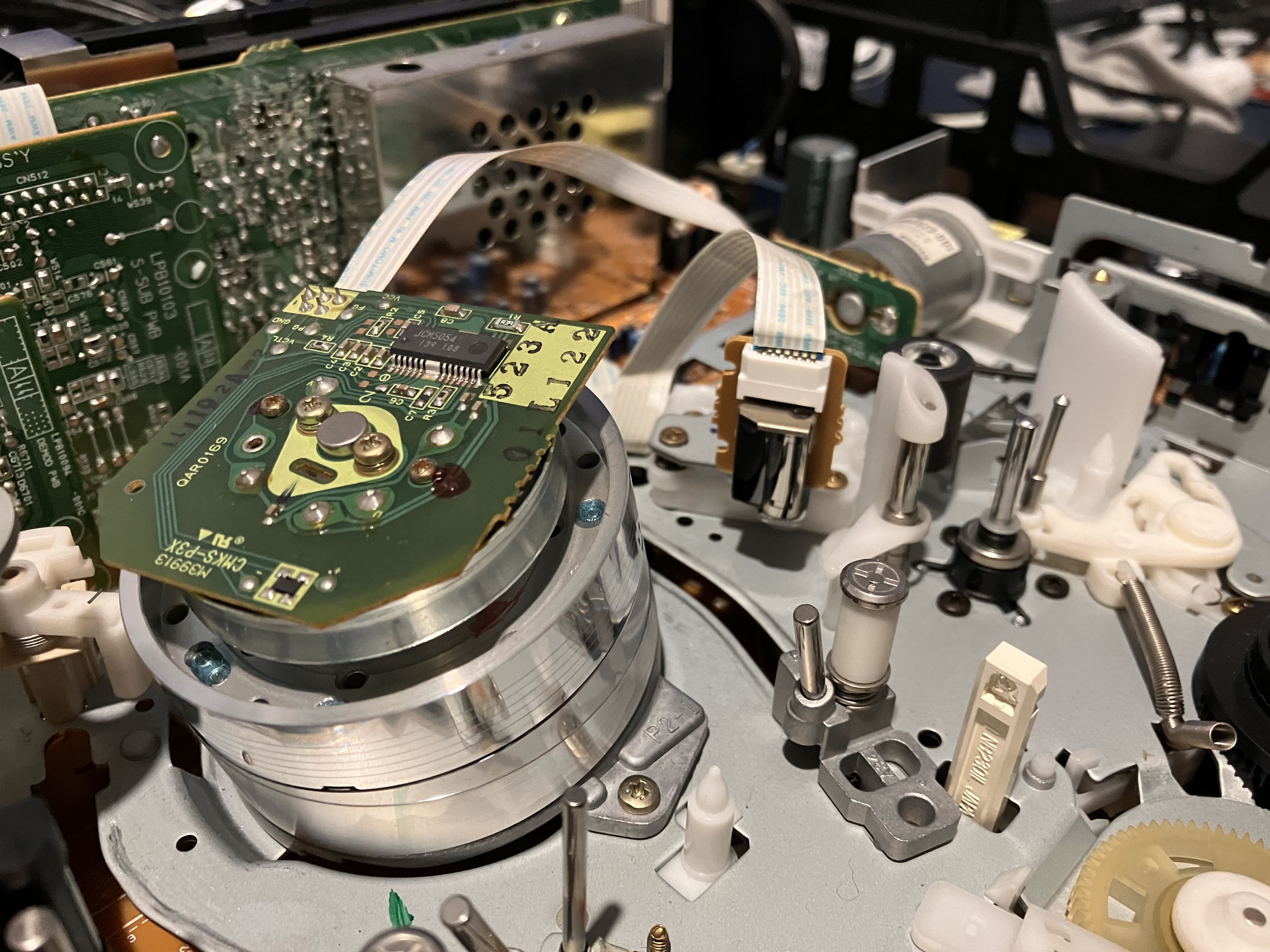

Here are a few pictures.

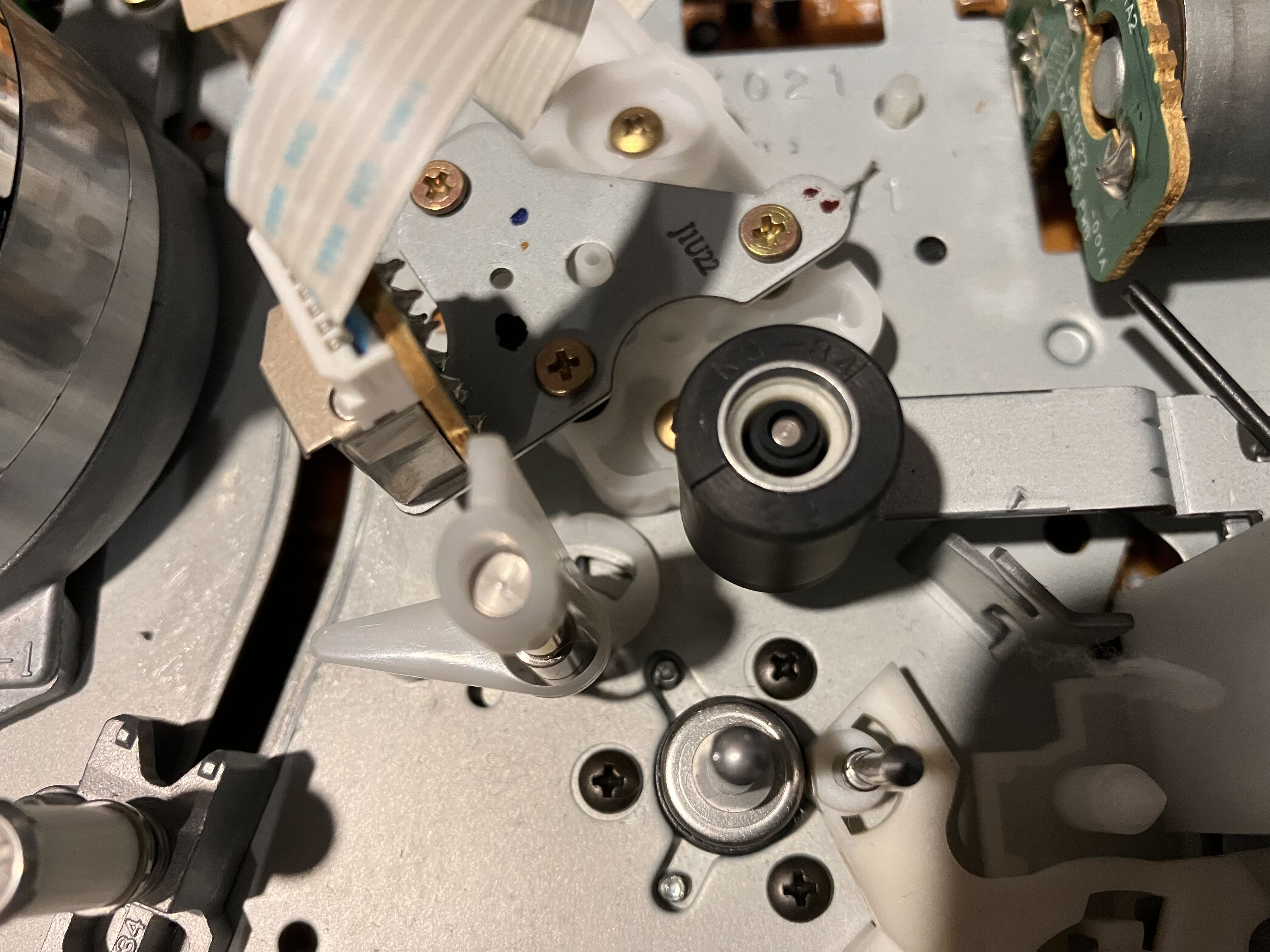

I was a bit disappointed to see that split in the rubber capstan is it called? Hopefully I can just buy another one if it becomes a problem. I thought this VCRShop was meant to be the premium place that gave a full inspection and service beforehand, I also notice there's a bit of dust inside, which makes me wonder if they even bothered to open it or if it's just an ebay model forwarded on. Perhaps I'm being unfair.
I checked the cable going into what I assume is the audio head, and it was well connected. I am somewhat pondering your comment because this age of video will all be using the separate audio method I assume, rather than the helical scan embeded audio, which I read about recently. Possibly a coincidence and all the audio works anyway.

That is called the pinch roller, Looking at its condition it could well be the culprit, It needs to be replaced a.s.a.p, it could be lifting up or pushing down the tape while playing which causes the tape to skew off the tape path and miss the sync pulse head and could also lead to tape edge damage (curly edge tape syndrome), While in there try to clean the head anyway with alcohol and cotton swab.
As a troubleshooting step try to remove and reinstall the pinch roller upside down, You first need to remove the plastic black retaining ring from the pinch roller shaft, flip over the pinch roller and put the ring back by pushing down slightly until it seats, and play some tapes and see what changes and report back.

Ok thanks very much for the info! Do you think it is just coincidence then that some tapes work fine?
Since it's from vcrshop I would rather contact them about the split pinch roller and possibly misaligned audio head before messing with it on your own.
Again, you have to do some tests, there is no coincidence, Every thing has a cause.
I'm not aware that VCRshop restore the stuff they sell, so it is no surprise to find it non functioning at all. Fully restored units are only sold by individuals who are committed to their hobby and that often costs a lot of money. -
I don't think it's a coincidence that some tapes work and some don't. If the alignment is a little off it might not be off enough to miss the signal on all tapes due to signal strength on tape or due to how the alignment is on the recording compared to the vcr.
You are not the only person to have noted some off alignement on JVCs here either, so it might be a common thing on jvcs of this era rather than something specific that happen to your unit (linear audio and control track head is on the same post hence alignment of both are linked). It is something that can be tweaked if that's the main problem. The split pinch roller is not normal though and not something that can be fixed without replacing it and I would consider complaining about to the seller before touching anything inside the vcr.
