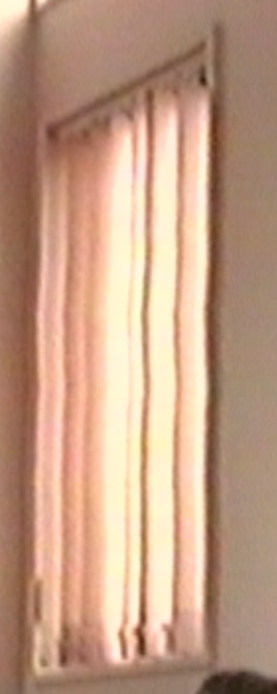

  20. Originally Posted by Brad View Post
    In terms of checking how well your ADVC-100 is handling tape wiggles, the best material is a steady shot of something with black-and-white vertical-running lines (bright lamp posts against a dark background, large letters "I" and "T", etc.).
    Just a basic screenshot - there were a few places where I could clearly see things are not straight. I've only done this one video through the ADVC-100 so far, but in a few places there are very clearly non straight vertical lines. Once I actually get a TBC and have my new S-VHS player arrive, I'll be able to do some better testing. I'd also add that this is the absolute newest of the VHS tapes I have, taken around 1998 or perhaps 1999 on a much newer recorder. I assume therefore others may be worse.
    So I think this absolutely confirms that the ADVC-100 does not have any kind of TBC - even though I know others have said that clearly, these rumours do still persist!
Name:	Screenshot 2023-08-19 at 15.47.38.png

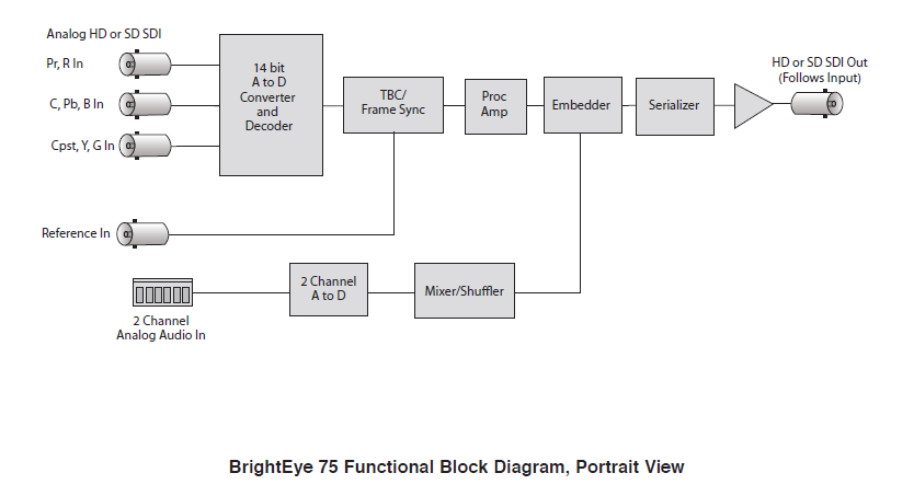

    The frame synchronization is handled by the software, it makes sure the incoming stream from the capture card will have the right frame rate and synced to the audio, if not it will drop or add frames to get a perfect synchronization, The better the VCR and tapes the less work the frame TBC and frame sync have to do.
    Attached is a block diagram of the device that you use. Notice, that TBC and Frame Synchronizer are parts of the video chain, while the audio is mixed in later, in the embedder. How does this block diagram agree with your definition of frame synchronization?
    Here the full description from the manual. Have you read it?
    As shown in the functional block diagram below, analog video is converted at 14 bits of resolution and digitally decoded to YCrCb components (601). The signal is then time base corrected and frame synchronized to the reference input. Proc amp adjustments are provided for the converted video.
    The audio is converted to digital and then passes through the built-in 2-channel mixer with shuffle and level control.
    The video and audio signals are joined in the embedder. This embedded signal passes through a serializer to an SDI output on the rear of the unit.
    the TBC in the block diagram, does it's work without anything on the (BNC) reference input ?
  26. Banned
    Nov 2022
    Originally Posted by lollo View Post
    Originally Posted by Bwaak View Post
    The question is about methods not results.
    The (original) question, was how to obtain quality capture in post #1: "How much good is it going to do me if the tapes are of fairly decent quality?"
    I indicate the method to achieve good results in post #4: "Even for tape in pristine quality you need a S-VHS player with TBC/N.R. to get the best out of them. And you may also need an external frame TBC if the conditions of the tapes are not that good."
    That's all that was needed.
    That would be all that was needed if you could explain what frame TBC was Since you have declined the explanation, this simple task turns into a quest akin to "Go I Know Not Whither and Fetch I Know Not What".
    The external reference is for studio environment where multiple sources are used at the same time, If no reference input it switches to its internal clock.

    I am not arguing to make a point for the sake of making a point. I expect people who use certain tools and recommend similar, as they think, tools to solve similar problems to understand their functionality and use standard terminology so that one could research similar tools on their own.
    This is from BrightEye 75 user manual, again.
    Frame Sync
    A Frame Synchronizer is used to synchronize the timing of a video signal to coincide with a timing reference (usually a color black signal that is distributed throughout a facility). The synchronizer accomplishes this by writing the incoming video into a frame buffer memory under the timing direction of the sync information contained in that video. Simultaneously the memory is being read back by a timing system that is genlocked to a house reference. As a result, the timing or alignment of the video frame can be adjusted so that the scan of the upper left corner of the image is happening simultaneously on all sources. This is a requirement for both analog and digital systems in order to perform video effects or switch glitch-free in a router.
    So, please stop perpetuating a non-standard definition of frame synchronizer if you come here to help people.
    BrightEye 75 is not a mythical "frame TBC", it is a combination of TBC + frame synchronizer.
