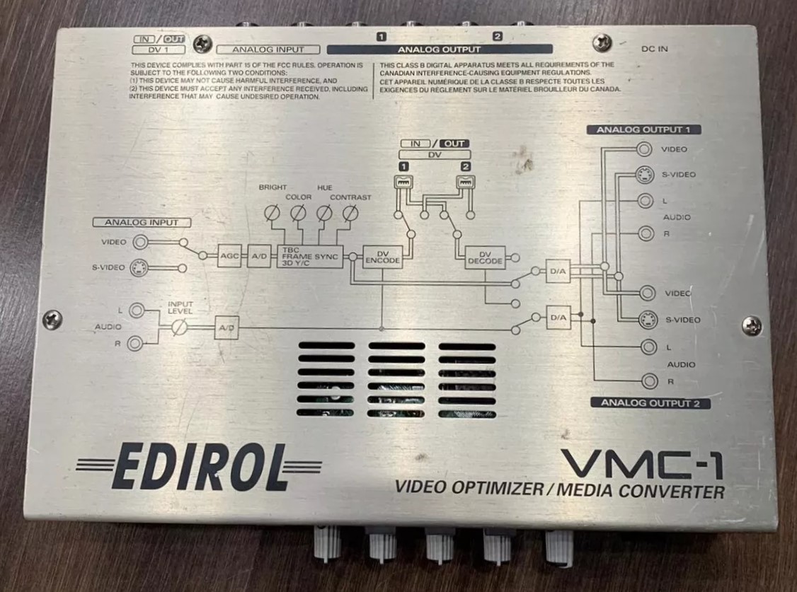

  18. Capturing Memories dellsam34's Avatar
    Jan 2016
    Originally Posted by Marshalleq View Post
    So only thing is, I'm actually not capturing to DV on the software side, so I assume what @lollo means is that the ADVC-100 has an internal DV codec that can't be bypassed?
    Not true, among the few devices I've known such as the Edirol VMC-1 and Canopus ADVC-300 and based on their circuit diagram, The analog to analog passthrough does not involve DV, The DV CODEC (Encode/Decode) chip is the last link in the chain that feeds the IEEE1394 socket for in/out communication. The signal path goes like this: Analog in -> ADC -> digital processing (TBC, Proc. Amp, 3D Y-C) -> from here one branch goes to a DAC for analog output, another branch goes to the DV chip for DV out.
    DB83 a UK member here had used the ADVC-300 in analog-analog passthrough and posted samples before, Whether it works like one of the suggested DVD recorders or not, that I cannot confirm.
    Not sure if the ADVC-100 is the same way in terms of having the analog output branches off the DAC or from a low cost distribution amp mirrored to the input, This is the concern, not the DV chip. If it's mirrored to the input for monitoring purposes, that means there is no digital processing.
    Here is what the VMC-1 signal path look like:
    [Attachment 73202 - Click to enlarge]

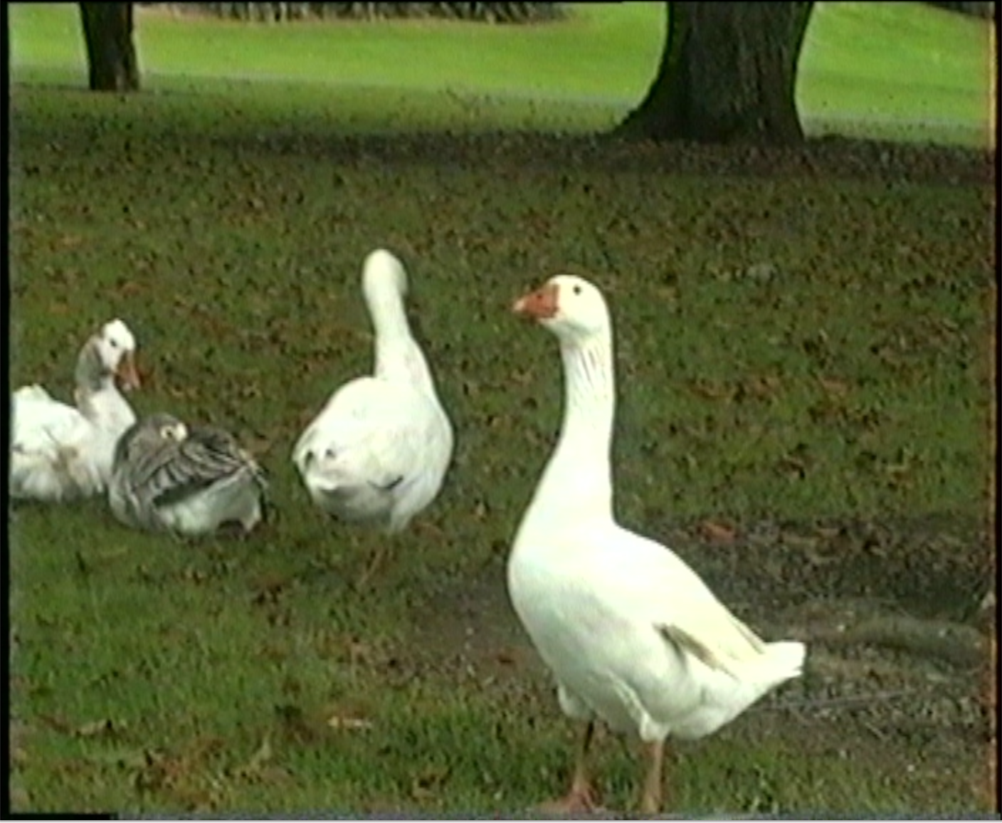

  23. Yeah, this is what worries me the most, diminishing returns. I am happy to do some samples. I was intending to do that anyway - I have my original captures, then can do with the ADVC unit, then I can do with the S-VHS unit on top, with the ADVC unit, then maybe I might get an external TBC. I'm not feeling rich at the moment - but if I think it'll make a lot of difference I'll probably do it.
    The tape I've been working with was recorded on my uncles VHS-C recorder only a year or two before I purchased a Mini-DV recorder, point being, it was probably one of the newer models. Many of my other tapes are from the eighties, recorded on an old Panasonic separates system where the VHS tape was in a shoulder bag. Unbelievably, I saw one of these for sale this week at an old camera store on my street. But as I understand it, the older eighties units used some kind of line based system and some of the newer ones used a different, maybe it was wave based system.
    So I will have to provide both I suppose. How is that typically done around here - we just link to some external site somewhere?
    But for the impatient, here's a screenshot taken of some very boring geese in the video at 100%.Image
    [Attachment 73247 - Click to enlarge]
    I assume just playing it, leaving it at original size and screenshotting it is fairly accurate, but perhaps I should use a capture in the tool - which doesn't seem to exist for VLC.
    They are all more or less the same, from 1976 to 2016. VHS tapes can be played on SVHS machines. SVHS tapes cannot be played on regular VHS machines, but can be played on an SQPB VHS machine. Not all VHS machines that can play SVHS are marked with SQPB moniker. You may be confusing domestic systems with professional ones like Betacam/BetacamSP and M/MII.
    Judging by the straight left edge, looks pretty good to me.
