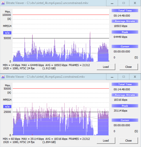

  6. You can use --vbv-maxrate and --vbv-bufsize to limit bitrate peaks.
    --vbv-maxrate 23000 --vbv-bufsiz 23000

  8. Here's a 1080p24 video compressed with x264 at 18500 kbps. Unconstrained bitrate on the top, constrained by --vbv-maxrate 23000 --vbv-bufsiz 23000 on the bottom:
    [Attachment 73163 - Click to enlarge]
    Note the difference in scaling on the vertical axis.
    The buffer is always larger than the bitrate when viewing the information. When the bitrate is displayed as around 16,186/18,321kb/s (avg/cur) the buffer size says about 39,332KB. Should I really make them identical in the settings, or should I allow a slightly larger buffer?
    If you constrained it to 23,000 why did it get up to 35,114?
    Could you explain how to read that a bit, please?
    I see blue, then purple on top, a red mark, and a gray horizontal line moving up and down across it all.
    I figured out what the red mark at the bottom is //Where it peaks//, but whats with the blue and purple colors?
    Is that bitrate and buffer sizes?

  12. Originally Posted by killerteengohan View Post
    Attached the Help for the BitrateViewer.
    And see the explanations in this YT video from 4:40 onwards:

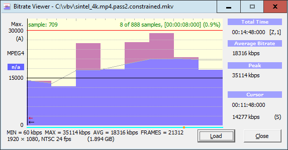

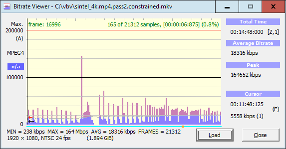

    The reason you are seeing bitrate peaks higher than the vbv specified values has to do with how different programs measure bitrate. The Bitrate Viewer images I posted were in "second" mode. Each bar in the graph represents the bitrate over one second of video. For a 24 fps video the first bar represents the average bitrate of frames 0 to 23, the next frame 24 to 47, etc. Bitrate Viewer also has a "frame" mode where each bar represents the bitrate of one frame. So the first bar is the size of the first frame multiplied by 24 (the duration of that frame is 1/24 second but bitrate is expressed as kbits per second so for the duration of that frame the bitrate is 24 times that size of that frame). The second bar is the size of frame 1 multiplied by 24. Etc.
    Second based bitrate:
    [Attachment 73209 - Click to enlarge]
    The same portion of the video with frame based bitrate:
    [Attachment 73210 - Click to enlarge]
    So you can see how these two different methods of measuring bitrate show a vastly different max bitrate over that section of the video.
