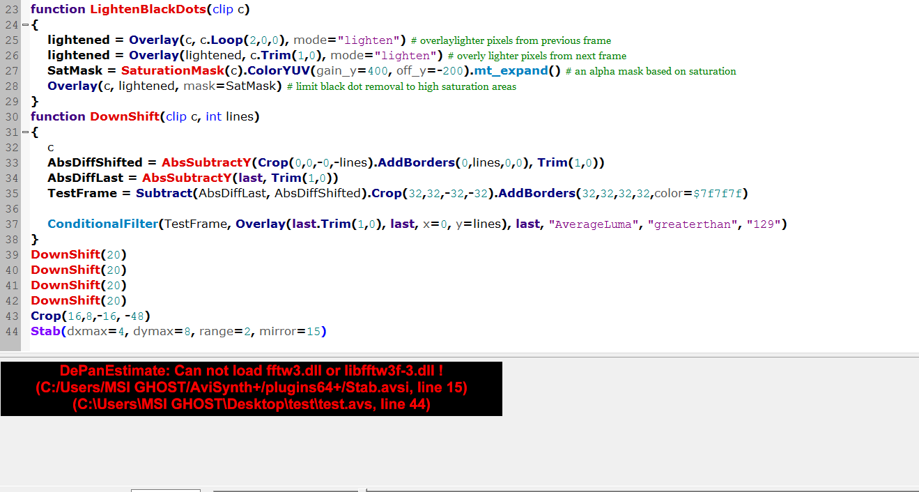

    Hello big friend,
    I've been studying Avisyth, and I'm finally able to process the command lines of your Script.
    However, when I try to run the Stab filter, the following error appears in the attached photo, could you help me please?
Name:	Stab error.png
