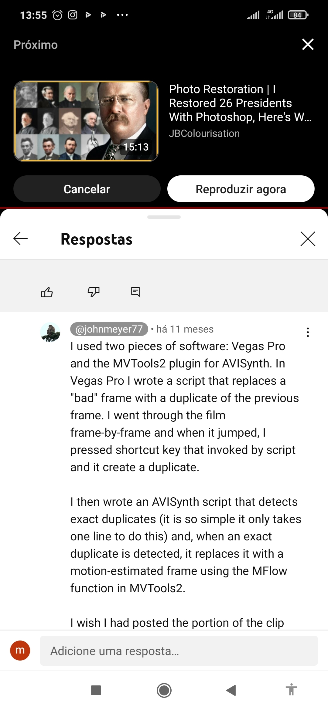

    Friend, I saw this example on YouTube that you sent, this guy used AVIsynth with MFlow in the MVtools2 function, I sent you the attached print with him explaining...
    But I don't know how to use AVIsynth, could you help me by making a tutorial with this technique he did? 🙏🏻

    Here is a link to not only the script, but the discussion which surrounded my development of the script so you can get some idea of how it works:
    Finding individual "bad" frames in video; save frame number; or repair
    If you want to use the script, I posted a better version later in that thread:
    Better Version of Script

  13. One note: my script will only work when there is a single-frame jump. Your video does have a few places where the video jumps up and stays there for 2-3 frames. My script will neither detect or repair those multiple-frame jumps.
