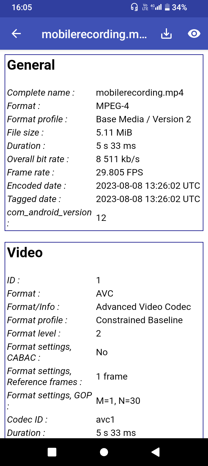

    4. video format profile and format level means? If I record video from my phone it records in
    Format profile : Constrained Baseline
    Format level : 2
    [Attachment 73066 - Click to enlarge]

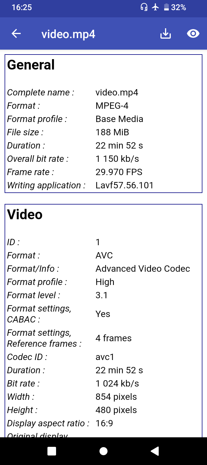

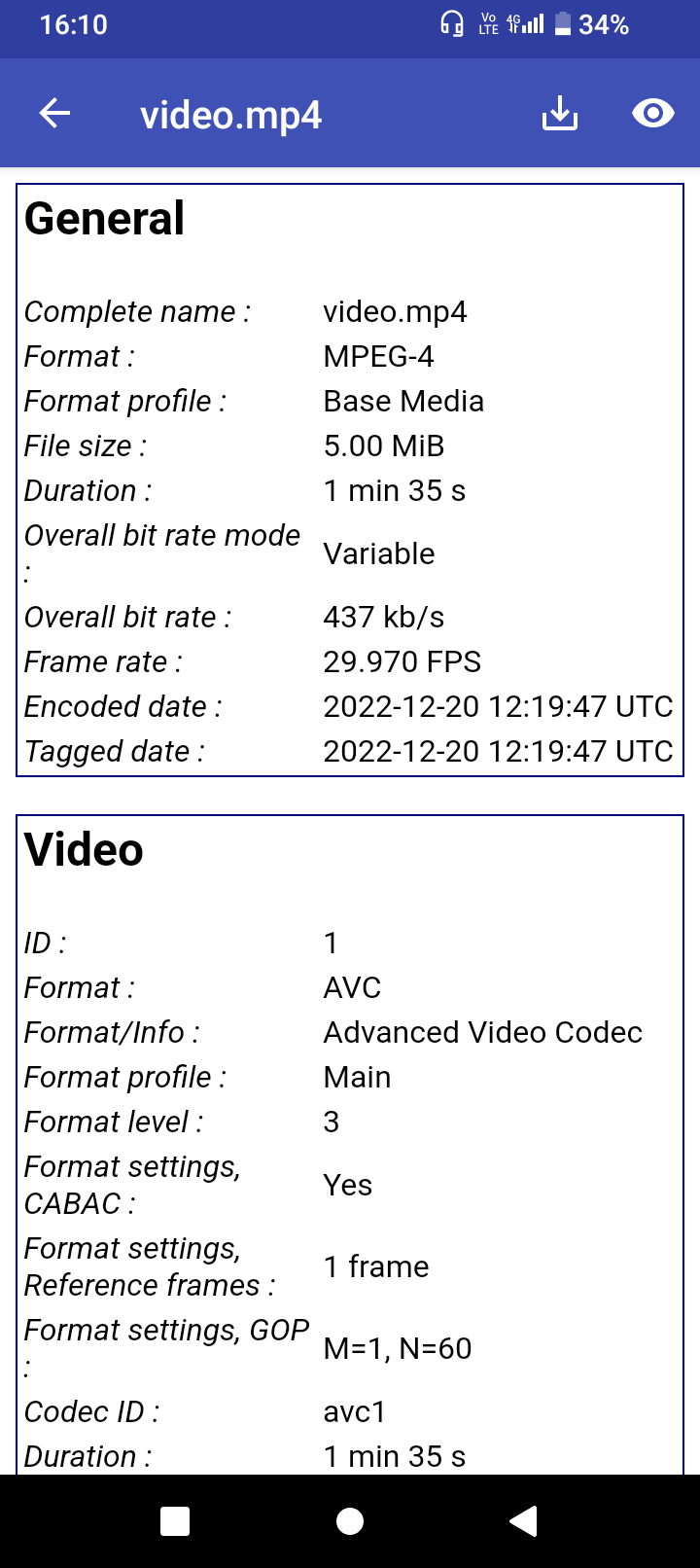

    And if I download video from any site its mostly in
    Format profile : Main
    Format level : 3
    [Attachment 73067 - Click to enlarge]

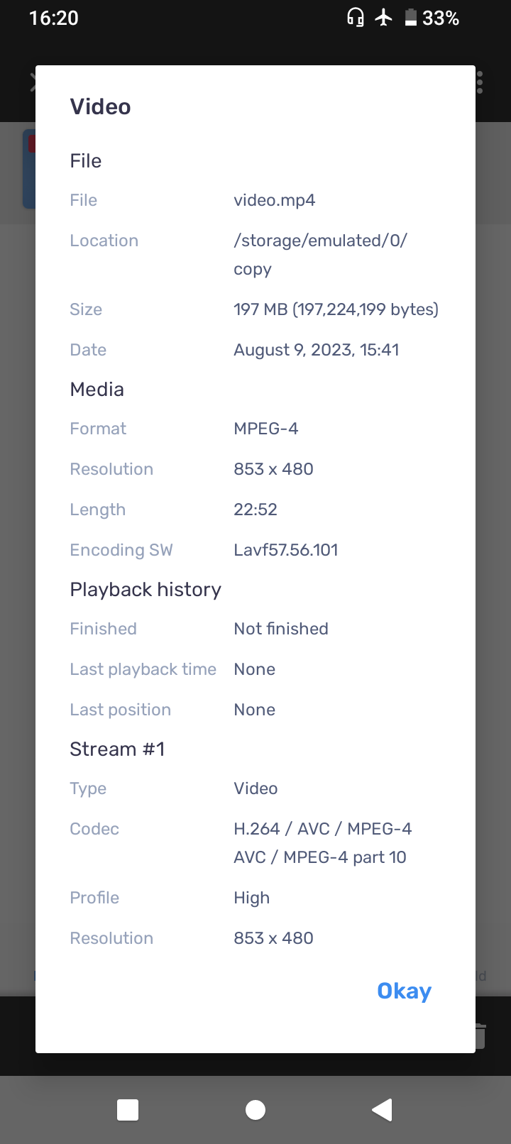

    5. What is Encoding SW : Lavf57.56.101
    Encoding SW and Lavf57.56.101 full form?
    Some videos have Lavf57.56.101 and some don't have
    [Attachment 73068 - Click to enlarge]
    in MX player it says Encoding SW
    and in mediainfo
    It says writting application

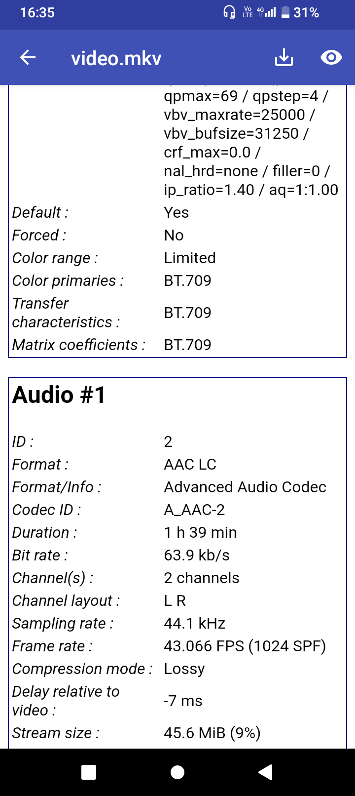

    6. Mediainfo shows some video's audio track have Delay relative to video why that happens? how to prevent that? Is it big problem while editing videos or re encoding??
    [Attachment 73070 - Click to enlarge]
    And ms full form?

    Anyone check my 6th question and explain why it shows delay minus -7ms ,while playback it doesn't looks like it has audio delay
    what causes delay?
  13. Member DB83's Avatar
    Jul 2007
    Did you not bother to read my analogy of the difference between, for example, a mp4 and a mp4 'compressed' in a data (zip/rar etc) container. Go do it yourself. Try to play that, mp4, direct from the zip/rar container. Your player will, invariably, complain that the video is not in a supported format and 'invite' you to try and play it regardless. If that zip/rar has other files in it - they often do beit a password to uncompress etc - you fail. And even if there is minimal compression and your player can not parse that compression (and I guess that none can) your 'beans' will be 'stone cold'
    The 'delay' is a natural relationship at encoding level between video and audio. That 'delay' must be echoed when you re-compress a file unless you demux both audio and video before re-compress. If you merely play the video do not fuzz your head with this.
    May 2005
    Australia-PAL Land
    what causes delay?
    That delay is equivalent to 0.2 of a frame (29.97*7/1000). Your ear-eye coordination isn't that good. You may notice a 50ms delay, and probably would notice a 100ms delay, but not 7ms, especially on a little CRT.

    Delay explaination didn't understood
    I have a movie it has -7ms delay relative to video,
    If I edit and cut some parts of movie ,exported clip audio will out of sync?
    Let's say I do lossless cut which won't do re encoding so with lossless cut exported clip will have same -7ms delay or no delay or audio out of sync?
    And if I don't use lossless cut and re encode clip while exporting then exported clip will have -7ms delay or no delay or audio out of sync?
    May 2005
    Australia-PAL Land
    I say again. You will not notice the delay. It's too small. Just ignore it and edit as you wish.

    Thinking about it some more, I'm no expert on this but I suspect that the delay value is for the player to apply, so that the audio will be in sync when you play the file. I don't think it means that there will be a 7ms delay when you play it.
  20. Originally Posted by Alwyn View Post
    Of course it's a delay for the player to apply. 7ms is negligible. You won't be able to detect it one way or another. But some A/V files may have several seconds delay (or advance). In cases like that you need to compensate for the delay when you re-encode.
  21. Originally Posted by Alwyn View Post
    Lossy audio is stored in "frames" or small chunks. When a file is split, only a whole audio chunk can be removed, which is one possible reason for a very small delay (added to compensate).
    If the source is an MKV it can't have a negative delay, even though MediaInfo reports it as negative, as MediaInfo just displays an audio delay relative to the video. In reality, the video might have a +7ms delay while the audio has none, or the video delay might be 54ms and the audio delay 47ms etc. For MKVs, you can check what's really going on by looking at the info gMKVExtractGUI displays when you open an MKV.
