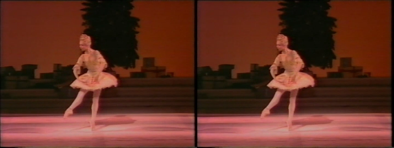

  6. Another method is to use dedup after field matching, and ignore the VFR timecodes. Just assume a constant framerate which might not be 25/1 exactly. The accuracy for a dance/ballet with constant movement like this will be very high. Use dec=false, show=true to debug the threshold value
    On that sample 1696 total frames after TFM, 1415 after dedup using a threshold of 1. (1415/1696) * (30000/1001) = 25.004477 FPS . On a longer sample it might average out to 25.000.. something, you'd have to check
    TFM and TDecimate using 1 in 6 (or some multiple of the ratio giving a longer "window" sometimes yields higher accuracy) gives 1413 frames, 2 less than dedup on that sample .
    If you use subtract(a,b) you can see where the mistakes were made from TIVTC. Same/aligned frames will look grey. There are drops between 169-170, 1164-1165 from TIVTC that dedup caught. You can go back and see the jumps in motion. I use multiple tabs in avspmod, and you can update the compare script by adding a trim and continuing on push play. Because the TIVTC drops were not near the beginning or end, it's unlikely from the way you cut the sample.
    If there are sections where there is no motion, or very low motion, you can use a dedup override. See the instructions for more details
    Example for TFM and Tdecimate using a longer window for decimation yields 24.99628fps / 1415 frames. No dropped/duplicated frames it seems ....
    LWLibavVideoSource("sample.mpg")
    TFM().Tdecimate(cycle=235,cycleR=39)
    Edit:
    There is a bad glitch at frames 323....325 which seems however to be in the source (sample.mpg) at frames 387 ...390.
    Last edited by Sharc; 9th Aug 2023 at 05:00. Reason: TDecimate adjusted, attachment accordingly
  8. There are 1414 frames using Tdecimate(cycle=235,cycleR=39) . It does not matter if you use MPEG2Source instead as the source filter. There is a drop between 1066-1067
    You can fix/ interpolate over the rolling line glitch using rife if you wanted to
