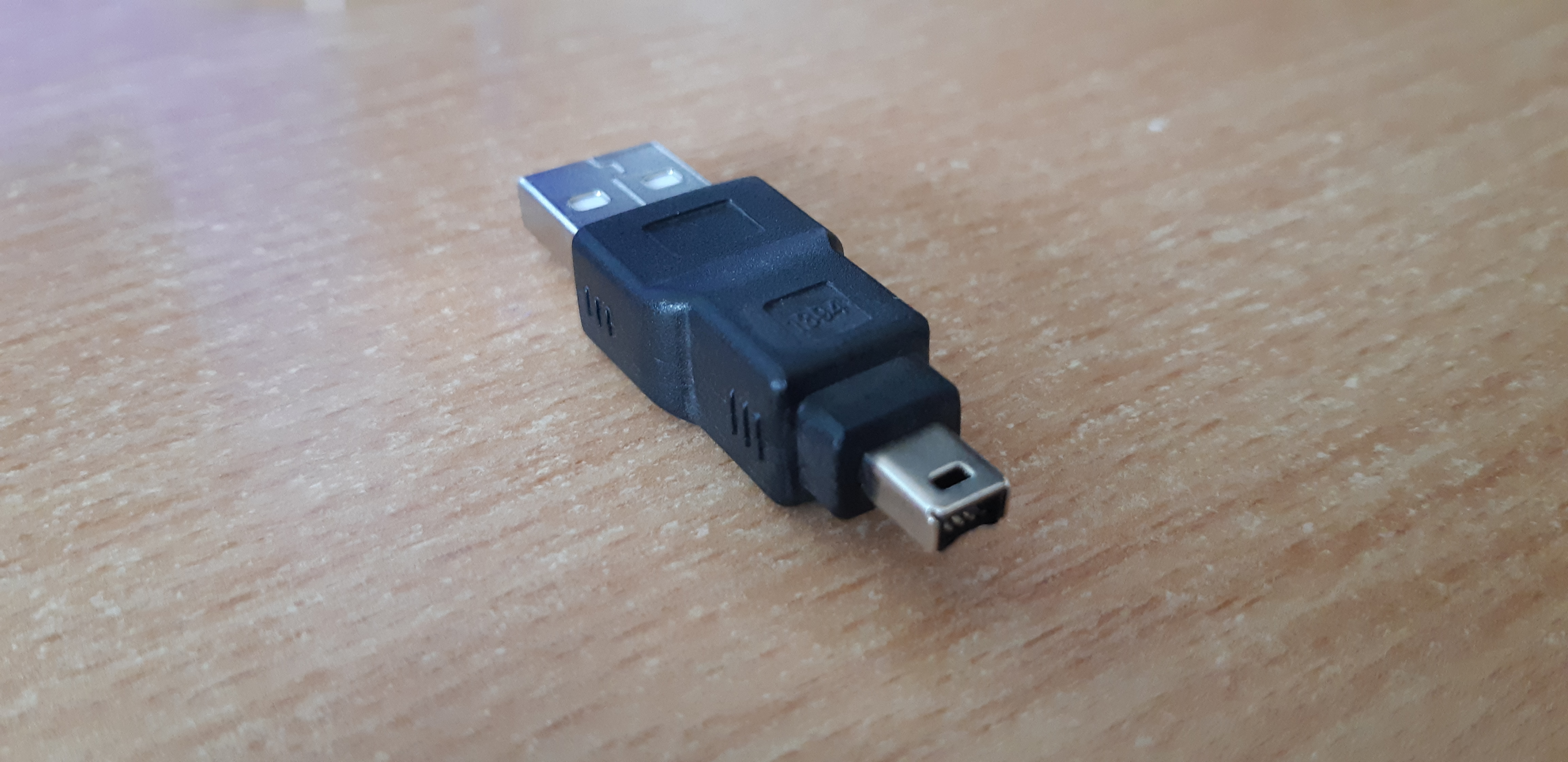

Can you post some details of your widget, a couple of pics, so we can possibly identify it. Cheap-charlie Firewire>USB cable converters are, as Lollo says, a con-job.Originally Posted by Gingeroverlord

[Attachment 73077 - Click to enlarge]
Here is a photo of the converter widget.
When connected to my PC, the device manager was displaying 'unknown usb device (device descriptor request failed)'
Now, I am unsure whether this has anything to do with the widget I'm using or that the device driver isn't installed to my PC. I have attempted to look for the driver on the JVC website but I am unsure which one to install (if any).
Anyway, I hope this is enough for you to go on at the moment.
Cheers again. -
That's a scam, There is no such firewire to USB cable adapter, The two protocols work differently. Throw it away before it does harm to your computer or camcorder, if it hasn't done so, What adds insult to injury is that some of them are not even connected internally.
