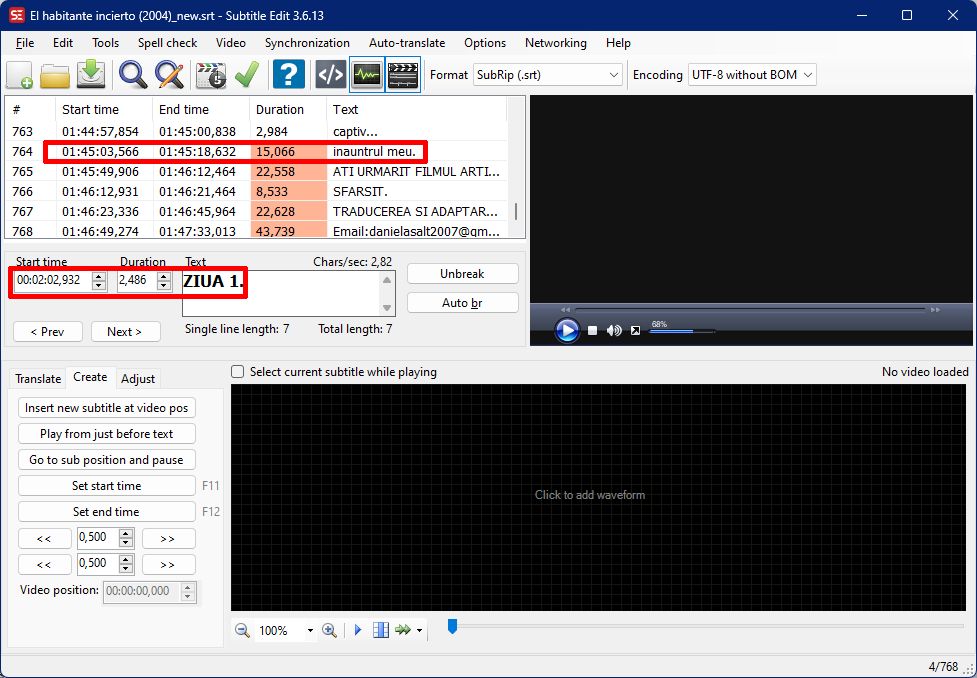

  22. Nope, we're good, difference is 0.5 seconds - last line start time and 0.511 - last line end time.
  23. Post your srt here, so I'll have a look.
  24. Here you go.
    Also sending email to Subtitle Edit developers
  25. First Sub ST = 00:00:50,905 When do you want it to start?
    Last Sub ST = 01:46:49,282 Is the start time correct?

  29. Originally Posted by queensoft View Post
    Not perfect, but gives me an ideea.
    You asked for:
    1
    00:02:02,932
    ZIUA 1.
    761
    01:45:03,566
    inauntrul meu.
    My srt has these exact times, so what do you mean by not perfect?
    [Attachment 73015 - Click to enlarge]
  30. End times, the end times have to remain exactly the same.
    Pick any random line, check end times (not start time, not duration) of both original and your processed file.
