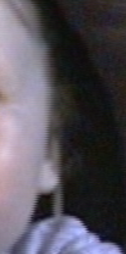

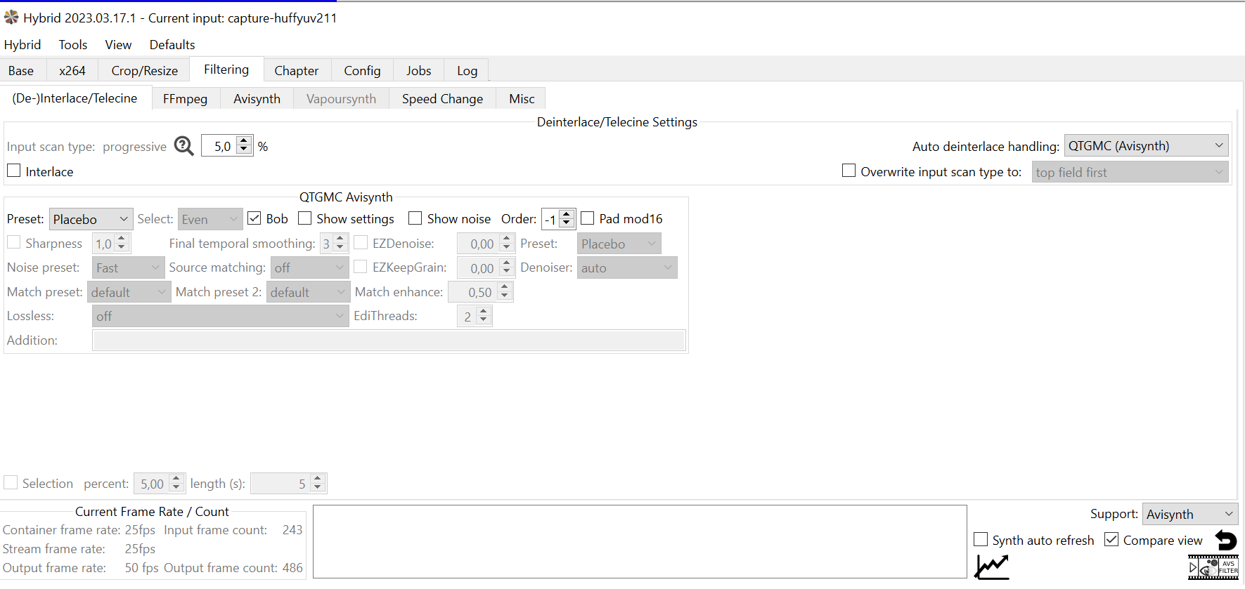

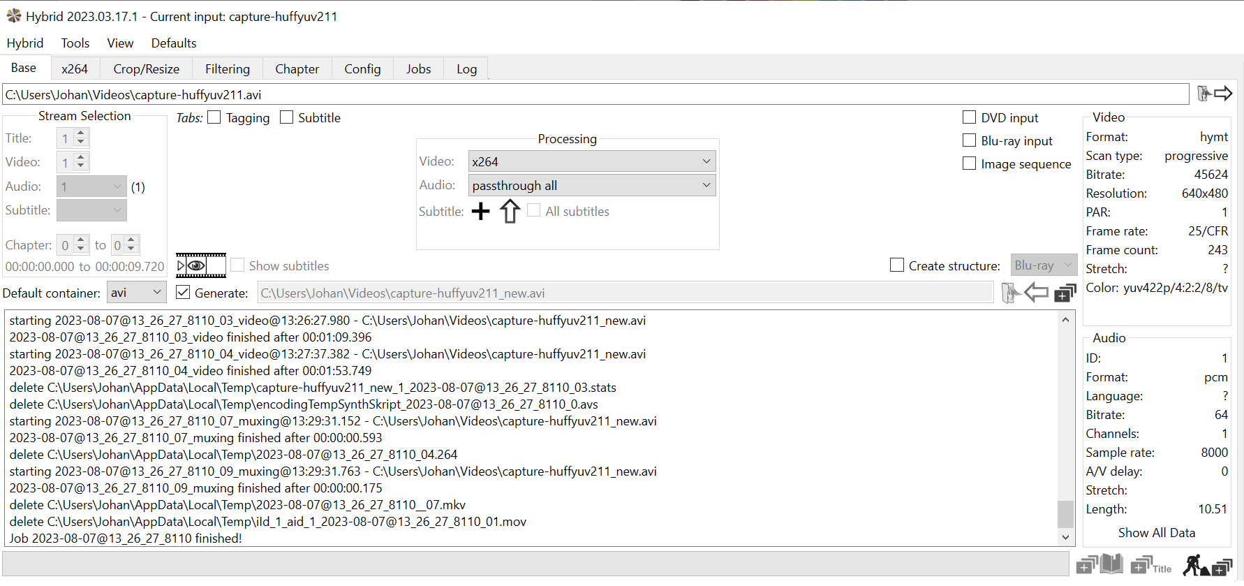

    I have tried avi files with different compressions (huffyuv, magicyuv, lagarith, utvideo) when deinterlacing with Hybrid.
    Images show the quality of the file I try to deinterlace, together with the settings in Hybrid. Attached also is the debug file.
    However, after processing the resulting output avi file is 4.43kB small, no matter what compression file I was using as input.
    Why am I not getting a full sized avi output file?

    From your screenshots I see that your source is flagged as progressive, for Hybrid to deinterlace it you need to tell Hybrid that the source is interlaced (probably tff).
    (Filtering->(De-)Interlace/Telecing->Deinterlace/Telecine Settings->Overwrite input scan type to)
    Can't say anything about the output resolution, since there is no debug output.

  3. It was a bug in Hybrids ffmpeg call when muxing H.264 into a .avi file.
    + ffmpeg can't multiplex pcm_s8 audio into an .avi container.
    Cu Selur
