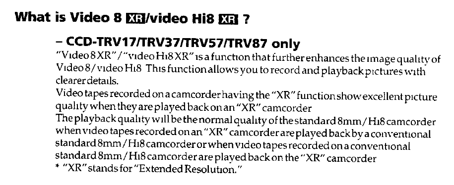

    Attached is a snippet from Sony user manual. It does not say much. Basically, XR recording played on an XR machine gives some improvement, but what sort of improvement and how it is achieved - it does not say.
    This does not seem like the usual increase of the carrier frequency and expansion or the bandwidth, because XR was offered both for Video8 and Hi8, and it is compatible with both.
    Some additional data, maybe on a PCM track or something? Like PALPlus, which had additional digital data inside an otherwise compatible analog PAL?
    Anyone has a clue?
