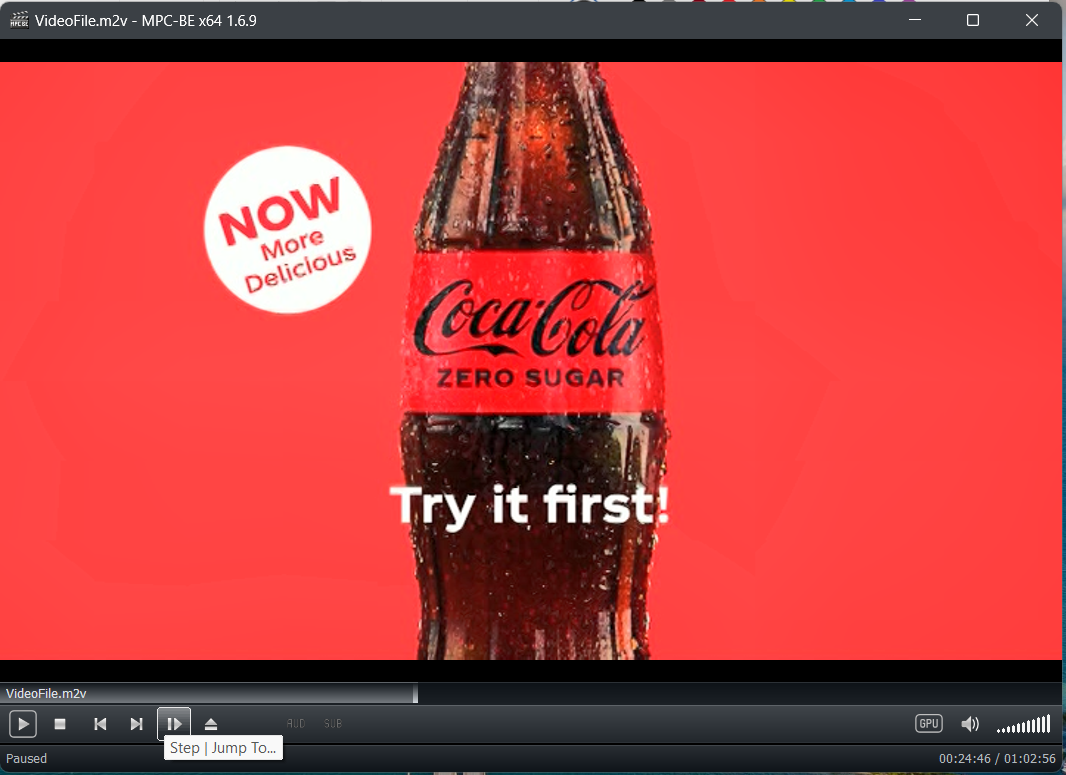

    I can help you with the first part of Scott's post. MPC-BE is one of several free software video players that has a control button that permits users to step forward frame-by-frame through their video. (MPC-BE has no equivalent control to step backward frame-by-frame.)
    Download and install MPC-BE. Open a video then pause the video. Move the cursor to the row of buttons at the bottom of the window. Click on the fifth button from the left to advance one frame. (See picture)
