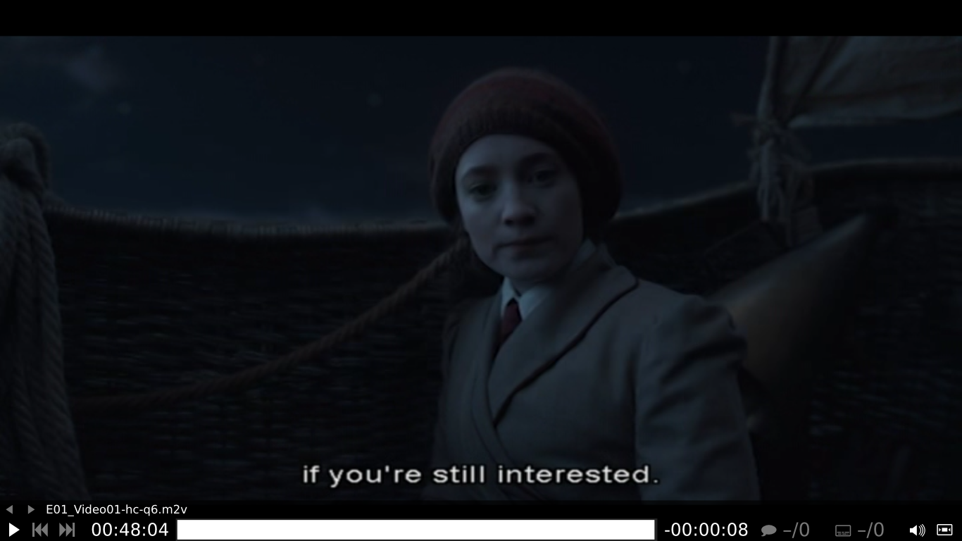

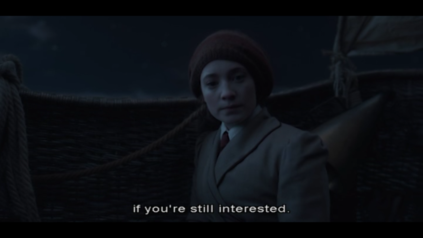

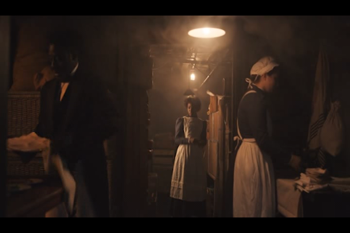

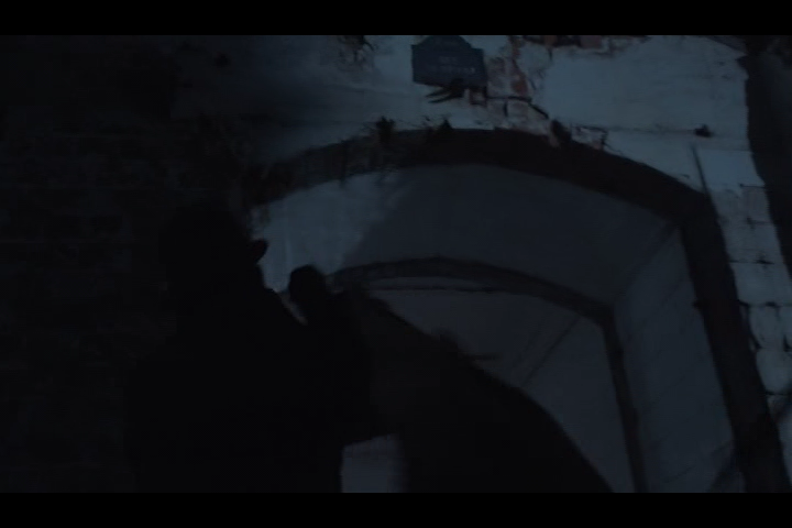

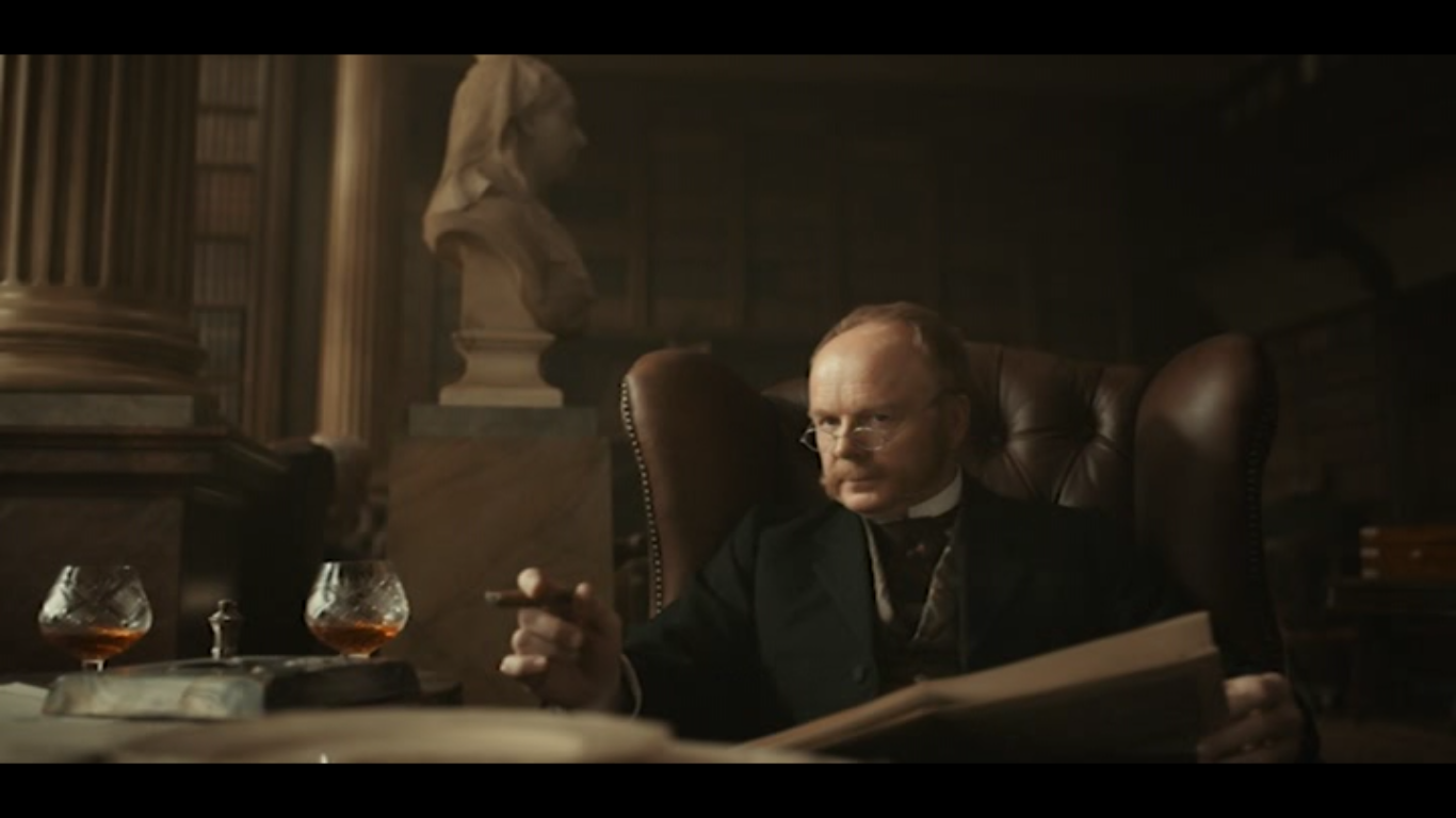

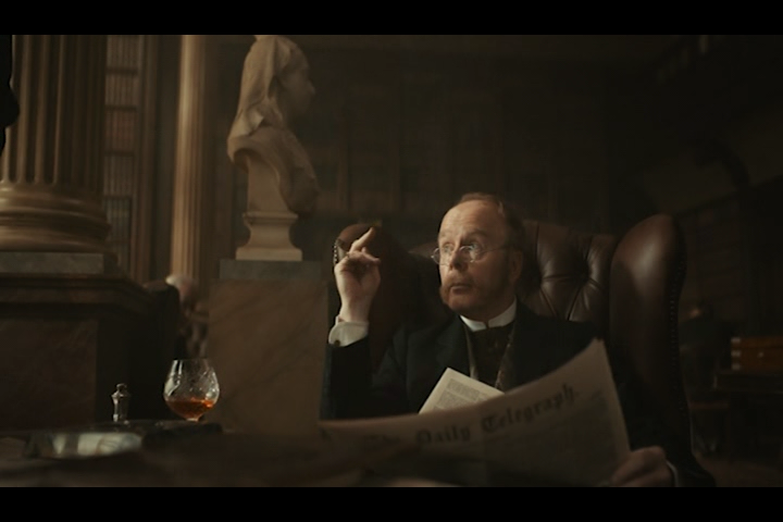

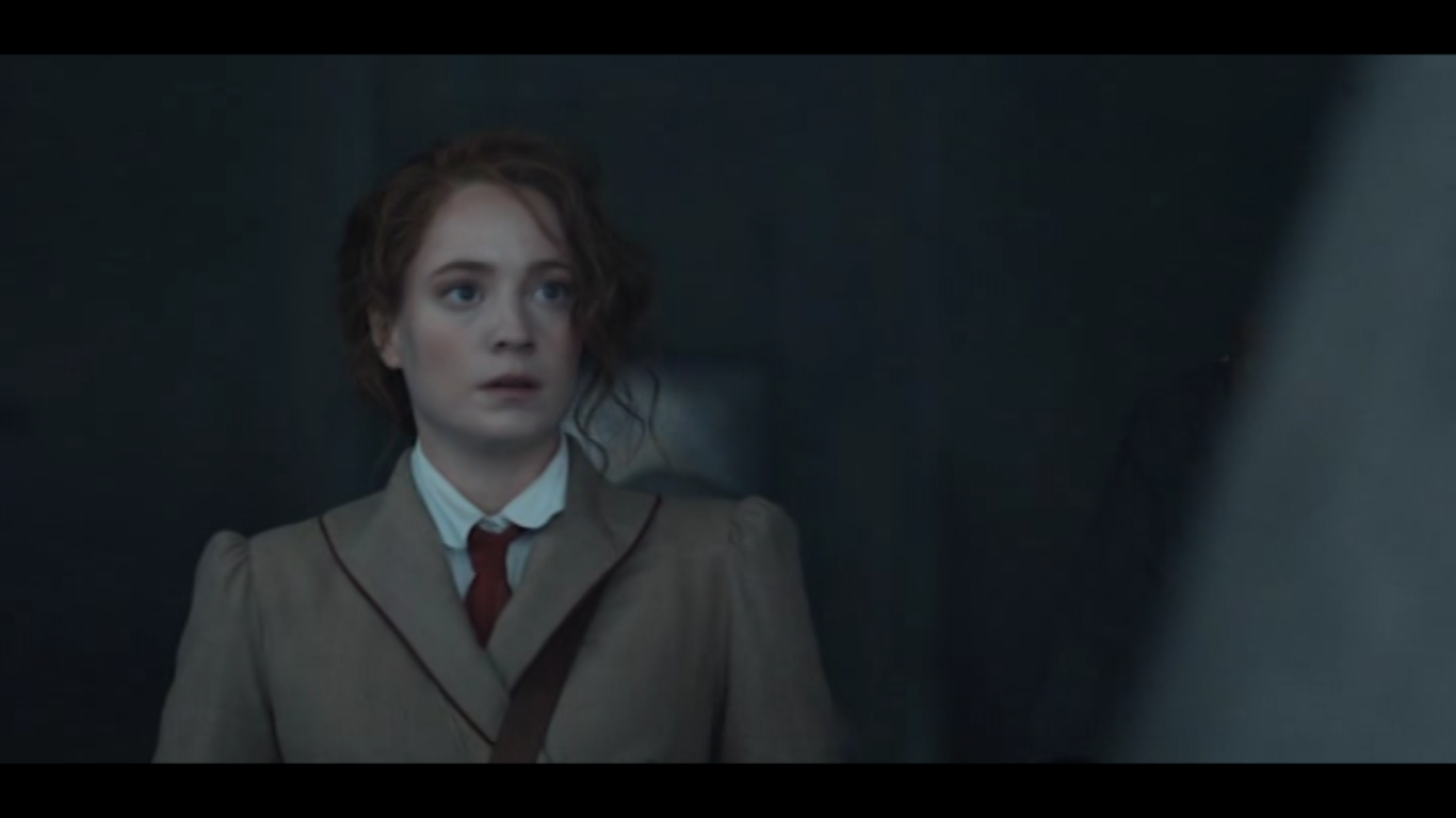

    Well after some testing I found non-linear quant and mbd rd don't play well together at higher quants in ffmpeg. Eliminated it and all is well. with the standard mpeg matrix ffmpeg's q 5 is roughly equal to HCenc Q6 size and quality wise with AQ and lumgain disabled. File size making a 2 pass based of the 1st pass Q setting HCenc: 816.4Mb, ffmpeg: 754.2Mb . Another reason I wanted this route is ffmpeg can use the first pass in CQ mode to write the log for the 2nd pass. in other encoders I gotta do a first pass to get a idea of the size then a 2nd and 3rd using that given bitrate.
    Script for ffmpeg: (I disable pass 2 then enable it after pluging in the bitate)
    ffmpeg -i /home/witzel/Desktop/video/Around_The_World_In_80_Days-Miniseries-2022/E01_Video01-raw.mkv -target ntsc-dvd -vf setfield=tff -aspect 16/9 -c:v mpeg2video -dc 10 -g 18 -maxrate 8000k -non_linear_quant true -qmax 27 -bf 2 -intra_matrix 8,16,19,22,26,27,29,34,16,16,22,24,27,29,34,37,19, 22,26,27,29,34,34,38,22,22,26,27,29,34,37,40,22,26 ,27,29,32,35,40,48,26,27,29,32,35,40,48,58,26,27,2 9,34,38,46,56,69,27,29,35,38,46,56,69,83 -inter_matrix 16,16,16,16,16,16,16,16,16,16,16,16,16,16,16,16,16 ,16,16,16,16,16,16,16,16,16,16,16,16,16,16,16,16,1 6,16,16,16,16,16,16,16,16,16,16,16,16,16,16,16,16, 16,16,16,16,16,16,16,16,16,16,16,16,16,16 -flags +ilme+ildct -alternate_scan 1 -top 1 -passlogfile /home/witzel/Desktop/video/Around_The_World_In_80_Days-Miniseries-2022/E01_Video01-raw.passlog -threads 1 -q:v 5 -pass 1 /home/witzel/Desktop/video/Around_The_World_In_80_Days-Miniseries-2022/E01_Video01-raw-pass1.m2v
    #ffmpeg -i /home/witzel/Desktop/video/Around_The_World_In_80_Days-Miniseries-2022/E01_Video01-raw.mkv -target ntsc-dvd -vf setfield=tff -aspect 16/9 -c:v mpeg2video -dc 10 -g 18 -maxrate 8000k -non_linear_quant true -qmax 27 -bf 2 -intra_matrix 8,16,19,22,26,27,29,34,16,16,22,24,27,29,34,37,19, 22,26,27,29,34,34,38,22,22,26,27,29,34,37,40,22,26 ,27,29,32,35,40,48,26,27,29,32,35,40,48,58,26,27,2 9,34,38,46,56,69,27,29,35,38,46,56,69,83 -inter_matrix 16,16,16,16,16,16,16,16,16,16,16,16,16,16,16,16,16 ,16,16,16,16,16,16,16,16,16,16,16,16,16,16,16,16,1 6,16,16,16,16,16,16,16,16,16,16,16,16,16,16,16,16, 16,16,16,16,16,16,16,16,16,16,16,16,16,16 -flags +ilme+ildct -alternate_scan 1 -top 1 -passlogfile /home/witzel/Desktop/video/Around_The_World_In_80_Days-Miniseries-2022/E01_Video01-raw.passlog -threads 1 -b:v 2053k -pass 2 /home/witzel/Desktop/video/Around_The_World_In_80_Days-Miniseries-2022/E01_Video01-raw.m2v
    HCenc settings:
    *INFILE z:\home\w\desktop\video\around_the_world_in_80_day s-miniseries-2022\e01_video01.avs
    *OUTFILE Z:\home\w\Desktop\video\Around_The_World_In_80_Day s-Miniseries-2022\E01_Video01-hc-q6.m2v
    *BITRATE 2297
    *MAXBITRATE 8000
    *FRAMES 0 89462
    *PROFILE best
    *AUTOGOP 18
    *AQ 0
    *DC_PREC 10
    *INTERLACED
    *TFF
    *CHROMADOWNSAMPLE 1
    *LOSSLESS
    *INTRAVLC 2
    *MATRIX mpegstd
    *PRIORITY normal
    I'm sure there's plenty of room for improvement. my main goal was simply a mostly linux solution (I use avisynth and wine to make a raw source file first) that scales from backup quality to master quality by simply changing the Q setting in the first pass. I feel I have done this. Attached are some very non scientific captures showing the results. Thanks everyone for the help.

    ffmpeg -i /home/witzel/Desktop/video/Around_The_World_In_80_Days-Miniseries-2022/E01_Video01-raw.mkv -target ntsc-dvd -vf setfield=tff -aspect 16/9 -c:v mpeg2video -dc 10 -g 18 -lmin 0.75 -mblmin 50 -non_linear_quant true -qmax 27 -bf 2 -intra_matrix 8,16,19,22,26,27,29,34,16,16,22,24,27,29,34,37,19, 22,26,27,29,34,34,38,22,22,26,27,29,34,37,40,22,26 ,27,29,32,35,40,48,26,27,29,32,35,40,48,58,26,27,2 9,34,38,46,56,69,27,29,35,38,46,56,69,83 -inter_matrix 16,16,16,16,16,16,16,16,16,16,16,16,16,16,16,16,16 ,16,16,16,16,16,16,16,16,16,16,16,16,16,16,16,16,1 6,16,16,16,16,16,16,16,16,16,16,16,16,16,16,16,16, 16,16,16,16,16,16,16,16,16,16,16,16,16,16 -flags +ilme+ildct -alternate_scan 1 -top 1 -passlogfile /home/witzel/Desktop/video/Around_The_World_In_80_Days-Miniseries-2022/E01_Video01-raw.passlog -threads 1 -q:v 5 -pass 1 /home/witzel/Desktop/video/Around_The_World_In_80_Days-Miniseries-2022/E01_Video01-raw-pass1-lmin.m2v
    #ffmpeg -i /home/witzel/Desktop/video/Around_The_World_In_80_Days-Miniseries-2022/E01_Video01-raw.mkv -target ntsc-dvd -vf setfield=tff -aspect 16/9 -c:v mpeg2video -dc 10 -g 18 -lmin 0.75 -mblmin 50 -non_linear_quant true -qmax 27 -bf 2 -intra_matrix 8,16,19,22,26,27,29,34,16,16,22,24,27,29,34,37,19, 22,26,27,29,34,34,38,22,22,26,27,29,34,37,40,22,26 ,27,29,32,35,40,48,26,27,29,32,35,40,48,58,26,27,2 9,34,38,46,56,69,27,29,35,38,46,56,69,83 -inter_matrix 16,16,16,16,16,16,16,16,16,16,16,16,16,16,16,16,16 ,16,16,16,16,16,16,16,16,16,16,16,16,16,16,16,16,1 6,16,16,16,16,16,16,16,16,16,16,16,16,16,16,16,16, 16,16,16,16,16,16,16,16,16,16,16,16,16,16 -flags +ilme+ildct -alternate_scan 1 -top 1 -passlogfile /home/witzel/Desktop/video/Around_The_World_In_80_Days-Miniseries-2022/E01_Video01-raw.passlog -threads 1 -b:v 2053k -pass 2 /home/witzel/Desktop/video/Around_The_World_In_80_Days-Miniseries-2022/E01_Video01-raw-lmin.m2v
    final sizes:
    ffmpeg q5: 754Mb (2120Kb)
    ffmpeg q5-mbl: 754Mb (2120Kb)
    Hcenc Q6: 816Mb (2294Kb)
    considering its 720x480 29.97i I say not too shabby quality wise vs the bitrates used.
    For "mastering" I set Q to 3 in pass 1. If it's too big for a disc I adjust the bitrate in pass 2. If not I run pass 2 with the given rate to distribute the bits. for "backup" Q 5 works for me and I run pass 2 with the result from pass 1 using the script in my prior post.
    By no means do you have to promise the last one lol. Been trying this for years and I'm learning what i did for linear is not needed (I.E custom FOX matrix) with non-linear as most of it was to push stuff up the qscale where each Q didn't eat 50% of the bitrate then 25% etc. Hence my original question of why aint non-linear the default?
