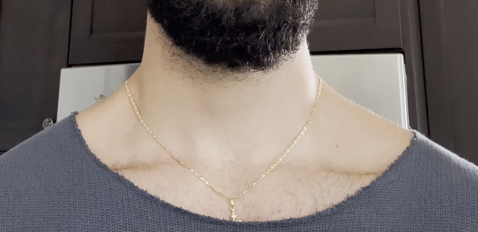

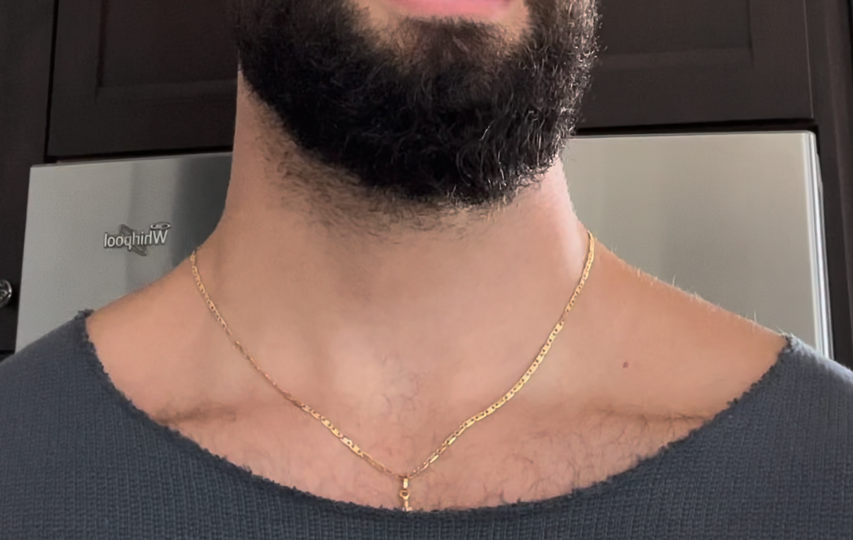

  1. i want to use ffmpeg to convert a video which with yuv420p10le(bt2020) to yuv420p(bt709), but the encoded video's color isn't correct compare to the original video
    [Attachment 72889 - Click to enlarge]
    this is the original video
    [Attachment 72890 - Click to enlarge]
    this is the encoded video
    my command is add -pix_fmt:v yuv420p -colorspace:v 'bt709' -color_primaries:v 'bt709' -color_trc:v 'bt709' -color_range:v 'tv' flags to ffmpeg.
    so how can i do with ffmpeg can do this conversion?
