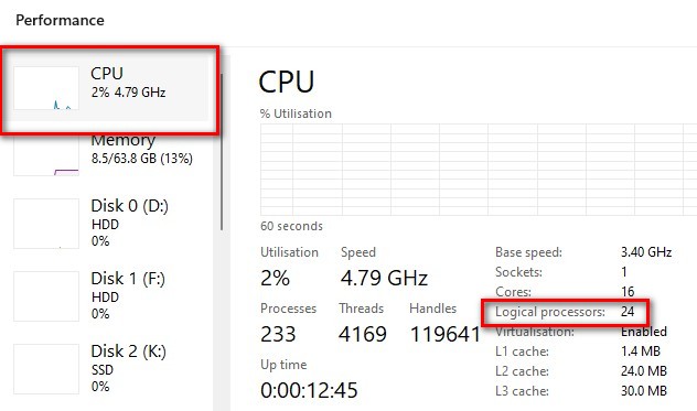

    Add Prefetch to the very end of your script in this format:
    Prefetch(x)
    where X is the number of logical processors in your CPU -1 or 2.
    “The Prefetch number should be set to 1 or 2 less than the number of "logical processors" in your system. To check what that is, go to Task Manager in Windows, select the Performance tab, then click on the CPU item. You'll see down below in the window an entry for the number of logical processors in your system. For some people, it will be the same as the number of physical cores, for others it might be double that if your CPU supports Hyperthreading. In my case, I have 12 logical processors, so I set Prefetch to 10.”

    Number of Logical Processors:
    [Attachment 72864 - Click to enlarge]
