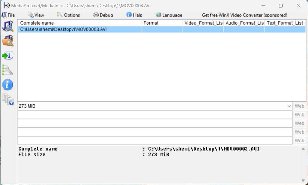

    Jul 2023
    Wont open anywhere
Name:	Screenshot 2023-07-30 162505.png

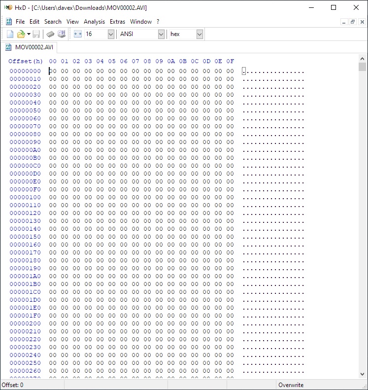

    One of the files
    Mar 2008
    Unfortunately the file doesn't contain any useful data, the whole thing is binary zeroes
